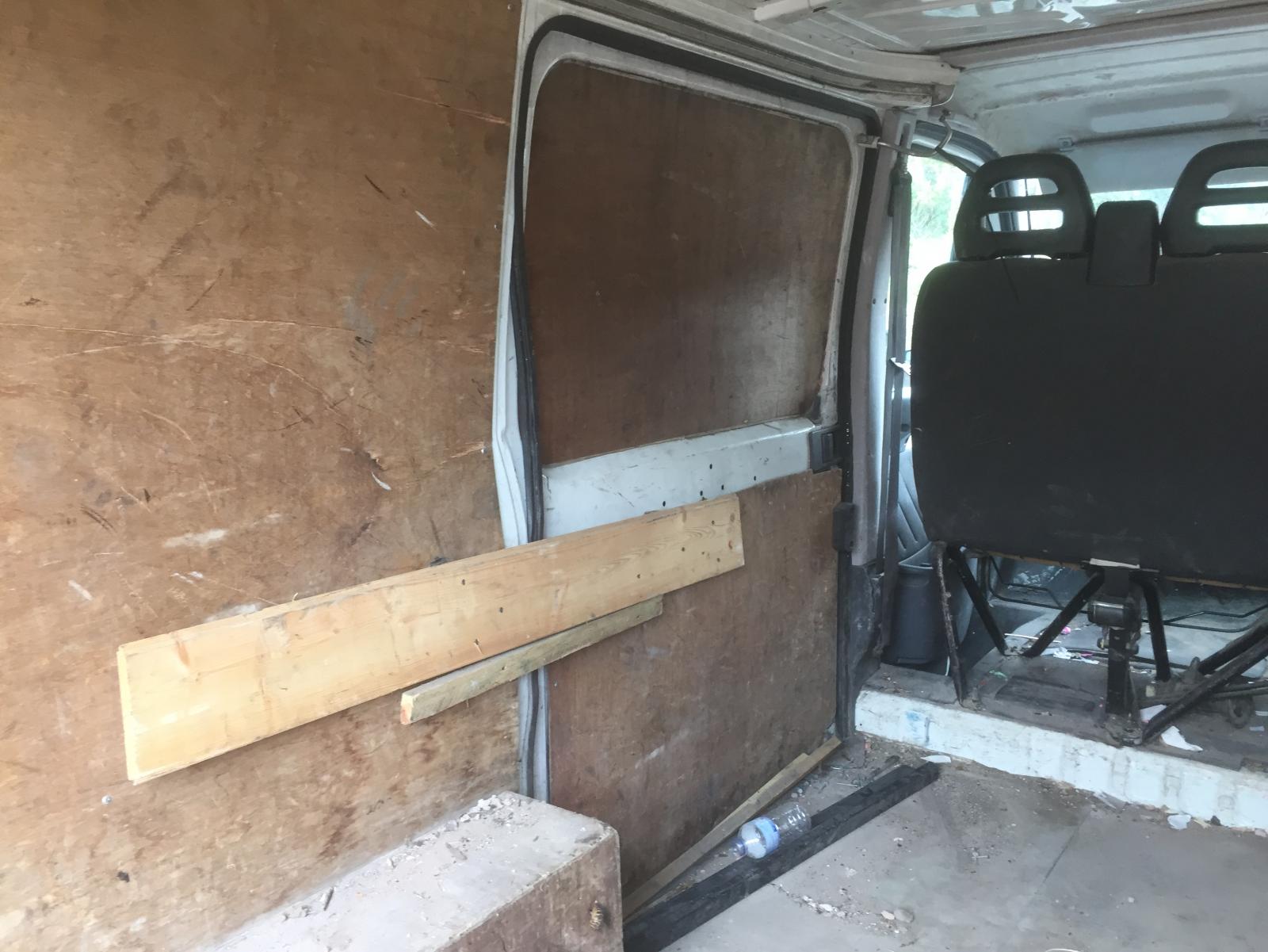

Note the high security side loading door anti-falling off device...
...but the van has gone now anyhow. Later, how to carefully* cut the floor pan on a Focus to replace the fuel pump.

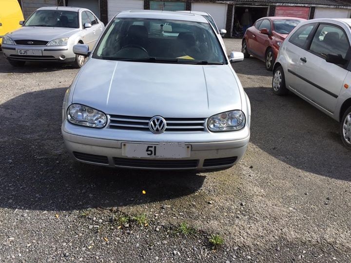

Straight to scrap, 1.6 petrol.
The badge on the front I expect
Either that or the lack of pineapples, home-made rusty bits and a roofrack. This meant the previous owner was thus 'uncool' and got rid at the earliest opportunity.
Why was it scrapped?
I got it cheap because it had no MOT. I seriously doubt it's worth the effort (1.6 petrol) of even trying to bother testing it, plus I haven't the room/time/money. Plus it saves it from having some spoon fit 18" alloy wheels to it and drive round at 3.00am on cut springs.
But mostly because it's a Golf.
