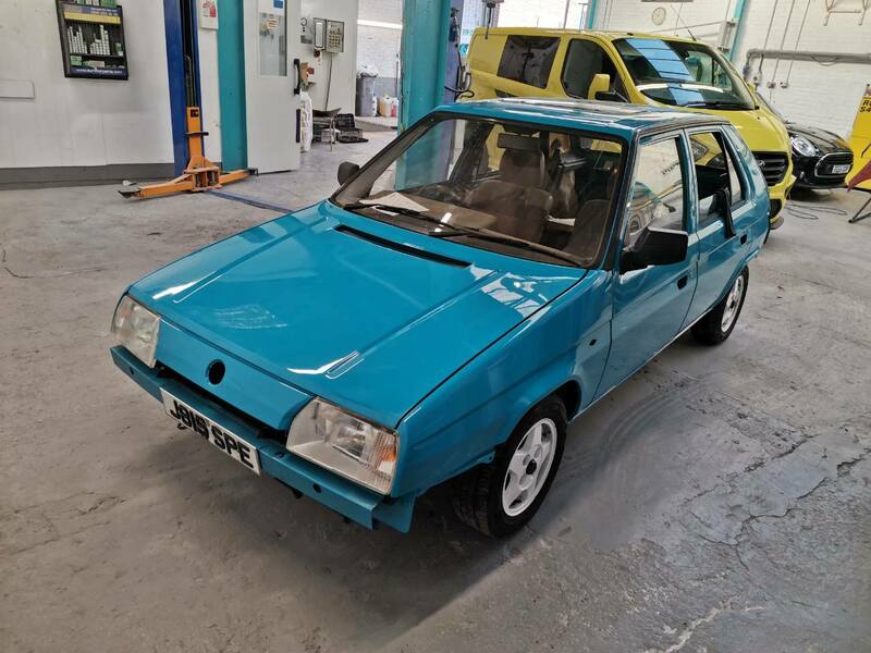

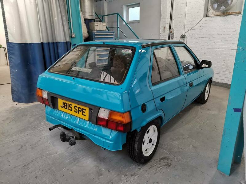

Felly Fav and Trum. **New Carpets**

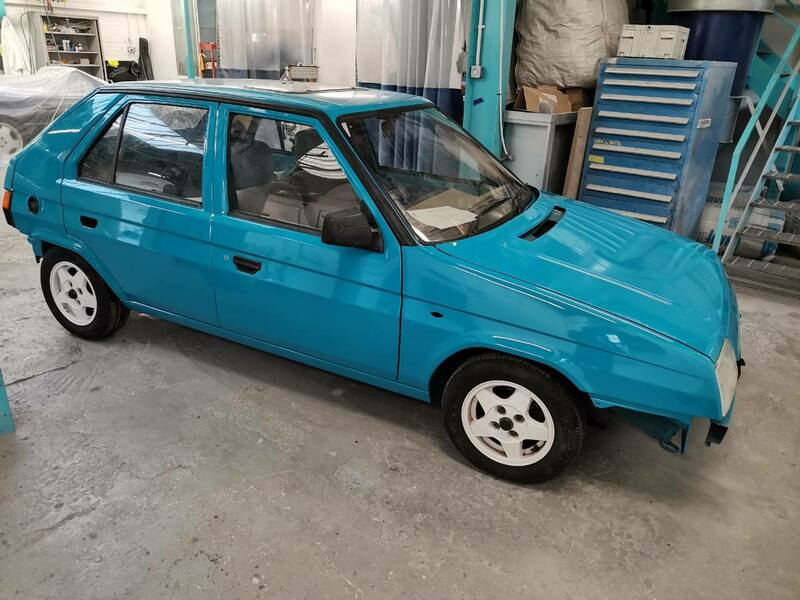

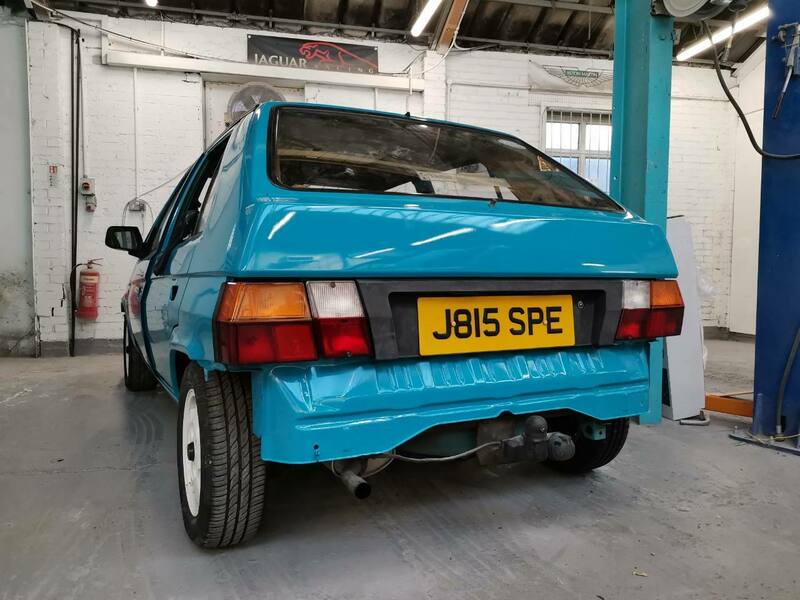

Popped in this morning and they surprised me again with the amount of work they've done in two and half a days.
Shiny shiny.

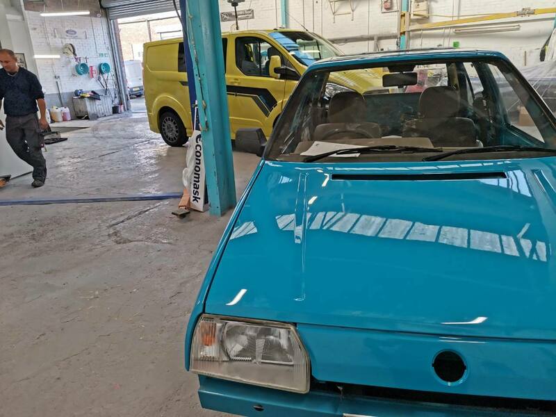

But not shiny enough apparently, they still have to mop and polish it. I asked if it was lacquered because it obviously wasn't before. Being a straight colour it doesn't have to be and it was obvious with how quickly the shine would wear off that it wasn't. So apparently it's had two top coats then two more of laquer with the colour mixed in to give a glossier finish.

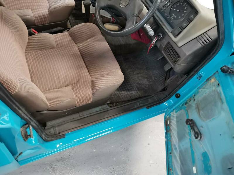

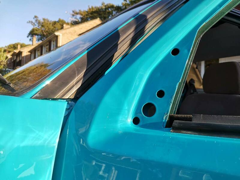

Door shuts done this time. The last respray was a bit brighter than the original and it showed in the door shuts and engine bay. They've matched it to the brighter colour but with the door shuts done that no longer matters, I preferred that anyway, it's a great colour.

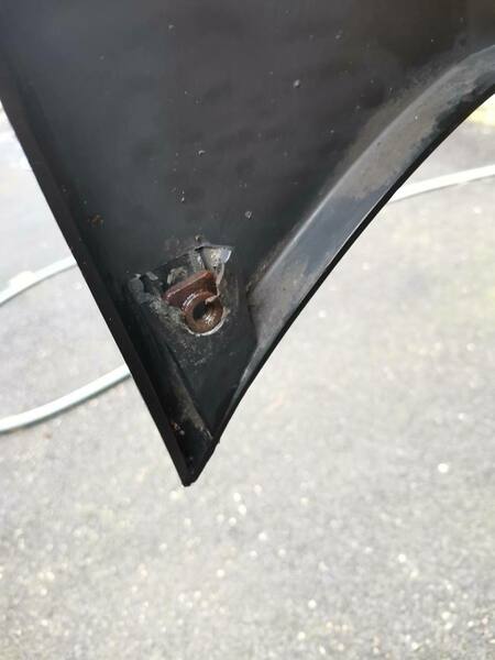

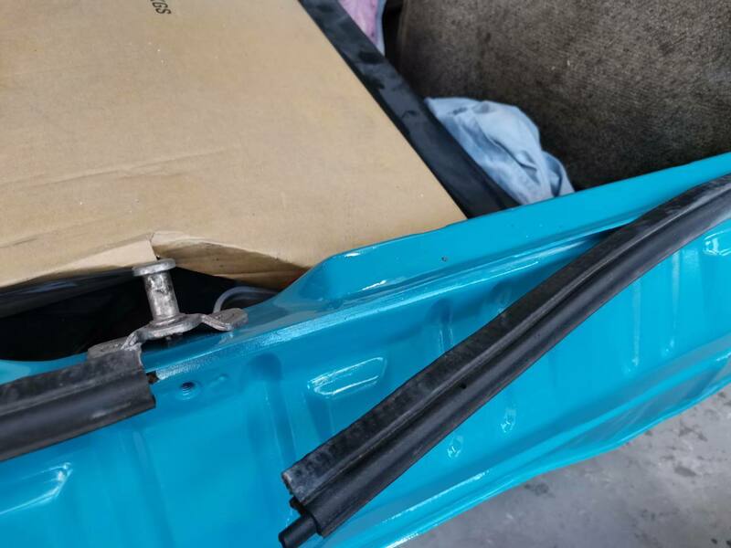

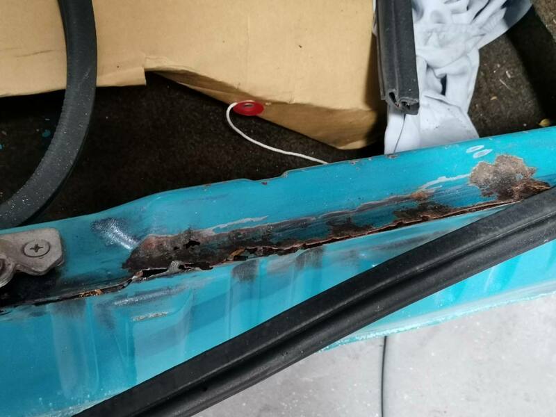

This is the lip that the tailgate seal sits over. This is what it looked like on Wednesday.
I'd ground it back and covered it with Dinitrol rust converter and was going to plug the holes with Supersteel or the like and prime it before dropping the car off but it kept raining the week before so this was as far as I got. Most of it sits under the seal or behind the bumper so I wasn't that fussed.
But now it looks like this.
It looks like new! There's two bits of metal there spot welded to form the seam and then welded in either side. I can't see the joins at all. Only time will tell if it really is done properly, and even then only if I take the bumper off. I'm really pleased with that, well worth the extra £150.

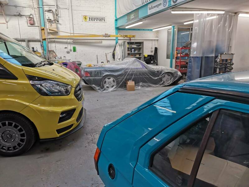

More shiny shots.
Nice colour contrast and Merc in the background.
The Transit wasn't a customer job but a little sideline of their's. I had noticed quite a lot of vans about the place. So they pick them up at auction and do them up as there is a good market for fancy vans.
This was originally a silver panel van. They've fitted the body kit and side windows. The seats were fancy leather affairs with diamond stitches patterns and RS logos. A second row was fitted also in the same style. The rest of the van was lined in carpet ready for the next owner to do what they want with although he says they'd do more if  someone wants it. Like make room for a motorbike with the proper ramp and fixings was the example he gave.
I personally wouldn't want to drive around in this but I was impressed with the quality of the work, there was no sign of any silver paint and the carpet lining looked spot on. If I ever get a Sherpa I know where to take it.

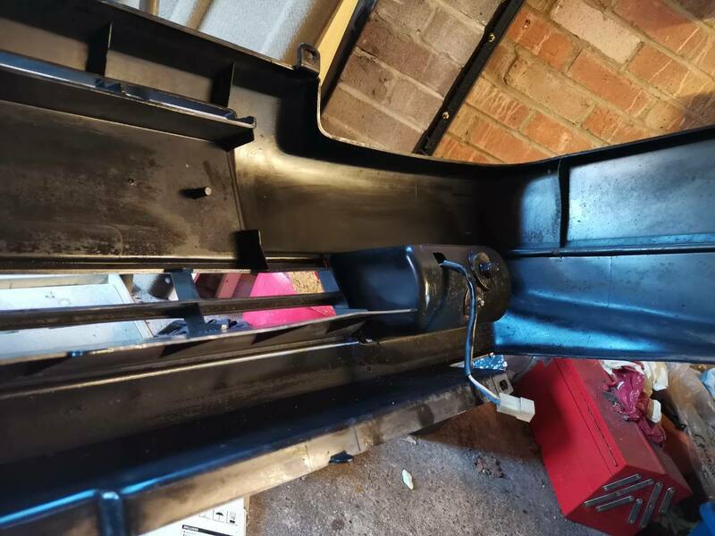

Cleaned up the front fog lights and refitted them today.
They're an easy fit, a single nut and curved metal plate that holds the shape of the housing and poke the wires through the hole.

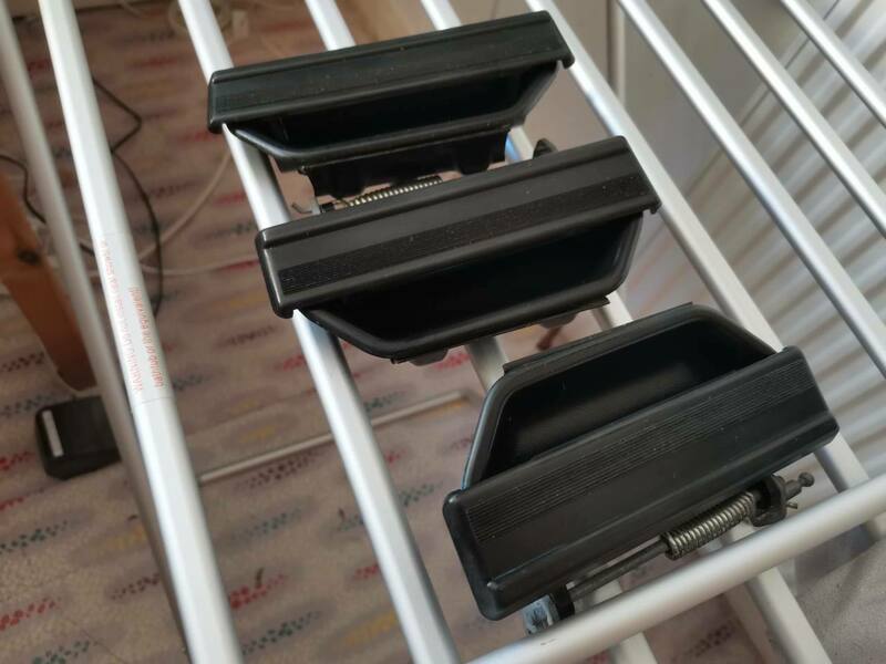

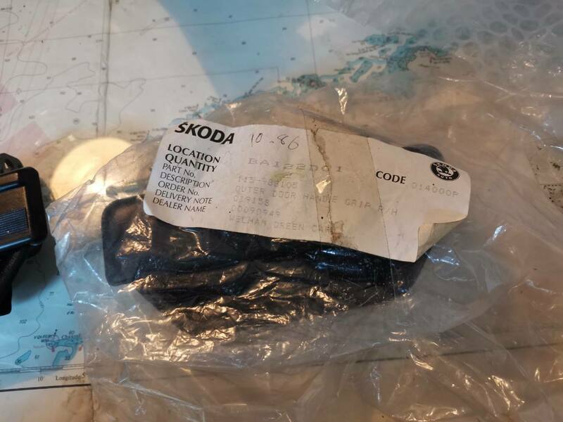

Had a message from the seller of one of the new door handles I ordered saying he couldn't find it, so he's refunded me. This means I've only got one new one coming so I decided I'd have to clean the overspray off the old ones. They've turned out alright but I'll still get new ones if I can.

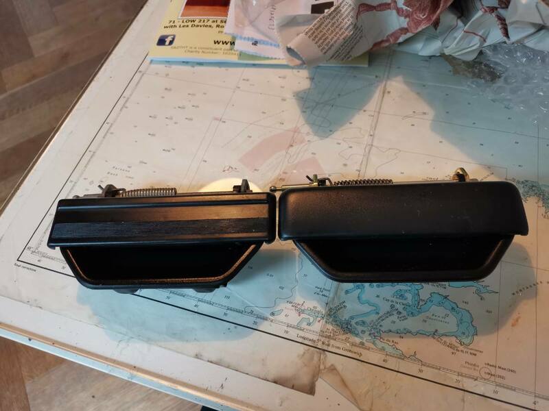

The replacement door handle saga is going well*. The first one the seller couldn't find, the second one arrived today...
... but it was a mk2 one. See difference below.
MK1 has the squarer handle with embossed lines, the mk2 is plain and rounder.
I double checked the listing and it was definitely for a mk1 so I messaged the seller and he replied within ten minutes, apologised and said he would go and check the warehouse to see if the other one was still there. Replied again less than an hour later, said he'd found it, would post it today and that I could keep the other one to do with as I please which is fine as the mechanism is the same so it might come in handy or I could pass it on to another Favorit owner. So thanks to jjlclassics, excellent service.
To be fair most people don't even know there is a mk1 and a mk2 let alone what the differences are so it's an easy mistake to make.

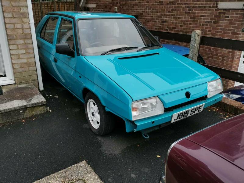

It's finally back home
But I've a fair bit of work to do before I can use it properly. And it always takes longer to put things back together than take them apart.
Only had a little time after work before it got dark but I got the door seals in meaning I could remove the old socks that were keeping the windows from rattling in their frames. And the door handles.
Meaning the car is now watertight apart from the screw holes in the tailgate for the spoiler.

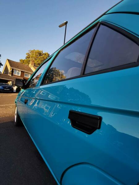

And I took this one simply because you'll never see this bit of paint again now the mirrors have gone back on.

I am, especially as they did more than they said they were going to. The door shuts weren't originally going to be done but he said the doors come off so easily they decided to take them off to work on them so they decided to do the door shuts as well. That's the good thing with having such a basic car. There are no wires in the doors at all. The rear doors come off with four bolts, two on each hinge and the fronts you just tap the roll pin out of the middle of the hinge.

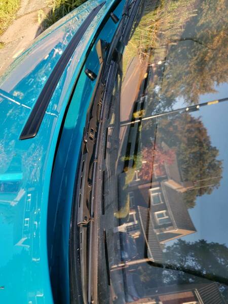

They also did the scuttle panel betwixt bonnet and windscreen which looks nice.
I need to keep it clean under there now.

Are those door handles the same as Estelle ones?  They're very similar unless my memory is failing me.
Spot on. The mk2 handles are interchangeable but have lost all the character. I assume VW were trying to squeeze some of the individuality out of it and make it more like other cars. That's pure speculation of course and has no basis in fact, I just like to take every opportunity I can to have a dig at VW.

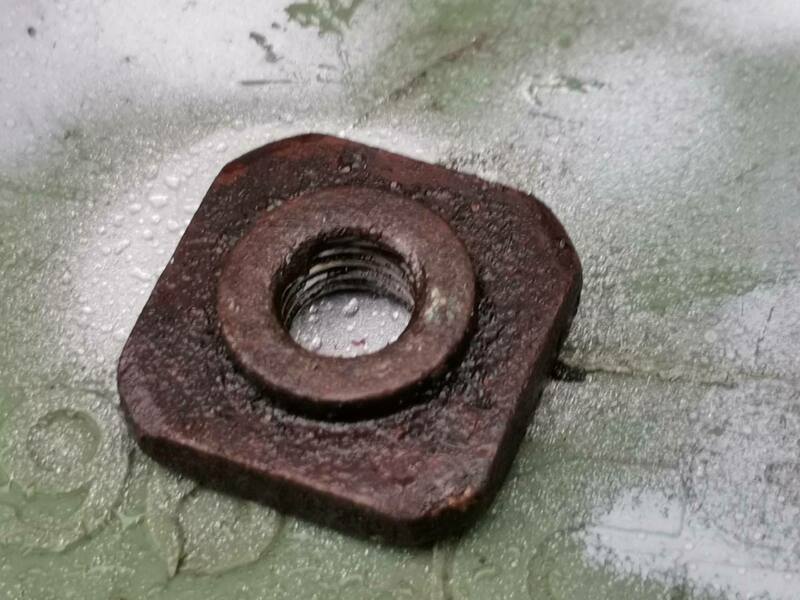

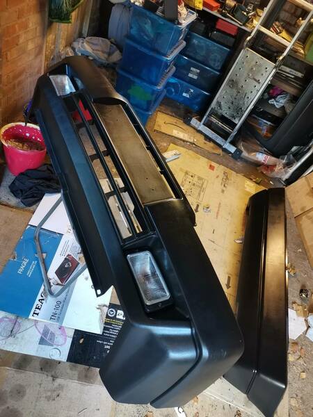

A quiet day today as it rained most of the afternoon but I did go and get these back.
They sit in a little recess in each corner of the bumpers.
Like so.
But when trying to undo them three of them just went round and round so I had to cut the bolt heads off. I took them round my friend's house to have the remaining stumps drilled out. He has a knack for drilling straight that I don't possess. So I went back and collected them today so not entirely unproductive.

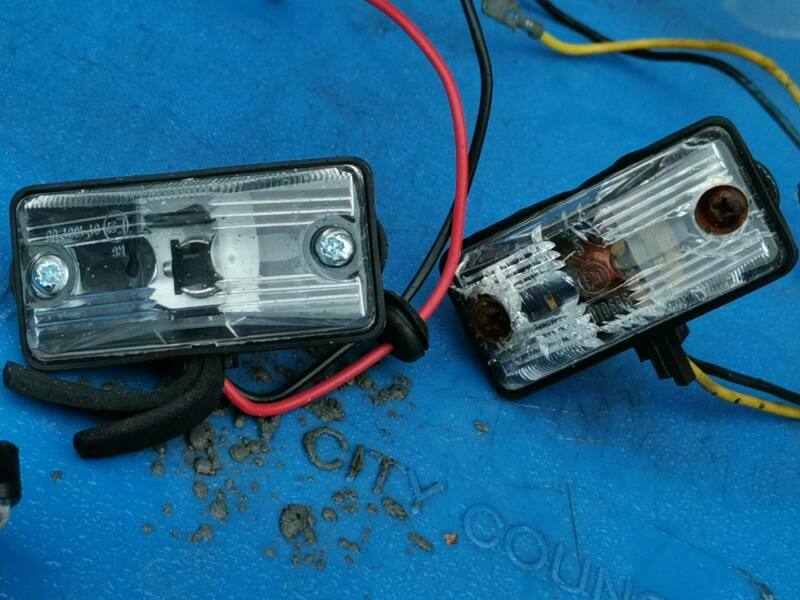

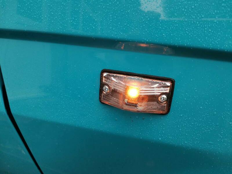

I found these side repeaters on ebay
New one on the left. They are reproduction, probably Chinese. They are shared with Estelles but even so I'm surprised there is enough of a market for repros. They were available in clear, orange or smoked so I went with the clear I already have. You have to put your own spades on the ends of the wires so I've used the original units and just used the new lens, rubber backing and shiny screws.
The wires go through this hole in the inner wing and plug in here.

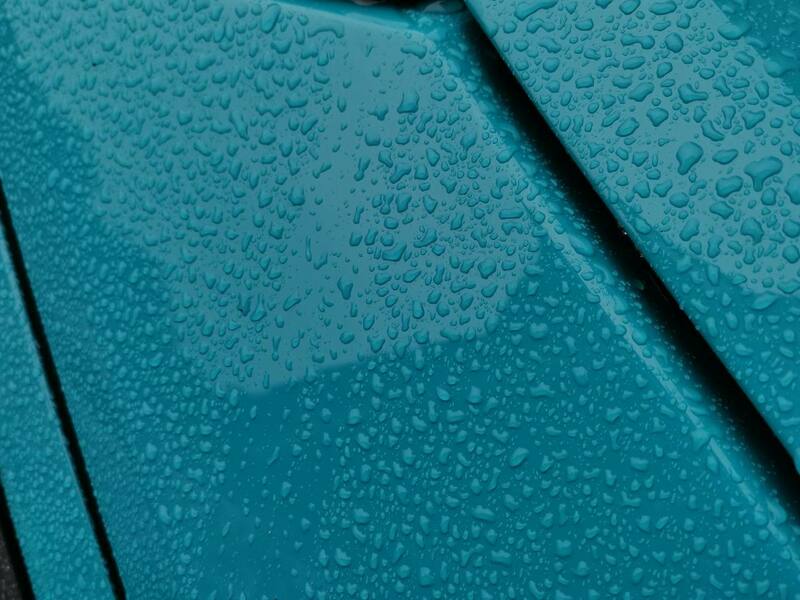

There is a rubber grommet attached to the wires to plug the hole but it was getting quite wet by then and I need to get up under the wheel arch to squeeze it in so that can wait for a dry day.
It beads up well now. As you would expect of course.
