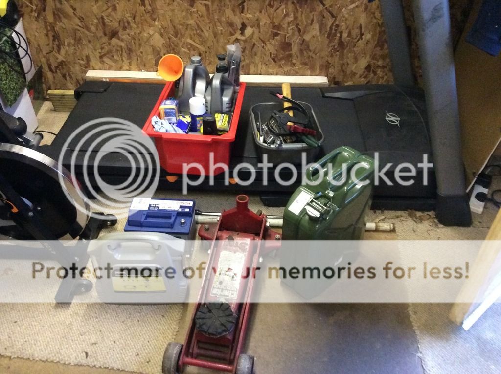

Collection day tomorrow!
I've got all the basics together ready to load up tomorrow morning. I shouldn't need too much since I'm cheating and having the car transported but Ive still got to get it moving on it's own to load and unload.
There shouldn't be any issues really as the car is a runner.
