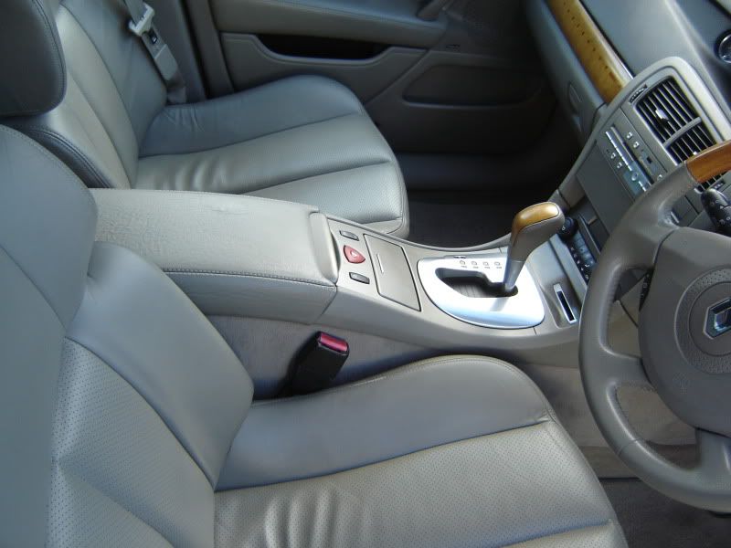

Vel Satis?  Mine for 4yrs. Luxo room in back. Luxo seats....big drivers seat.  A Nissan 3.5 v6, not a luxo engine really.
  Not Luxo suspension.....crashy with low profile tyres. Still, a 32k car that cost me only £1600 5 yrs ago

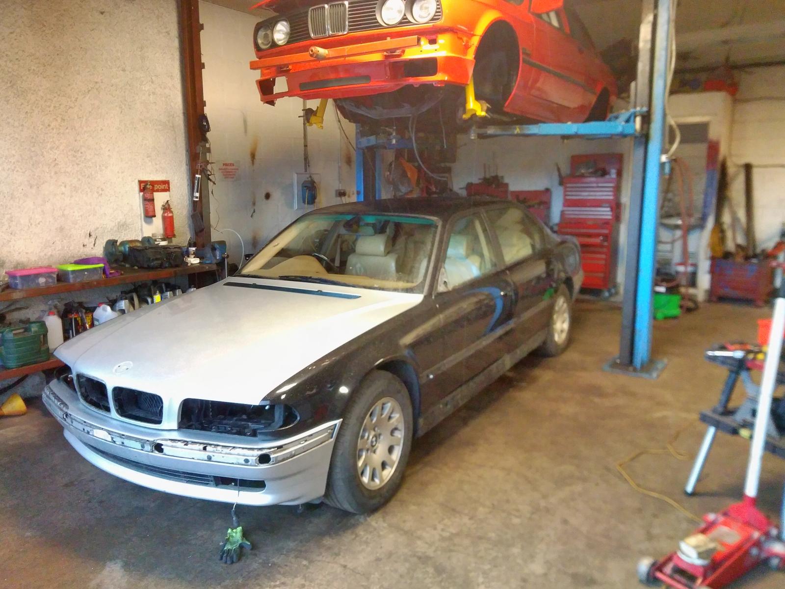

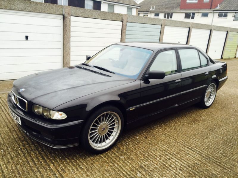

Another proper luxobarge incoming - short of the very rare L7, this is about as luxo and about as barge as can be had in the UK.
It is a 2001 facelift 740il and it's intended for restoration.
Extended wheelbase
4.4 V8
Blinds
Soft close boot
Extended leather
Multifunction armrest
SLS
Footstools
Sunroof
Electric steering column
Nav
Folding mirrors
Chrome line
Extended Wood
Climate front screen
Xenons
Rear aircon
Etc. Etc.
Alpina wheels and lip are no longer - genuinely not to my taste and sufficiently valuable to allow the guy I got it from to get a drink out of the car. Win. Win. The bordmonitor is away too and I'd like to have kept that, but hey ho.
Talking of having a drink. Did I mention the vanity headrests and picnic tables? I expect all you Allegro and Pub landlord types to shut up about your lowly tray things now. *These* are tables.
Arriving next week. Apparently quite tatty, but sound. Will be stunning. Looking forward to it.

The sunroof wasn't opening or closing properly and appeared to be in "jam prevention" mode. Clearing a potential jam and coding the obviously second hand module from an E46 coupe with a glass sunroof to the correct specs, got the sunroof working.
These two free, but significant fixes sealed the car's fate. Pretty much everything else works as it should. It drives well. It's going to be restored.
A set of M Parallels provided by the silver breaker is earmarked for it and currently resides c/o the metal polisher in nearby Cleland.
It'll get its bonnet, bumpers, etc. attended to. It needs a window regulator and a quarter glass where the double glazing seal has been breached (with the car) and then we'll dismantle it for paint and strip the interior out.
It'll go for paint and while it's away we'll reconnolise the interior, and collect the parts needed to finish off the interior - namely rear air con bits and some extended leather if we can find it.
A reversing camera and a nav upgrade to Mk4 is probably all it needs to finish it off.
Quite a bit of work, but it'll be worth it and will create an amazing big car.
More to follow.

So, a week on and the sunroof has been fixed; a window regulator has been replaced; a (double glazed) quarter glass fitted; the soft close boot fixed; the pre facelift bonnet jettisoned; the slam panel that had been butchered to fit the pre facelift bonnet swapped for the correct one; the bonnet cables and catches replaced/adjusted/lubricated; a broken air intake replaced; one PDC sensor housing replaced; front bumper replaced: headlight washers repaired and swapped into the other bumper; cluster whipped out and pixels repaired; rear bumper replaced, and, all the external trim removed and the car is now ready for paint.
There's a couple of wee trim bits we need to acquire before it goes for paint and I think we'll take the interior out before it goes a in order to administer a good old gliptoning while it's away.
Good progress there Boyd!
