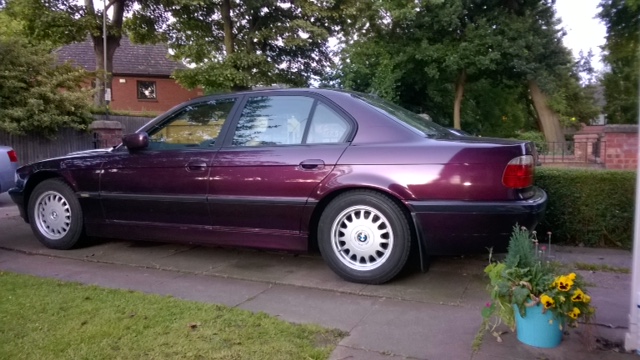

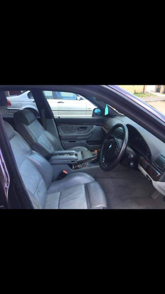

Then, the stack collapsed entirely when laseraligningfoofooflanges posted this Individual Mora metallic 740i beauty on here:-
This was - is - a peach - it needed a fuel tank - spot any pattern emerging? - but it had a superb spec, quality colour, ran well and had the potential to be a lovely, lovely car.
So the two 735is finally became breakers.
Unfortunately, that potential I spoke of in the Mora monster was spotted by a customer one day, who waved cash in my face, offering me a not insignificant profit. I am sorry to say that I succumbed and regretted it even before its bonnet was out the gate. I still do. I should have kept it.

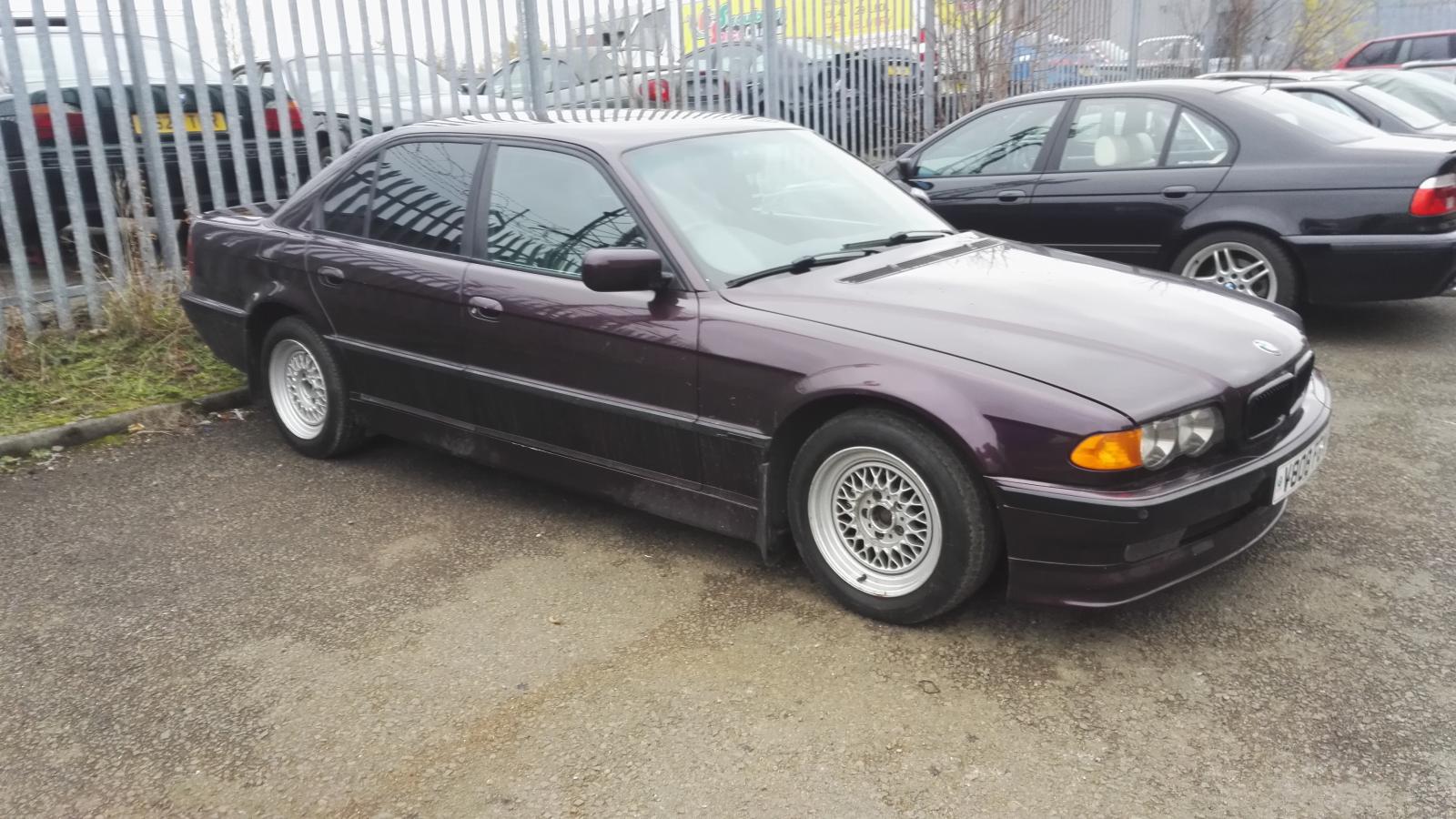

Then, a couple of weeks ago, another Mora Metallic E38 appeared on the scene, this time a 728i sporting M Parallels, Alpina spoilers, quad stainless exhaust, top tint screen, Shadowline, comfort sports interior, black head cloth, DSP, PDC, widescreen Nav, electric sunblind, folding mirrors, Brembos etc..
However, it also came with some history:- a colour change, faulty electrics, a smell of petrol(!), Engine management light on, Cat C and a tamper dot on the mileometer.
So, it's never going to be a retail car, but it's got a cracking spec and because of its faults and "history", it's cheap. I've *still* got that good, new tank, despite it being earmarked for three separate cars now (this'll be its fourth), so we'll fix it up and keep it. That's a plan I can stick to.

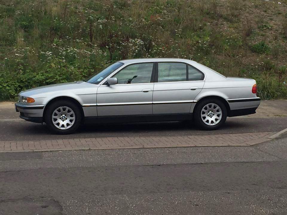

I was offered a local, one owner, 88000 mile FSH, 728i in poverty spec with a gearbox problem, an ABS problem, and, surprise, surprise a leaky petrol tank. The cost of this one owner, FSH money pit? £300. That's the plan up shit creek again and the fifth car to be promised that new tank!
So, what's the plan now then?
The Mora car is now poverty spec with full black interior (every single interior piece swapped, carpets, door cards, seats, seatbelts, all trim, stereo, etc., etc. Externally, it took the older lights, eBay grille, standard mirrors, basically all the goodies removed and swapped for the standard stuff on the silver 88000 mile car. It sounds easy when you say it quickly, but there was a good three or four full days of work in that and honestly, the workshop looked like there had been an explosion on the 1999 E38 production line.
All the goodies are now scattered far and wide - well in the boot of the silver car - and all the interior is waiting to be cleaned and fitted. Once we've fitted the tank, oh and an ABS precharge pump, and tidied up a couple of bits of surface rust.
Here's the Mora 728i now, ready to go to its happy new owner. I think it actually looks better with the black interior, black carpets, black head cloth etc.:-
And just to round us off nicely, and bring us back to the start, do you recognise the 415 TRX wheels it's wearing now?
They were last seen gracing FOAD's E28.
I'll report on the build of the silver one in the next episode....unless the plan changes.
