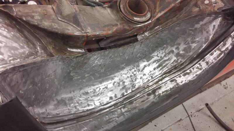

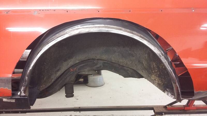

Some more progress made today.  I finished removing the outer arch from the inner and then started to clean up the inner and see how much could be saved.
20170318_100226.thumb.jpg.ab0246858020c868df15f982c9d6dce3.jpg20170318_111855.thumb.jpg.7c8d7b0ff9f5c7334ea912082d764bb7.jpg

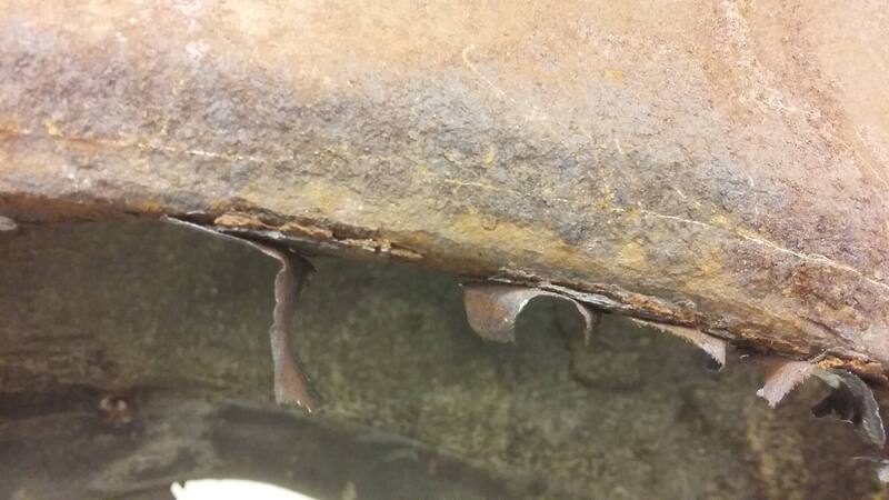

I was hoping to save the lip but its pitted too deeply.  Better to replace as much as possible while i'm here so I've cut it all off.
20170318_111849.thumb.jpg.f063a6d02796695d5d475f61887aebd1.jpg20170318_143400.thumb.jpg.aa5f3b8bf4ebda4d7a2acc7e00c30393.jpg

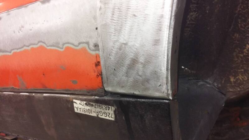

Next I finished up welding and grinding the sill closer.  It's a pain to get to and I couldn't grind down the welds as much as I'd hoped.  I'd much rather the repair be too thick than too thin from excessive grinding so I've left it alone.  Once the stoneguard is on you wont be able to tell.
Once the arch is sorted the bulk of the work on this side will be complete.  I'll then move to the other side and continue with the repairs to the underside.

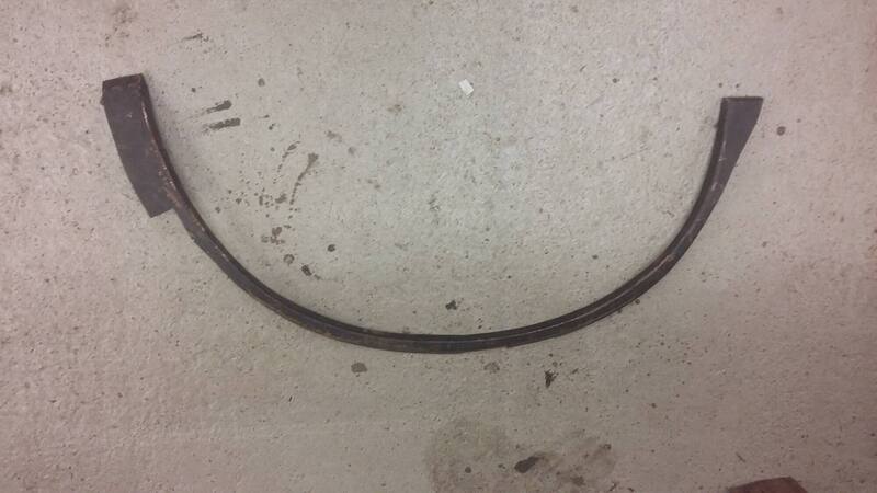

Some digging around in the spare wheel well revealed further rot in the seam where it attaches to the rear wing.  I cut it out with an air saw and set about replacing it.
20170325_091506.thumb.jpg.cf4d4c27a6f4639cd9d9fc8be63dd402.jpg20170325_101606.thumb.jpg.0bcdc1691b50cd9cbe413d385a1f6896.jpg
The two rusted pieces are spot welded together and have curves, creases and folds in them.  The replacement took over 2 hours to make but did at least look like the original.
Again access isn't great but I did manage to weld it back in place and also made up a replacement section for the lower wheel tub.  Once the welds are cleaned up I can put on a replacement inner arch.

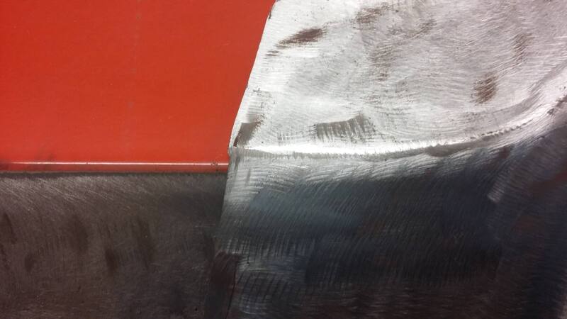

I ground the weld for the replacement inner arch down and finished up with a roloc disk.  Came out quite well so I gave it a lick of paint ready for the outer arch the be trial fitted.
20170408_102133.thumb.jpg.718943914204d57bc95d399860aac8d5.jpg20170408_102153.thumb.jpg.a9ab652ea7fac008ea1fb4db2e9d2d3c.jpg
20170408_103536.thumb.jpg.da2a9bb043f0e2cb0be9e4f175d9a7bb.jpg20170408_103541.thumb.jpg.800259517539f80022466a578f4e1250.jpg
I also finished up some welds at the bottom of the wheel tub.  I use a power file for this sort of work as you have a lot more control as opposed to a grinding disk.
20170408_104517.thumb.jpg.744180ed1eebe1994959a830fafbbada.jpg20170408_105220.thumb.jpg.cdb67bd43a93a82f5282aa3686e8bbcc.jpg

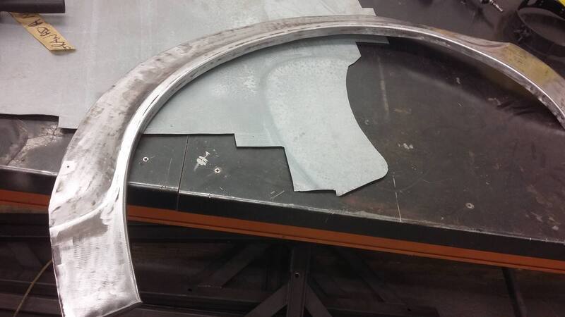

Next I set about removing all the old paint from the replacement outer arch.  Coupe arches are different to saloon so i'm lucky to have them.  These panels are aftermarket and were probably made in the 80s or 90s.  You certainly wont find them for £15 anymore!
20170408_105431.thumb.jpg.750243960e0bfe587813838edcc68a68.jpg20170408_121411.thumb.jpg.e64e9c77e291793b6d3b08d23dadc91d.jpg
Once all the paint was removed I fitted it for the first time.  It will fit but needs some work before that can happen.  The flat fold where it meets the sill is at an angle and the lines haven't been pressed properly.  This is typical of most aftermarket panels so a few hours work will be needed before I can start welding.

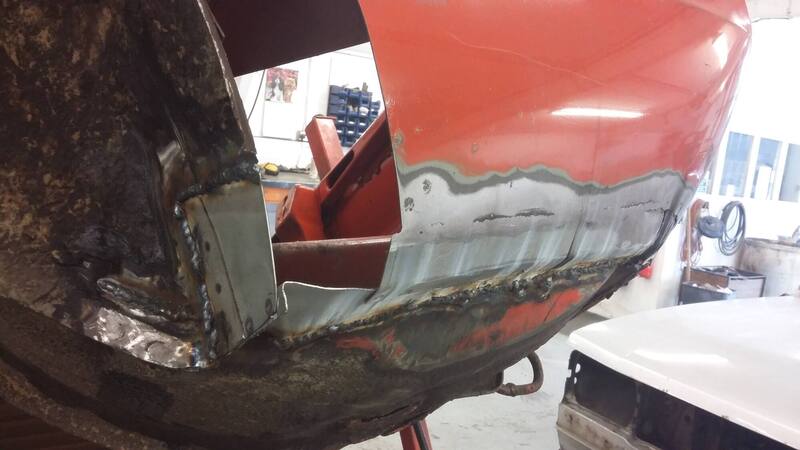

Managed a full day on the car on Friday.  Got in early and cleared a space for the car in the fabrication shop.  The plan was the get the wheel arch completed and painted, about 8 hours of work.

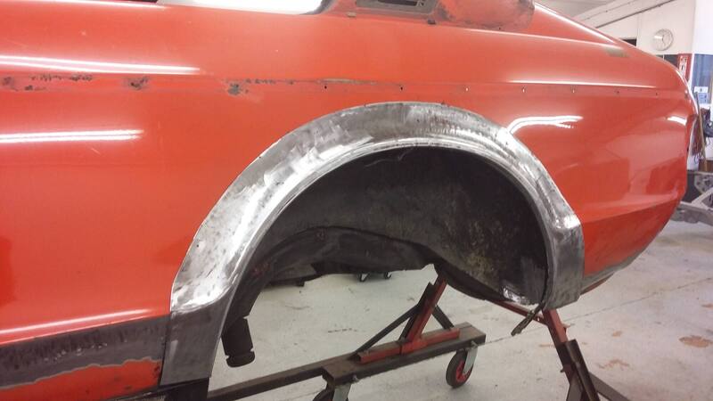

First job was to hang the repair panel on, check for fit and tack to the car.  I cleaned off the old paint around the area to be welded.  The car has never been repainted so getting rid of any paint is quite easy.
The repair and the wing are only 1mm thick and warp like crazy if you're not careful.  About 3 strikes from the welder in one area is the limit.  I did my best to maintain the profile and minimise any distortion.  I have got some slight distortion so a smear of filler will be needed when prepping for paint.
20170414_105448.thumb.jpg.e23f5666d6a38f1f7c2bc76d649eb4ad.jpg20170414_131137.thumb.jpg.c0093a4a3e7d8b31e7fc1487534ccc2e.jpg

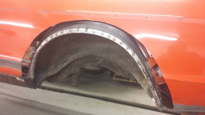

I then rolled the car over and puddle welded the outer to the new inner I fitted last time.  I punched holes in the lip before fitting the panel to make this possible.  Originally it would be spot welded but access means this is not possible when repairing this area.  I also sorted out the lower back corner where is meets the spare wheel well that I repaired previously.
20170414_140751.thumb.jpg.b51674aa3fec409fcee911ce2146bb1b.jpg20170414_152054.thumb.jpg.92d84edc91e39a86b78aecd7eb0a75d8.jpg

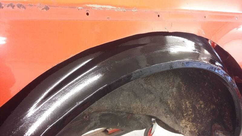

Then after a final sanding down with a 6 inch 80 grit disk I applied a small amount of chemical metal to the areas of the welds that needed it.  This smooths out the repair before any filler and paint is required.  Another 10 years of practice and I shouldn't need to perform this step.
20170414_163227.thumb.jpg.8ba31a75a7689d336fe066e11913980c.jpg20170414_170802.thumb.jpg.c300b1178b62050e6f72689eadec8082.jpg
Another sanding session to remove any excess.

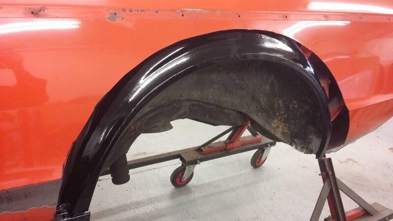

Finally a coat of POR to complete the job.
Quite happy with the result.  Not too much distortion and what there is can be masked with a skim of filler later.  The lines of the car flow correctly through the repair which should mean minimal filler work when prepping for paint.  Time was 5pm so cleared up and went home.  The car is now up to 278 man hours, but I am now in sight of doing the repairs to the other side.

Great work again, can you paint over the por15 you have used on the outer arch or is it just for temporary protection.

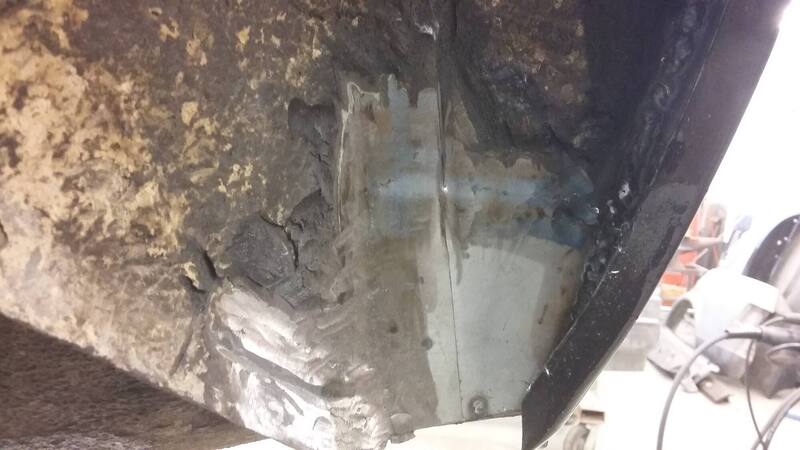

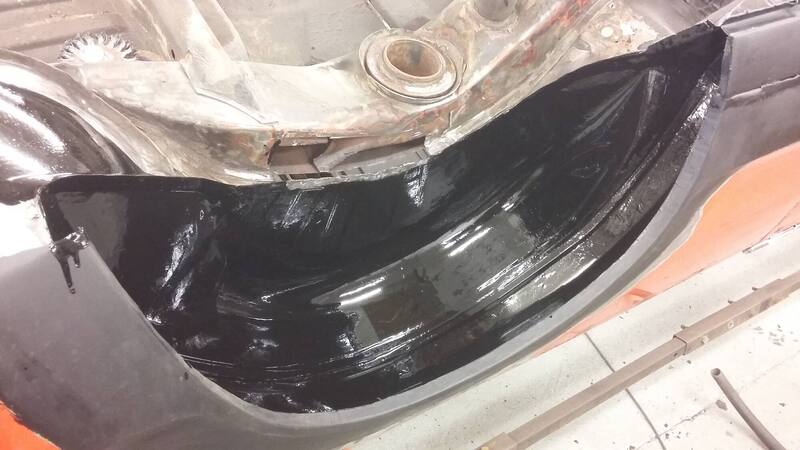

Today I removed all the underseal from the rear wheel tub.  Again there was loads in there and is took a few hours to remove.  I've yet to find a quick & easy way to remove it.  A twist knot wire wheel in an angle grinder seems to be the fastest way so far, but its a very messy method.  Heat just melts the stuff and a scraper and hammer takes far too long.

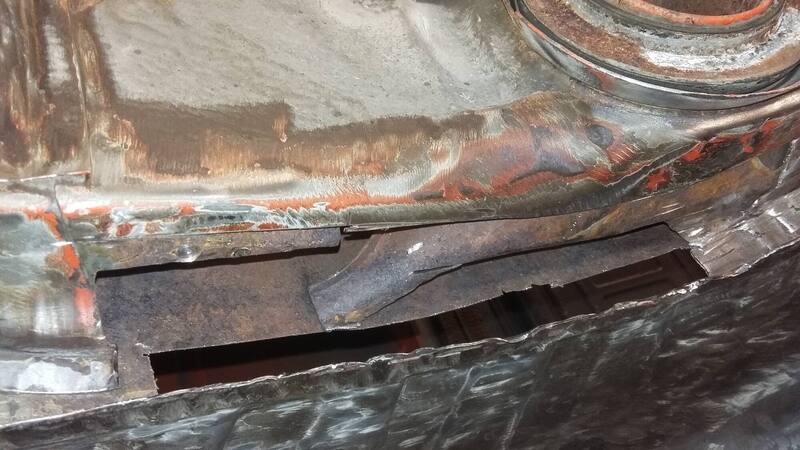

While I was there I started to take a look at the chassis leg.  The side was suspiciously puffy so needed cutting off to see what remains.
20170506_112805.thumb.jpg.0500e13bf50382538690c6ba9dd3abe6.jpg20170506_120906.thumb.jpg.ecf607ce7964e98ba2e05e54e81439d7.jpg
The answer was not much.  The rot has gone through both layers of the leg and taken some of the floor with it.  I'll be cutting a larger bit of floor out from inside the car and then replacing from there.  The leg looks ok inside so far, just the side was affected.  Strange place to rot as its a high point and normally wouldn't get water trapped in it.  Given the amount of time the car sat for I expect its just sweated from 20+ years of storage.
Took quite a while to remove so with little time left I painted up the wheel tub in POR.  Love getting the paint out, feels like progress!

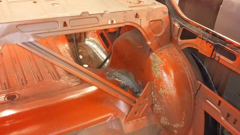

Today I continued fixing the rotten floor over the chassis leg next to the wheel tub.  I cut out a much bigger section of the floor to make sure all the really rotten metal was gone.  Whats left has some slight surface corrosion wihich will be covered in POR and cavity wax when finished.  I also unpicked the seam where this part of the floor is attached to the wheel tub.
20170513_100246.thumb.jpg.51147cf73ce22efd44250980322360ca.jpg20170513_101301.thumb.jpg.d905b9a7f39b4cdc36d882bdcd16751e.jpg

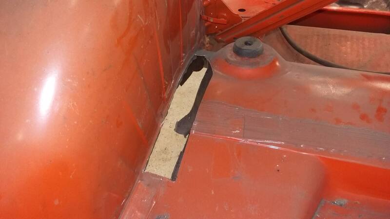

Using cardboard I made up a template and fabricated a new bit of floor from 1mm steel.  The new bit is made of two parts that replicate what was originally there including the flange that meets the tub.   I used a metal folder and shrinker/stretcher to get the seam and curvature to match the existing floor.  The rear half is the boot floor and the front half is the rear passenger compartment.
20170513_120334.thumb.jpg.f34f84d2a07b4dc5abd0e3216d525a54.jpg20170513_135028.thumb.jpg.c9df9a74d4472ec9930f9d7e7525f5f3.jpg
Getting to this area was a pain as you can see below.  I ended up being inside the car lying down to do the welding.  Not recommended when the car is swinging on a body roller!
Managed to weld it in ok and once ground down it will be seamless.  Now the floor is back I can make up the repair sections for the chassis leg that runs underneath.
