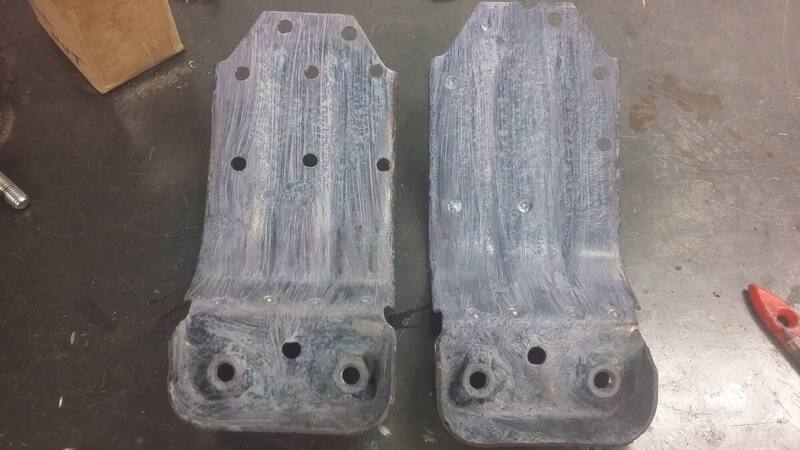

Another day of work completed on the car.  Made a fair bit of progress with most of the time spent removing old underseal.
First job was to rust treat and beef up the transmission mounts.  They have a reputation for the threads stripping out during gearbox installation and its a pain to fix.  Reason they strip is because Ford didn't bother putting in captive nuts.  All these have is a thread cut into the metal that was pushed out by the machine that made the holes.
I've changed these ones to some more robust M10 nuts.  I've also gone around and reinforced all the captive nuts on the floor pan as they are only spot welded on and its not uncommon for them to let go during assembly.

I then painted the mounts on the inside and installed them using a gearbox cross member to make sure everything will bolt up.  These don't have to be mega accurate.  I measured two other Granadas we have in and their original mounts are quite poorly aligned.  I did these by eye and some measurements to known points in the floor pan.

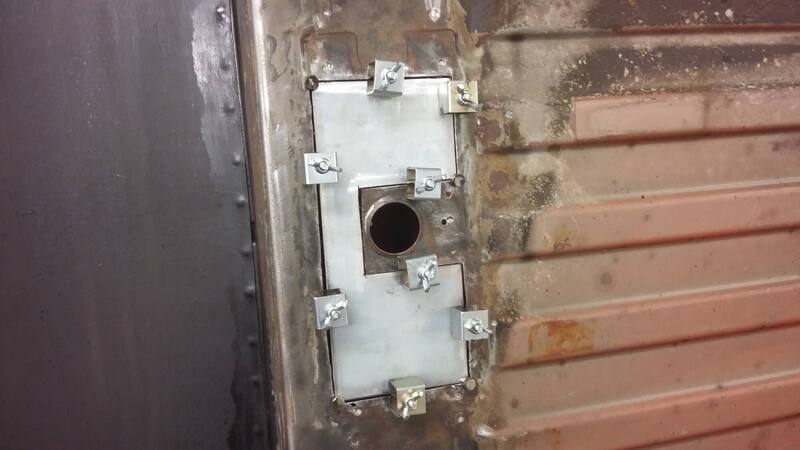

Made some more progress on the diff box today.  First job was to sort out the boot floor where this lot is welded.  As you can see its quite pitted so I decided to replace a large section of the pitted metal.
Before cutting the rotten bit out I made sure any dents and damage where dressed out with a hammer and dolly.  Floor sections like this will always get some damage when you have to remove large structural components from them.  I then cut out the rot and offered up a new bit.  Having removed the dents ensures the repair fits up to all the cut edges of the original floor.  It can then be tacked on and the clamps removed.
20180127_131802.thumb.jpg.aa4faed0fd2e76300f63aae89642179a.jpg20180127_134713.thumb.jpg.ec2029bc114aeeb33872e4d2cda24b05.jpg
I ground the tacks down and seam welded the repair on making sure to control the heat as this 1mm floor is easily warped.
20180127_134050.thumb.jpg.c2cb2f8ed4e3ebe09f2d588c554ea945.jpg20180127_151019.thumb.jpg.0d4dc3ed7760f210ecd11bbe8039df37.jpg
Next I remade the the floor strengthener using the original as reference.  This is made of 1.5mm steel and I reused the tube for the diff bolt as that hadn't rotted.
20180127_093853.thumb.jpg.3e271ec33f9512dbea09eb46a58b9e31.jpg20180127_111227.thumb.jpg.638ce3d0911a6f3c4514bb4cf7357055.jpg20180127_113307.thumb.jpg.be7d41c439c5bba9e16c37aea15b02f8.jpg20180127_114929.thumb.jpg.7b50b0d3caa650f5ba3e609ada181da3.jpg
The remains of the diff box contain two jigging holes which allow you to measure the diff bolt position.  All cars have these holes on chassis components to allow for jigging during accident repair.
On the Granada the distance between the holes on the diff box is 600mm.  Therefore the diff needs to be central or 300mm from either hole.
20180127_153832.thumb.jpg.f49bbe5e04595959698e271486419003.jpg20180127_160307.thumb.jpg.bb7058e348b6a9b4add884a6d57d5fe1.jpg
With the replacement part correctly located I puddle welded it on.  Then I offered up the remains off the outer box to double check the diff will mount in its original location.
20180127_164254.thumb.jpg.694b6388670a69f37635f1d5836f2acb.jpg20180127_163609.thumb.jpg.4173b4e0324b1233a383674ccee1b86e.jpg
Of course I painted both the floor and repair section before welding so theres a nice layer of paint in that seam.  POR is very good at this.  You can weld through it and when its wet it runs back around the weld providing much better protection than weld through primer which just burns off.
Offering up the rusty bits confirmed the repair is in the right place.  Thats completed 50% of the process.  Next I'll need to make and fit another strengthener and then fit a new outer case which will complete the repair.
