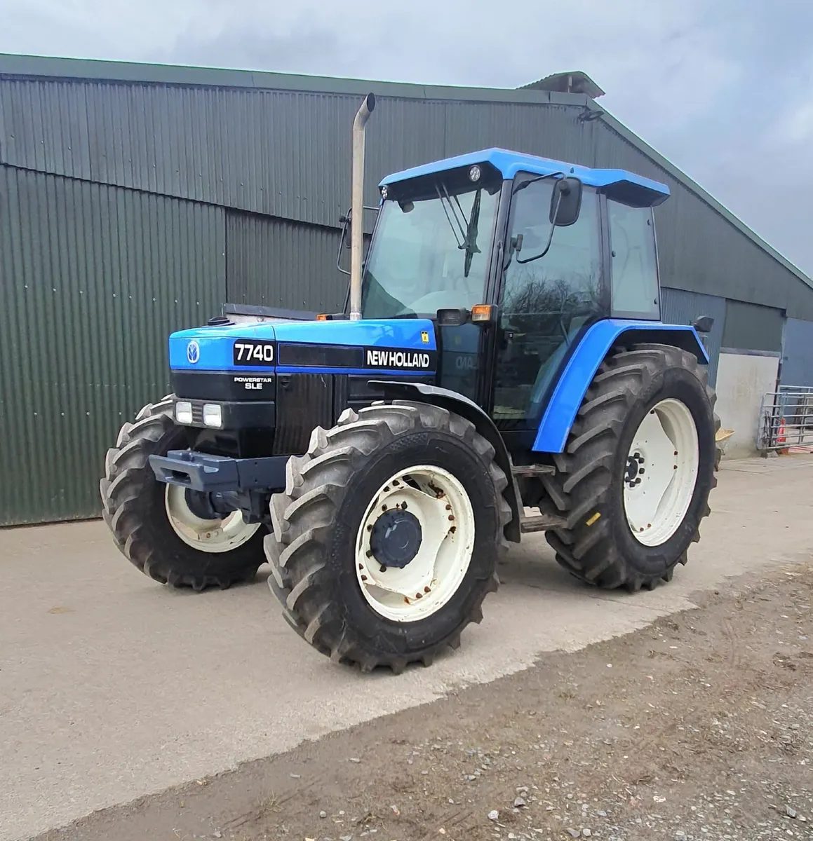

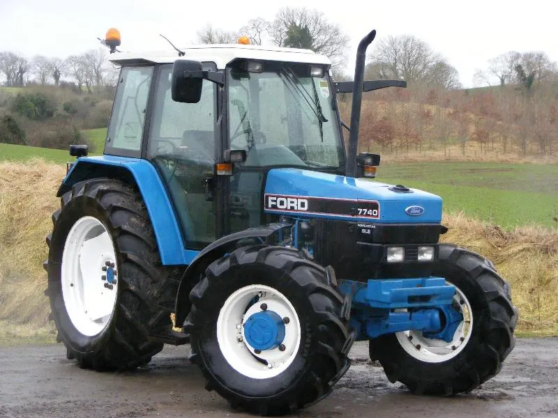

Sounds a lot like Ford Tractors and the gradual rebranding to New Holland (essentially part of Fiat, funnily enough).
New Holland, Case and International Harvester have an unnecessarily complicated pedigree that rivals Talbot. They're all now basically part of the company that owns Stellantis and IVECO, and are made in the UK on the same production line... but with different badges. Confusingly though, International Trucks is a completely separate company which does not actually sell them internationally (unless you count Mexico and Canada).
Peak globalisation, really, yes the tractors are made in the UK but it's really just an assembly line - most of the parts will come from abroad. You can frequently see cabs on the motorway coming from ferry ports for example...

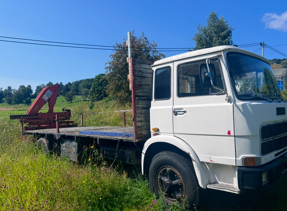

Come to think of it, this type of rim wasn't common in Norway either, but now a 1975 Fiat 130NC has come up for sale here and it has these wheels.
https://www.finn.no/mobility/item/409462813?ci=1
I showed these pictures to my dad now who was driving and was close to a lot of older trucks and buses and he has never seen those rims so it must have been a rarity here.
