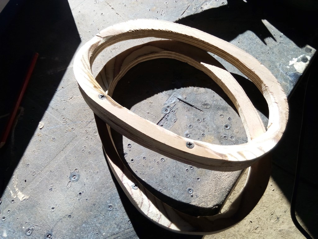

dave21478 Posted January 26, 2017 Author Posted January 26, 2017 Since I am mentally still 17...Pumpin choonz are required in all my cars. The MGF already has upgraded door speakers, but nothing more. Ideally I would like an amp and sub in it, but there is just no room for a sub box. No point putting it in the boot as with the engine between boot and passenger cabin I wouldnt hear anything. I have seen a few folk fit wee subs under the seats or in the passenger footwell but its all a bit of a faff for not ideal results. As an compromise I decided to fit rear speakers as it had none. A set of Alpine 6x9s were bought....as seen on every sagging Nova parcelshelf about 20 years ago. Posher models of MGF have rear speakers in the trim behind the rear seats, and since there is a reasonable bit of depth available behind it, this was the ideal location. I could probably have fitted smaller speakers straight into the plastic, but I couldnt be fucked with tinny wee speakers and hoped the 6x9s would give a reasonable amount of bass. I glued up a couple of layers of 18mm plywood and carved it down to shape with a flapwheel in the grinder. Not pictured, I wrapped them in acoustic cloth, and cut the mounting holes in the plastic trim. In place.... And the other... The top screws are about 120mm long and go into the metal reinforcing strut that runs under the top of that trim.NOTE - dont screw into the bulkhead, the pez tank is right behind there. Dunno how high it comes up, but not worth the risk.The lower screws on my speakers are just into the plastic trim with plywood slipped in behind for them to grip into. There is no wiring for them but its easy to run a pair of wires tucked up under the edge of the centre console and up to the stereo. Had to cut off the standard ISO plug as it only had connections for the fronts, so wired in a new one with all four speaker connections. Sounds decent. No substitute for a proper subwoofer, but banging enough for my Ministry Of Sound compilations. Barry Cade, DeeJay, Sigmund Fraud and 1 other 4
Mr A Lawrence Posted January 26, 2017 Posted January 26, 2017 This is what you want. https://www.ebay.co.uk/itm/272296391162
dave21478 Posted January 26, 2017 Author Posted January 26, 2017 meh. That sort of thing tends to be slightly pish. I havent seen one yet that I would go to the effort of fitting.... Maybe two of them would be better?

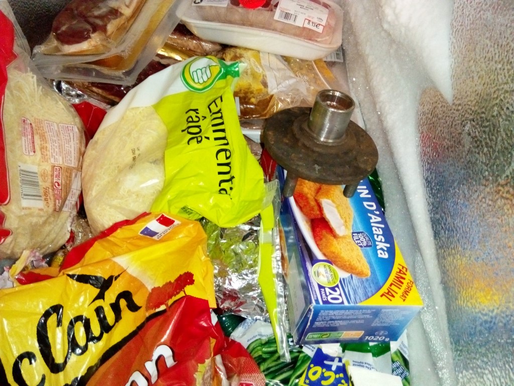

dave21478 Posted February 23, 2017 Author Posted February 23, 2017 Out for a drive a while back and there was suddenly a rythmic clonking relative to road speed from the front. I pulled over and checked wheel nuts etc, but nothing obvious was found. I nursed it home with the clonking getting worse and the occasional squeal too.With it on the jack the front left wheel was very rough to turn and had about 30mm free play....obviously a dead bearing, which had failed suddenly rather than giving the usual warning droning noise. I dismantled it a few days ago and found the top ball joint was a bit loose so decided to change that too. I ordered the parts which turned up today. I read about this online...apparently it helps with bearing installation so I thought I would give it a try. One of these things is not like the others..... With the drive flange chilling in the freezer to contract the metal, I put the hub in the oven on a low heat to expand it slightly, the theory being the slight size changes make pressing the bearing in easier.Nicely done.....And yes, I know my cooker is minging. But it all went to fuck. I doubt it was anything to do with this method and more likely my ham-fistedness, but when I was pressing the bearing in with my big vice, there was a sudden loud crack noise as it was about three quarters of the way on. I backed it off and the bearing was cracked. No choice but to remove it, which fucked it further. Bummer. I also managed to strip the threads on the end of this part which holds the hub together, purely through my own stupidity. So, new parts on order, 50 euros lost, and we wait for round two.....
drum Posted February 23, 2017 Posted February 23, 2017 Bummer.I've done the freezer cooker thing and it does help.
chodweaver Posted February 23, 2017 Posted February 23, 2017 Well, that fills me with an unpleasant amount of trepidation!... I have my first interference fit wheel bearing to do soon and after just binge reading this entire thread (respect x 1,000,000) I'm thinking that if this job is giving you trouble... ...I'm fucked Good luck Mr Numbers Sent from my BV6000 using Tapatalk
M'coli Posted February 24, 2017 Posted February 24, 2017 My method for cv-joint bearing removal is as follows: two bricks to hold the hub off of the ground, place a metal container (a tuna can or a cut-down beer can) with meths underneath the hub, light the meths, let it get mad hot then pour some cold water on the bearing to contract it, and drift it out. I've never had a problem with them going back in. The inner race on the hub I've usually cut a big lump out of them with an angle grinder and then split the race with a chisel and hammer.
dave21478 Posted February 24, 2017 Author Posted February 24, 2017 Aye getting them out is no problem. I run a fat bead of weld round the inside of the outer race and as it cools it contracts and knocks out easily. The inner race gets a slit with the grinder and split with a chisel.I don't know what happened putting the new one in, perhaps it wasn't quite square causing it to crack. alf892 1
alf892 Posted February 24, 2017 Posted February 24, 2017 maybe warming the casing meant it had more slop so could go in a bit on the piss? I've always found that if you get them reasonably straight to start they kind of find their own way in
