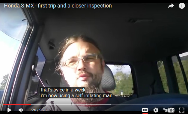

mouseflakes Posted October 14, 2016 Posted October 14, 2016 SPECKTACKLIER subtitles again! drum, overrun, worldofceri and 14 others 17
bub2006 Posted October 14, 2016 Posted October 14, 2016 Well well well. Each to their own i suppose! mouseflakes, The Moog and overrun 3
Felly Magic Posted October 14, 2016 Posted October 14, 2016 Dollywobbler is now an Autoshite comedy legend Slartibartfast, The Moog and chaseracer 3
