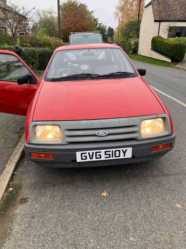

wuvvum Posted October 29 Share Posted October 29 I would assume that if it was the dipped beam filaments in the bulbs that had gone, the headlights would come on (and stay on) on main beam when the stalk is pushed forward though? The fact that they only work when "flashed" suggests to me that it may be the main light switch at fault, although it could still be the relay if it's a complicated one I suppose. Link to comment Share on other sites More sharing options...
Marina door handles Posted October 29 Share Posted October 29 I would put money on the switch being at fault, when I lost dipped beam in my Manta, my 944 and my 5 series it was the switch each time. Moving parts wear out and go wrong. Link to comment Share on other sites More sharing options...

BorniteIdentity Posted October 29 Author Share Posted October 29 Some good thoughts here - thank you. I will invest in a new light stalk. Amazingly, they show up on ebay for £15 even when given the usual "COSWORTH L@@K!!1!" keyword spamming. mk2_craig 1 Link to comment Share on other sites More sharing options...
Noel Tidybeard Posted October 29 Share Posted October 29 don't forget headlights on a sierror only come on with ignition live- could be a fuse that isnt obvious Link to comment Share on other sites More sharing options...
High Jetter Posted October 29 Share Posted October 29 I've taken indicator switches apart, cleaned contacts and lubed moving parts. #autoshite Link to comment Share on other sites More sharing options...
