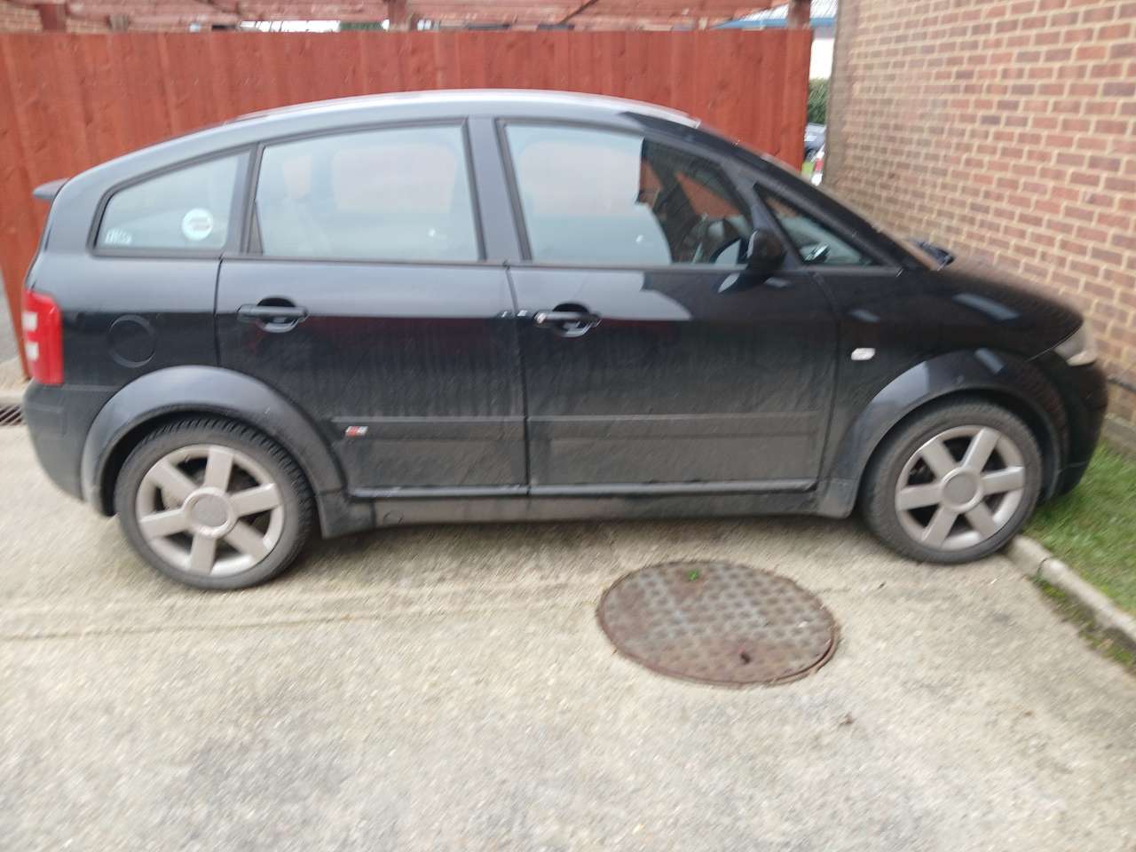

Today has not been a good day.  I have a great relationship with my favoured garage, but I could hear the distress in his voice on the other end when I answered his call.
"This isn't particularly great news, Daniel".
Long story short I dropped the Audi in with four niggles.  All largely result from the car being laid up for a few years before entering the AS family, and all fixable.
  1. Brake fluid escaping through incontinent wheel cylinder.
  2. Battery light flashing under acceleration/load.
  3. Suspension clonk
  4. Car reluctant to get to temperature
The wheel cylinder is shot.  It has pissed out brake fluid everywhere in considerable fashion.  Shoes are brown bread and drums are lipped.  Brake pipe is not in great order at the back of the car; I've asked him if he could put a join in should it need repiping but he looked reluctant.  Corrosion has begun, of course, along the majority of the run.  The piping may wait, but drums shoes and cylinders are on order.
The alternator bearings are beginning to go which is why the alternator mostly works but also doesn't.  This is, at an informed guess, because of both old age and being laid up.  Replacement being fitted.
The suspension clonk is coming from the lower arms.  The balljoints are built in on these so the most comprehensive fix is to change the whole shooting match and polybush at the same time.  Two lower arms on order.  Furthermore, one front shock has shat itself completely and the other is misting heavily.  Two shocks on order.
Mechanic can't see any reason the car isn't getting to temperature so we're going to stuck ANOTHER new thermostat in, even though £95pug put one in already.  For context, I did 50 miles yesterday of both chugging and blasting about and it never once hit the magic 90 degrees.
As ever, I write here as a log of both motoring highs and lows - and hold no ill-feeling towards the previous owner.  You win some, and you lose some, and over the last 12 months I've taken a repeated hiding on cars.  I reckon I've stacked up about £5,000 of repairs and fixes which makes me look completely foolish.  Mostly because I am.

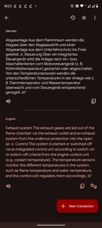

Page 67 of part 4 of "Audi A2 Technology" describes the operation of the webasto.
http://www.volkspage.net/technik/ssp/index3_eng.php
Unfortunately it's in German but it does seem to confirm the heater is used to help the engine warm up.
If there is a shiter local to you with VCDS they should be able to connect to the webasto as module 18 and see if it's unhappy for any reason.

Thanks for this, Señor Q. The Webasto appears to be working perfectly. On a run at 70 it hits full temp after about 15 miles but 50 miles around the doors and no dice.
