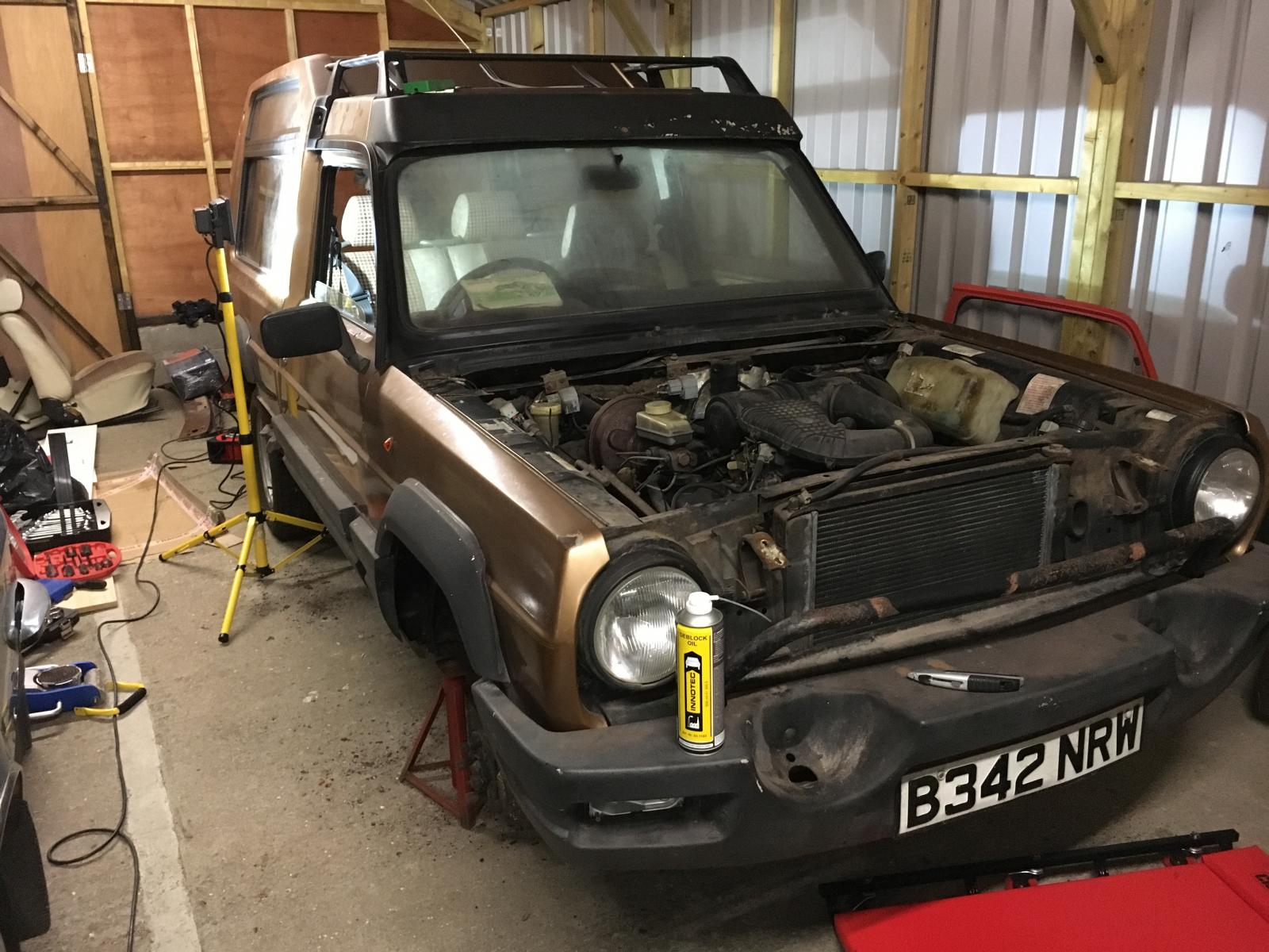

Work has finally begun!
The esteemed Mr Braddon81, himself a serial Talbot botherer, came round to the shed this afternoon and we set about the Rancho with spanners, screwdrivers, Innotec De-Block Oil (which is like PlusGas) and (briefly) a bradawl and a dead-blow hammer.
1984 Talbot Matra Rancho by Skizzer, on Flickr
You'll be pleased to learn - God knows I was - that the doors still open and shut just fine with the front on axle stands.  And that the axle stands haven't gone through the floor, at least they hadn't as of about 5 o'clock this afternoon.
The method for removing the bumper became obvious once we'd taken the wheels off, there's a nice big bolt.  One side undid very easily;  on the other side, the captive nut let go.  So there's a whole load of other bolts to undo to remove the rather complicated Heath-Robinson bracketing arrangement that holds on all the various bits that turn a Simca 1100 into a macho Rancho.  We're not quite there yet with the bumper - some more bolts are soaking in de-block oil - but we're out of the starting blocks at last.

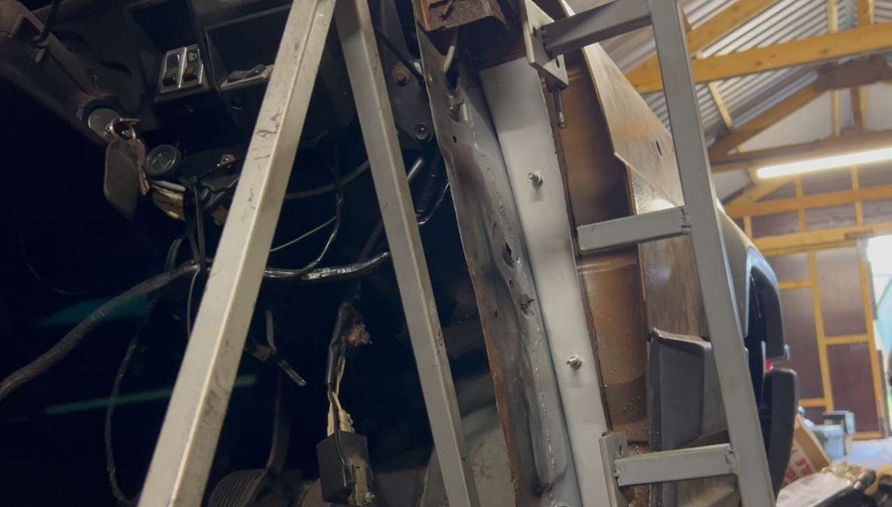

I decided to dive in at the deep end and repair the driver's door post first, as it didn't look too complicated or rusty.  Haha, on both counts:

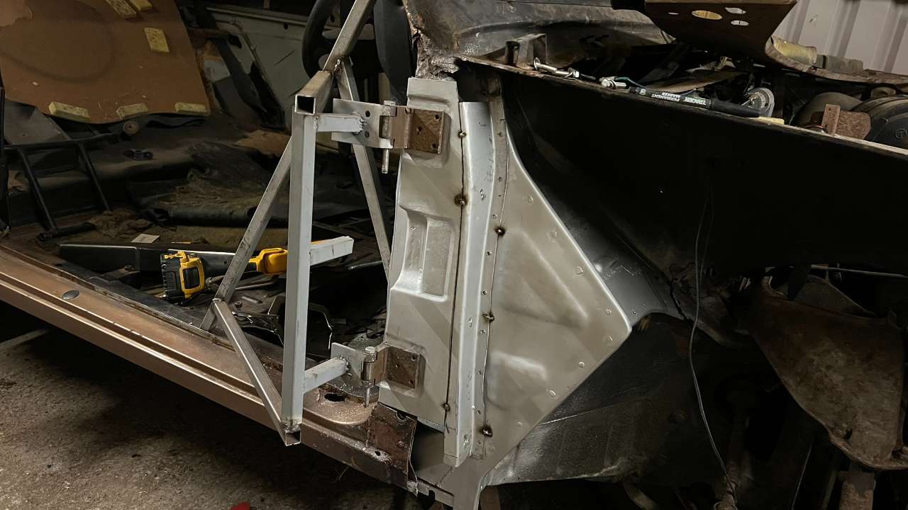

With the wing and door removed you can start to see that it's got a mixture of holes and rough (although solid) patches.  I welded some bits of box section on to the door-side halves of the hinges so that I could fix where they went in case I needed to unmount the car-side halves.  This proved wise.
Long story short, the more I cut the less metal I found.  The patches were holding it together but there was just rust and big holes underneath where there should have been a double skin of metal.  In the end, the whole of that vertical box section had to come out apart from a thin strip of the inner skin.
Before I cut everything out I made a series of repair panels while I still had some reference to go by.  (There are videos on YouTube on how I made these if you're interested - I won't post a link as it bothers some people but if you search for Rancho restoration you'll soon find them.)

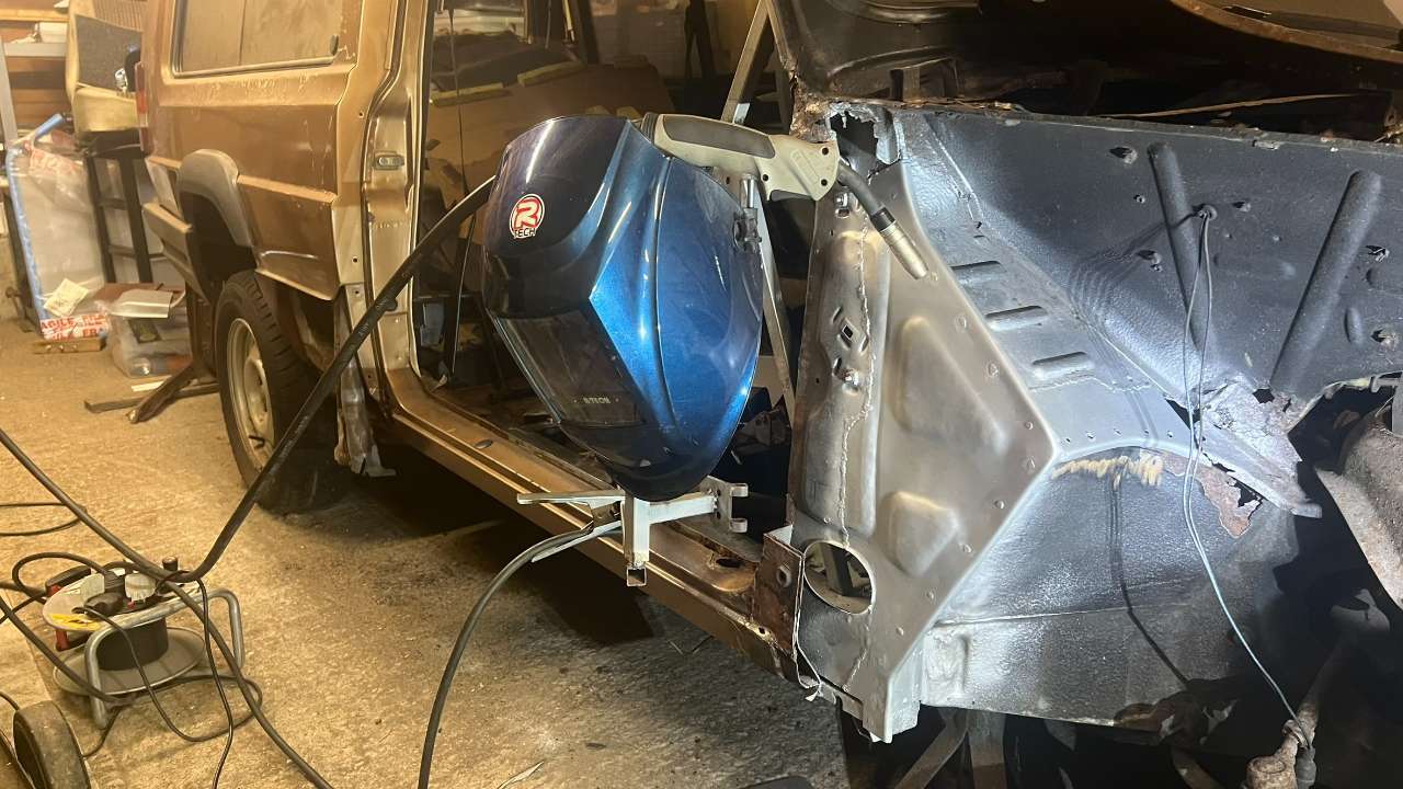

...and then started to weld fresh metal on to the car bit by bit, gradually cutting away more rot as I went.
The silver paint is weld-through primer - it's not ready for proper paint yet but this stops it getting covered in surface rust in the damp atmosphere here on the South Wales coast.
