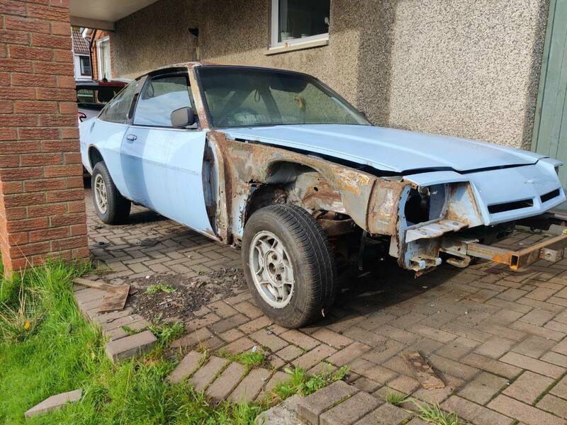

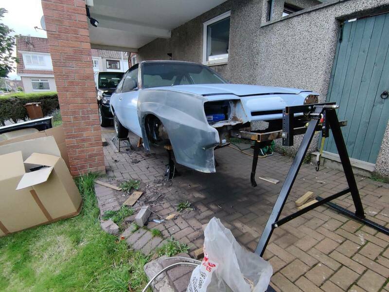

A little bit of progress with the Manta-I'm carrying on stripping it back to find the rust in preparation for repairing it.
On the inside this means stripping back the original sound deadening to find out what lies beneath. This is great fun and tends to involve a hammer and chisel to chip away at it.
IMG_20210731_181934.thumb.jpg.de6401a24c91883455225fac381afef3.jpgIMG_20210731_181928.thumb.jpg.9d588932c11fc43f1e21e785abaa1275.jpgIMG_20210731_181924.thumb.jpg.82fade2a7f5b72d70b0f86b2cbffdade.jpgIMG_20210731_181922.thumb.jpg.e36b61dfa11065e0478796994f42c6c7.jpg
To get a break from this I started stripping back one of the arches to see what I could find. This doesn't look too bad. There's lots of seams and lots of seam sealer. I didn't have to go too far from the rotten parts to find solid (ish) metal. It'll likely end up getting cut out anyway when new panels are made.
IMG_20210731_181857.thumb.jpg.a1709752af4f892e0c2a87350b7cb8b9.jpgIMG_20210731_181855.thumb.jpg.f2eb5b62abbf9b237589ee9e0fd40229.jpgIMG_20210731_181847.thumb.jpg.4c8b8bdfbd8ddfa5971d84d33effc488.jpgIMG_20210731_181841.thumb.jpg.a661451a44abc6a137ac6a543de2bee1.jpgIMG_20210731_181836.thumb.jpg.19242f02e42c03e3287559b11e3f36fd.jpgIMG_20210731_181831.thumb.jpg.edd5652da39ce18b1d1890c281851efc.jpgIMG_20210731_181827.thumb.jpg.a9fd8901dbec9152cc95f2c5a2b34b99.jpgIMG_20210731_181814.thumb.jpg.52ed3f90d6890e7f02d2e37cc660c8b4.jpg
At the front I've removed the lower front panel-it was pretty rotten and the 400 bumper renders it useless anyway
The engine bay is stripped back and ready for repairs.
And the headlining has been removed. It was knackered so a bit of brutality had it out.

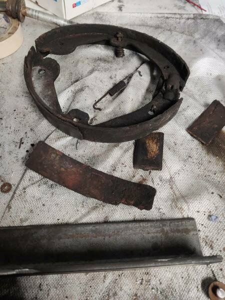

I finally got round to changing the rear discs and pads on this. Unfortunately, stupidity happened. The first disc I went to take off was stuck to the hub, or so I thought. Gentle* persuasion with the hammer got it off, but the handbrake shoe material came off with it. And the backing plate is damaged now too. Bollocks.
Here's what's left of the drivers side, I've reassembled it minus the shoes just now while i order up some new ones.
The other side came off OK (once I undid the adjuster for the handbrake) but was missing one of the shoe retaining clips completely, amazingly the handbrake seemed to work though. I reassembled it using one from the drivers side. Hopeful I can rig up something to get the handbrake working without resorting to trying to change the backing plate, that looks like an arse of a job.
The old discs were pretty bad though so it needed doing.

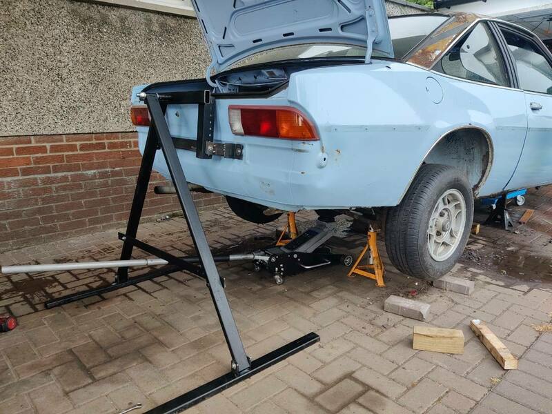

I finished off the jig yesterday I had the brackets to fit it onto the car still to assemble. It's now done and I've got the rear section attached, thankfully it hadn't fell off when i left for work this morning. Next up is mount the front too and then leave it for a bit to make sure it's solid, then I can try actually rotating it on the spit 😵
Jack is now removed, axle stands are still there ready though just in case...

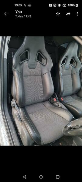

Oh, and in the spirit of doing things in the wrong order, I've bought some seats for it.
 Screenshot_20210809-130541.thumb.jpg.a2cbc0b7d944ab3724672b9c59ba74da.jpg   Screenshot_20210809-130549.thumb.jpg.2c00151f4bf24616f87712cf706d402e.jpg
Out of a Corsa VXR, they fit perfectly in with the feel of how I want the car to be when finished. Or at least they will, once I get the centres retrimmed with a reproduction of the Opel Blitz fabric found on the original 400s
A long way off I know but they came up at the right price locally so they can go into storage for a while.

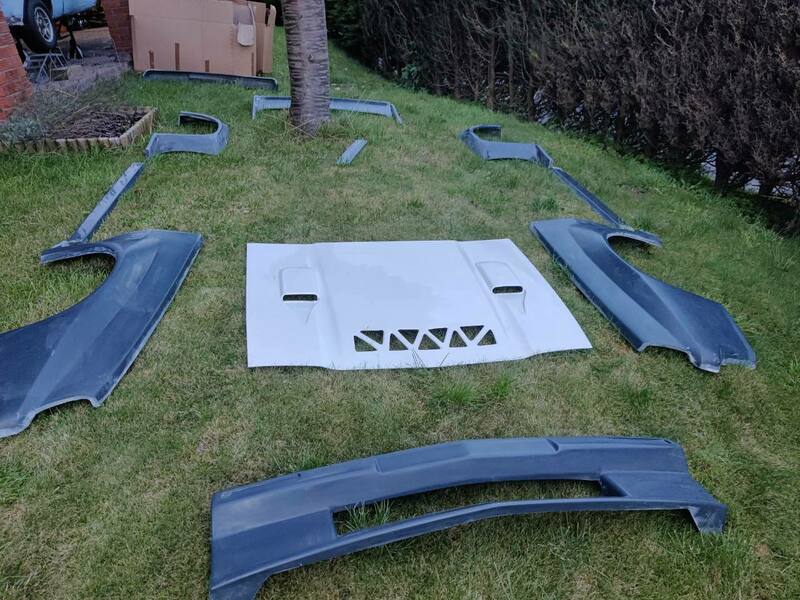

Today, A Good Thing happened. The Manta 400 kit arrived😁
The guys who made it are rallying in Arbroath this weekend so offered to drop it off. A small gift was supplied by me to say thanks. Scottishy goodness
As delivered
Laid out. Hopefully it won't get this close to a tree when it's fitted to the carIMG_20210924_190235.thumb.jpg.ab8868a1f450fd16e0eb18999c6dba1c.jpgIMG_20210924_190202.thumb.jpg.66dd5ef9fea348372256006bc2376f67.jpg
