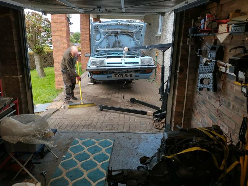

I set out yesterday to see how far I could get toward getting the engine and box out of the Manta.
I decided to drop the front subframe out of it with the engine and box attached, this made sense as the subframe needs to come off to weld the chassis rails, also I'll be refreshing everything at the front. And rear. And middle. Anyway...
I started in the engine bay and removed everything I could  to be able to drop it out, taking photos and marking connectors as I went. Fluids also were dropped and pretty soon it was looking like this.
Onto the underside and I made a list
Again all fairly easily achieved and everything that came off came off in a way where it can be either reused or sold on if not required for the future.
Off to my lockup and I picked up my engine crane, in storage since the MR2 engine swap.
Hello old friend.
There are essentially 6 bolts holding the subframe on and engine and box in
Two near the shock turrets-loosened off ok
Two at the gearbox crossmember-not part of the subframe but required obviously.
And 2 main ones at the rear of the front wishbones. I'd removed the nuts from these leaving just the bolts to withdraw.
The passenger side one came out no bother, the drivers side one wasn't playing. I ground the head off with a view to hammering it through but no joy-it had seized into the bush sleeve on the subframe.
Bother.
I sacked it off last night to save my sanity and go and get beer/curry.
Back at it today after cycling and I had another go. I managed to get the grinder in to the shaft of the bolt between the chassis rail and subframe. Success!
So, we're now at this stage.
Entire subframe is resting on the trolley ready to be pulled out.
I need to get the front of the car high enough to make this happen. This could be interesting, but it's not my first rodeo. Plan is to get the back of the car as high as possible and then raise the front to slide the whole lot out. Should be fun...

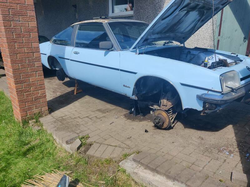

Pics to show the space I'm working with.
Christ I'd love a workshop to do this shit in!
The radiator support is the killer for needing height to go forward with the engine or back with the car. I only did it that way at the time as I had no hoist and gave me the idea to fit the V8 that way to cut the minimum out of the sump pan.
You have the luxury of block paving and a cover, I built all my cars up until this century on an uneven cinder driveway in all weathers!! :-D  I'm keeping my fingers crossed for you with the vinyl roof around the front and rear screen tops, I have taken a couple off and found them rotten. :sad:
If the springs are SR pack originals they are really long and need care to remove them. First one I removed was on my '80 Ascona SR, I undid the bottom balljoint and lowered the arm expecting the spring to come out easily and it stayed put. I had no spring compressors so I tied a rope to it and pulled from a distance, the bloody thing came out and chased me up the road! A friend borrowed the correct Vauxhall tool to do his and the chap explained carefully how to use it safely as he had lost his thumb doing one. Most I did after that I would jack the car under the wishbone to load the spring up then hit the coils with Oxy-Acetylene to soften them, the uprated and lowered springs are much shorter and come out easily. From memory they were 400lb fronts and 170/200lb rears for road cars, still rode quite nicely too.

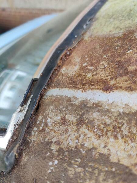

You made me go and rip the rest of the roof off, as much as I can without taking the screens out.
IMG_20210518_140618.thumb.jpg.fb8b1e39d1208e0da96b18ecfdffb9de.jpgIMG_20210518_140624.thumb.jpg.3ce26d1b0ee067170e9aecade0ea5b57.jpgIMG_20210518_140635.thumb.jpg.b8c50899d0814048bf95bfec579c7010.jpg
There's a tiny hole here at the top of the rear screen, the only one I could find so far...IMG_20210518_140652.thumb.jpg.e3365a49e214f6ed1fad43bea7218931.jpgIMG_20210518_140655.thumb.jpg.296306ee3b47d6c0c55c3de992cede66.jpg
The screens will need to come out  anyway, I'm not looking forward to doing that 🙈
