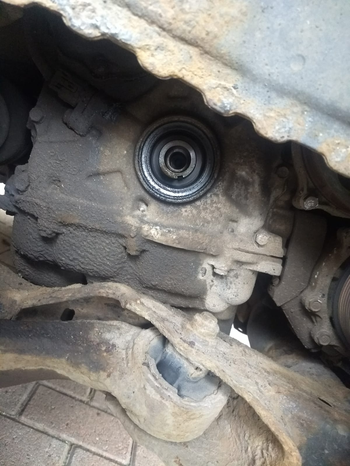

dome Posted May 11, 2018 Author Posted May 11, 2018 Took me a while to get onto this, I was supposed to be getting a loan of a crank locking tool but it didn't happen so I had to order one and wait for it to arrive, which it did today. I drove about 500 miles today(but not 500 more) so am pretty knackered, I was keen to try out my new tool though so cracked on after work. Tool gets a 1/2 drive breaker fitted and jammed into the wishbone Just a wee extension... Bam! Victory! The VTEC solenoid bolt looked pretty nasty so I applied some heat, possibly enough to fuck the solenoid, I'll need to test it. I did get the bolt out though, I'd rather replace the solenoid that than extract a sheared bolt from the head! And here we are. I got as far as taking the timing cover off and stopped for food and beer, will crack on tomorrow. Will drop the oil tomorrow too and change it. I wasn't going to spend anything til it was running but the filter has been there for while, which goes some way to explaining why the chain is fucked. Have fun doing the timing chain . Having done a couple in situ I’d be dropping the engine and box out together on the subframe . Can be a right twat getting the chain case unstuck Fuck dude, never do a Clio 1*2, this thing is cavernous compared to one of them! I dropped a 1/4" drive socket and it hit the ground, that doesn't happen on a Clio! cort16, Jim Bell, twosmoke300 and 8 others 11
