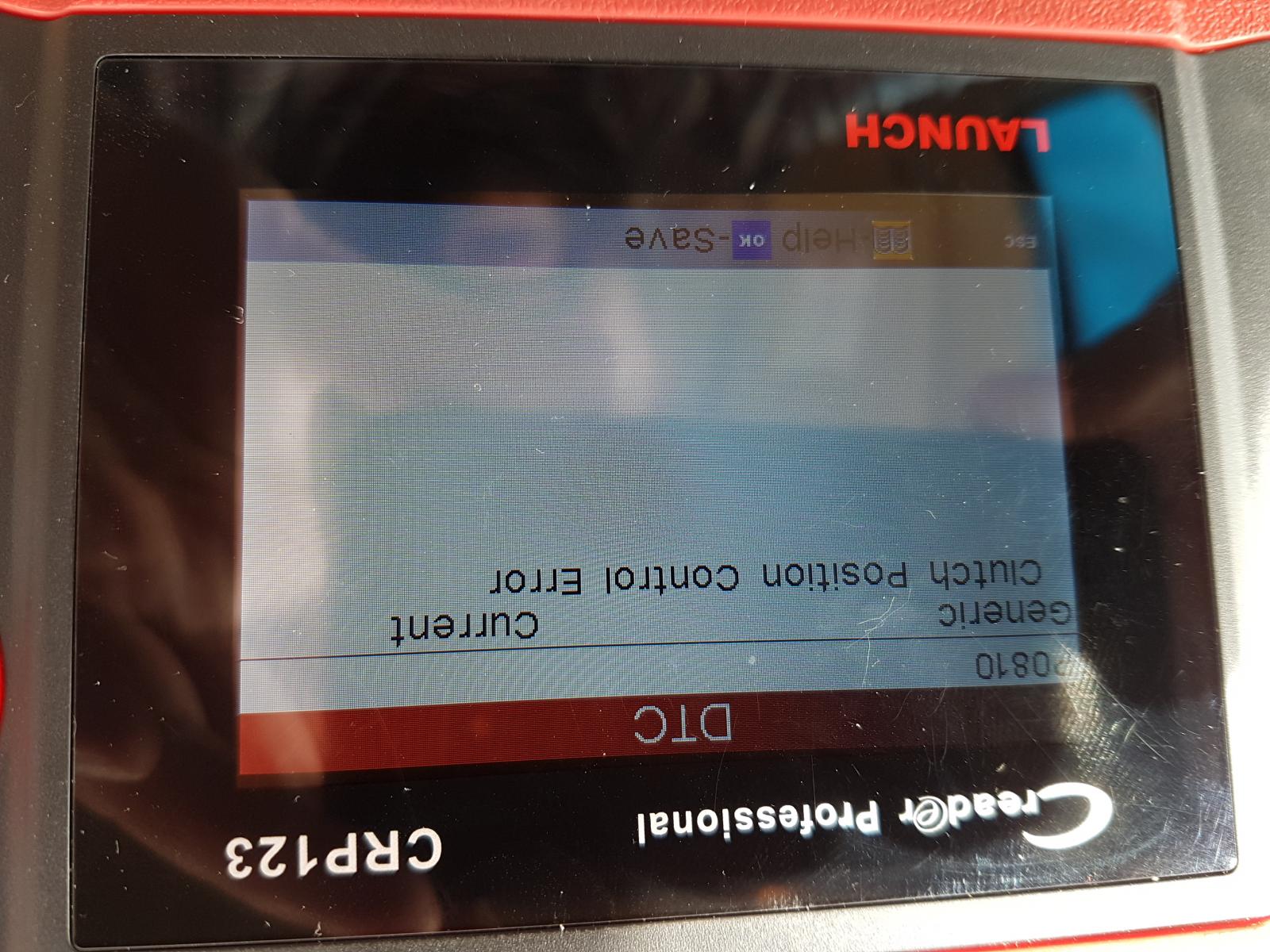

Overruns fancy reader also shows this code.

I had it twice on auto's that clunking changes and too many rev's came down to the MAF being on the way out but I would have thought the code reader would have picked that up.
There's no eml on (though it goes off and on correcrtly at ign) but there's stored codes for clutch position error and fuel pressure error. And something else trivial. It's strange that the codes only show when connected, with no indication but I guess that's moderns for you.
Do those codes stay after you clear them, restart and go for a short drive?
Codes can stick around after the fault has disappeared and some cars turn off the EML in those circumstances. Always best to clear the codes then go for a drive to see if they come on, as you have no idea how long those codes have been there for.
I remember scanning my smart that had no EML on and it found about 20+ logged codes none of which it found serious enough to put the light on.
