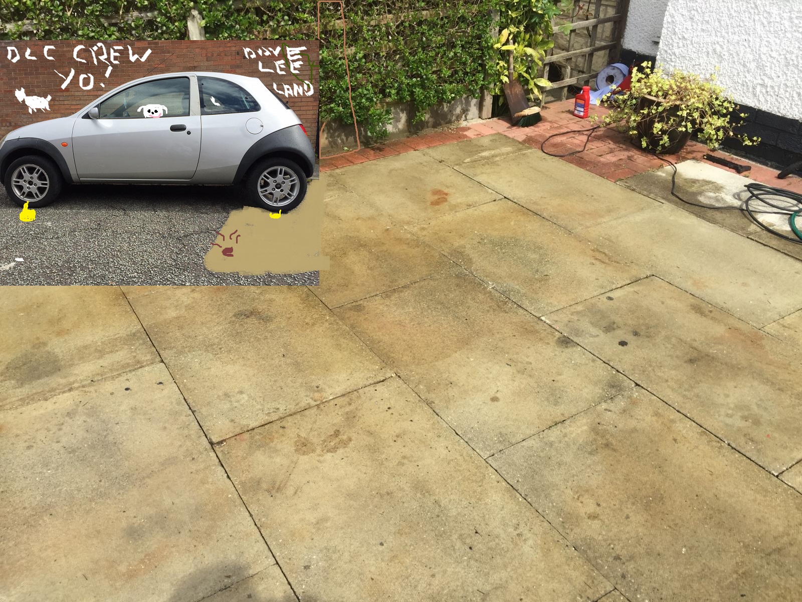

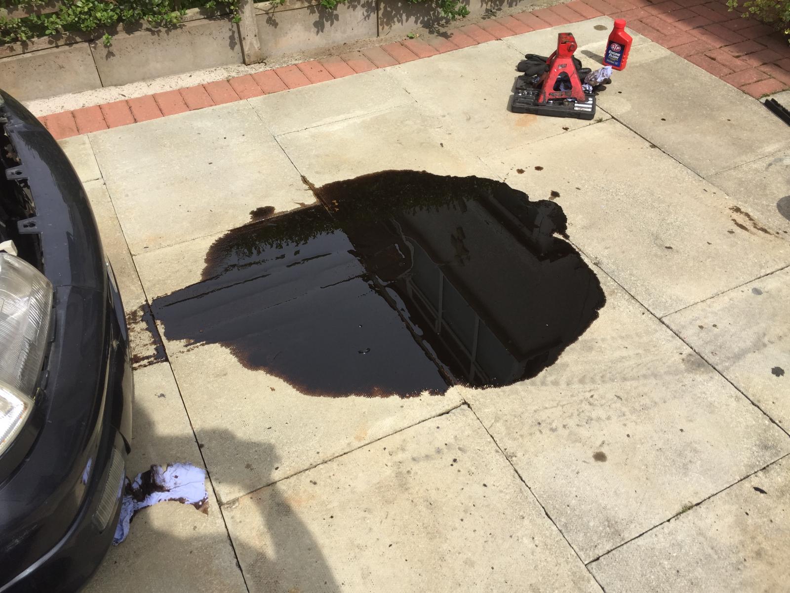

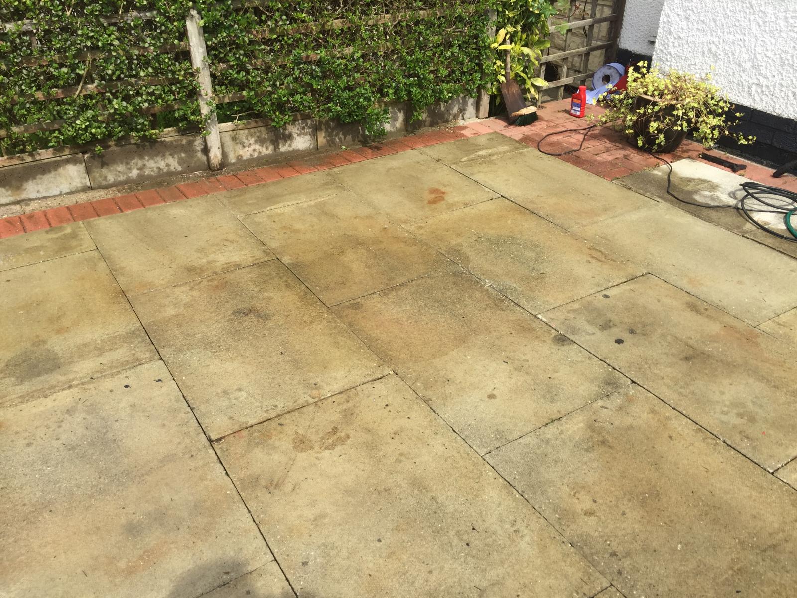

A bag of kitty litter, sawdust and 1/2 hour with jet wash. I didn't spill any with half the engine out, but my Halfords oil drainer couldn't hack oil so it went over the sides when my back was turned.
I've done that when the sump plug has dropped in the tray and blocked the hole in my Halfords drain pan, mucho mess
...and here's how it should look...

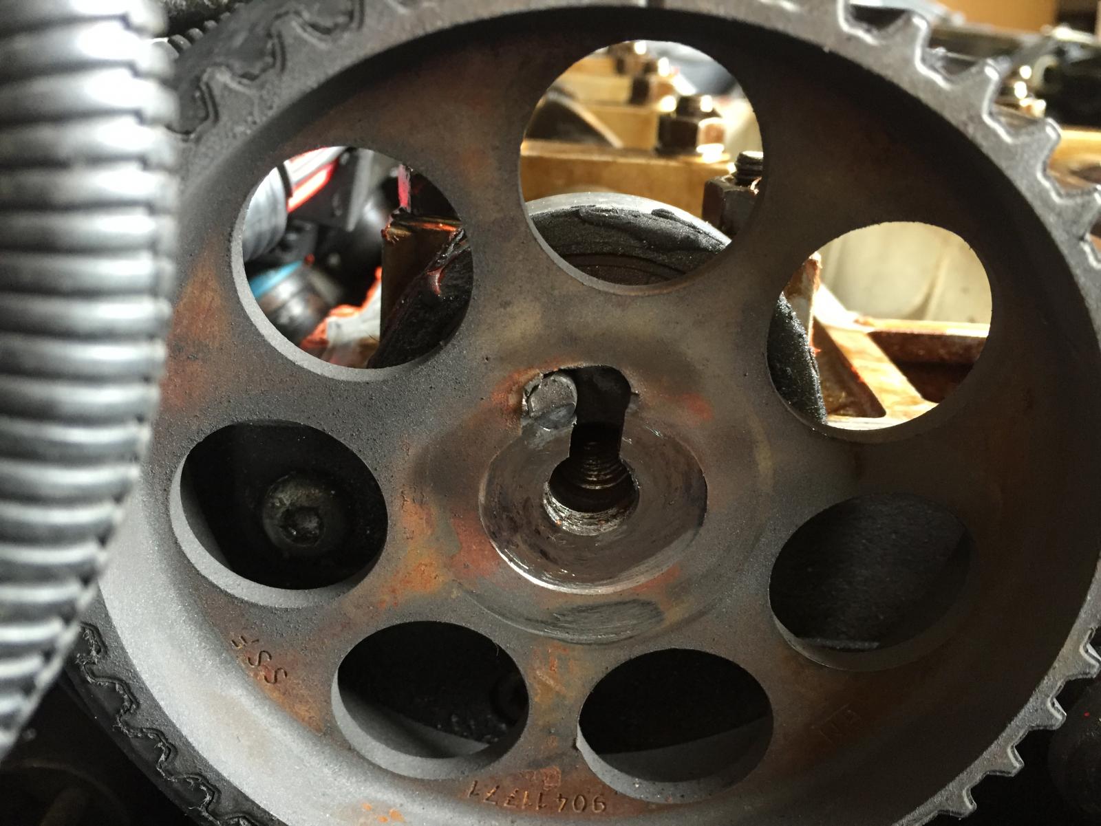

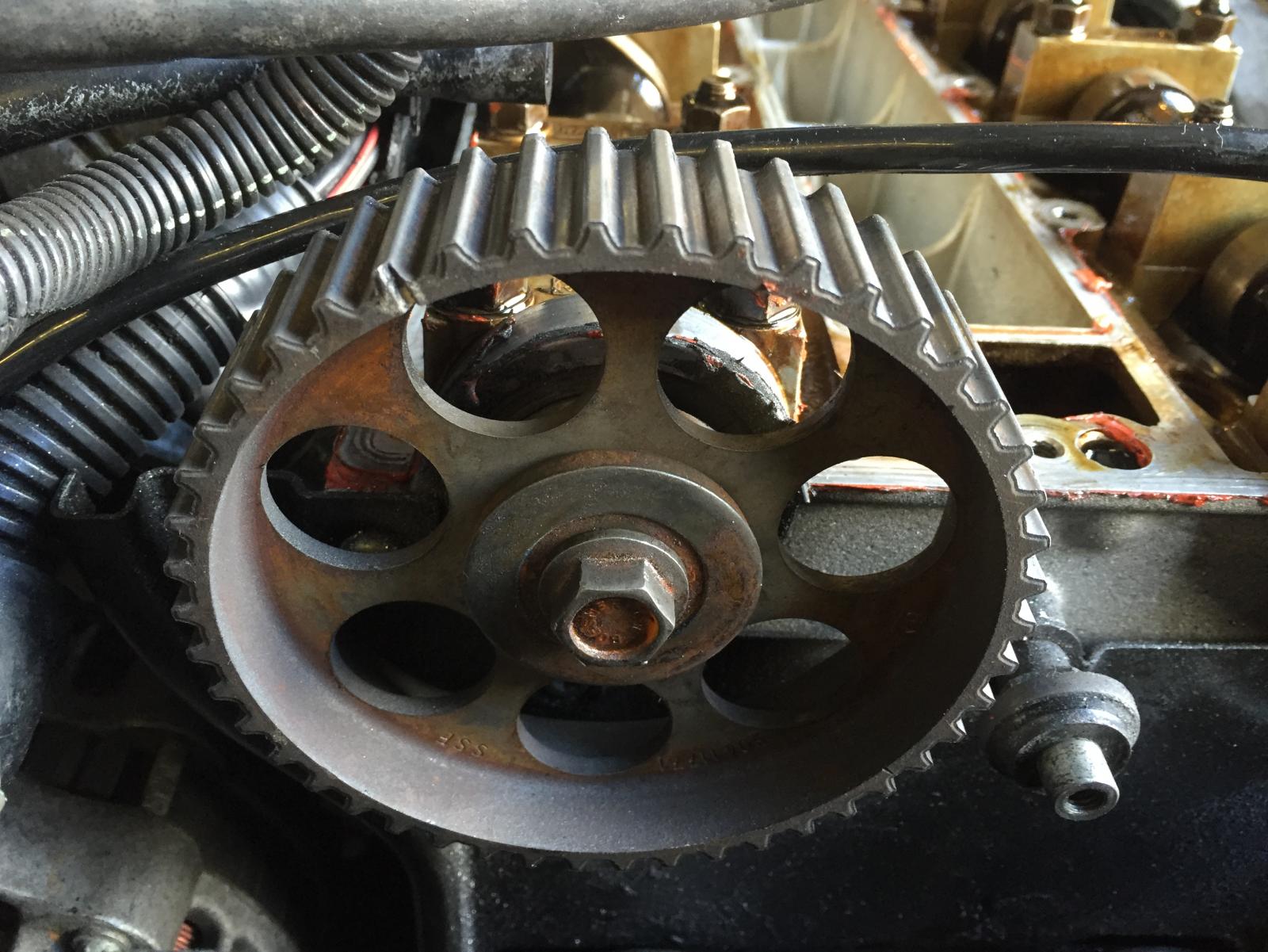

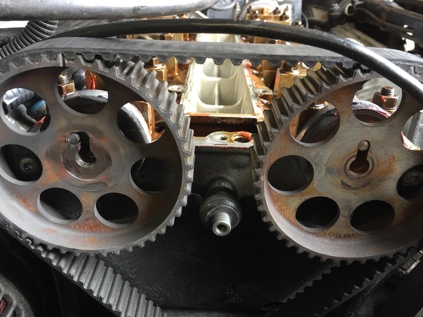

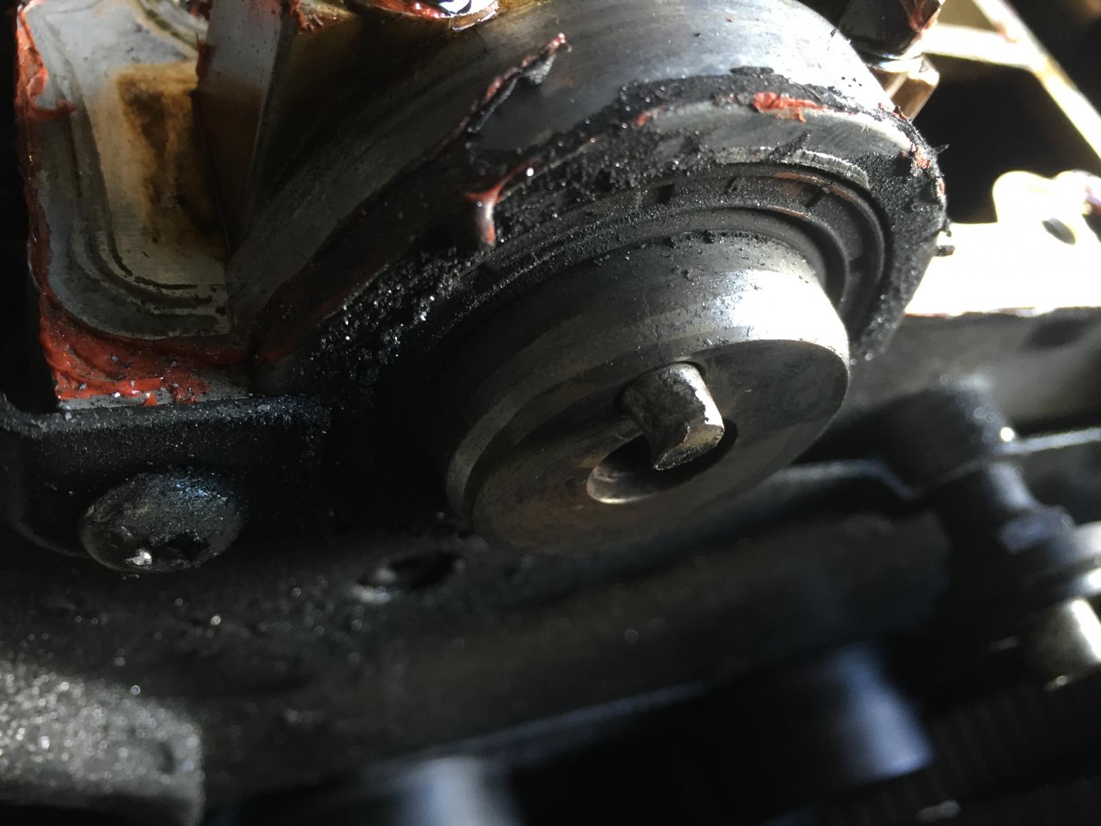

Crazy engine rattle is down to this. Both cam bolts torqued up and were tight when I removed them, cam had moved about 20 degrees out, but no damage to head I think - reset everything and it runs fine. Key on end of cam had hammered through the pulley, check out the timing angle of the left pulley. Shaft and pulley on shopping list.
Oof, must have been left loose at some point  :?
Glad you've sorted it now!
I think one of the lifters locked/seized tbh.
Ooft. That looks nasty. Glad you've caught it in time.
