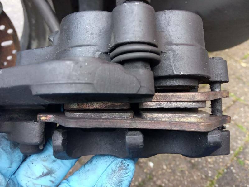

Time to see how much work this C1 represents, then. First stop is the inoperative front brake. Laddo claims he'd put new pads in it... whatever, the front wheel is pretty much stuck solid, and the lever pulls back to the bars. Let's have a look:
The pads weren't seated correctly in the caliper, so they were never going to work properly. They aren't new either; presumably he took it apart to check the wear and gave up on the job when he couldn't turn the front wheel any more. GR8 JOB M9. The Brembo caliper looks in pretty good nick, with the exception of several chunks taken out of the centre of the pistons. Fuck knows why, and I'm not even going to try and guess 🤣
Pistons cleaned and lubed with a bit of red rubber grease, pads cleaned and re-seated properly and the seized sliders cleaned and greased... suddenly things are looking a whole lot better. Added fresh fluid and bled it up and we now have a fully operational front brake. While doing that I found slight play in the front wheel bearings, so a pair of those will be ordered.

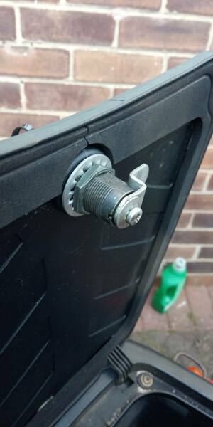

New ignition lock fitted... the steering lock was scraping because numbnuts had put this bracket on upside down 🤨
Battery compartment lock - changed.

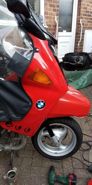

So. time to get the forks off the BMW, then... easier said than done! Three of the four Allen bolts holding the handlebars on eventually came out, with a little help from the blowlamp, but the fourth remains stuck. I've left it soaking in penetrating oil while the new 1/2" drive Allen sockets I've ordered arrive. I reckon I stand a better chance of shocking it into moving than with the 3/8" ones I was using today.
That job on hold, I turned to removing the fork legs themselves which threw up another problem. Some C1s don't have an Allen head in the middle of the fork leg bolts to stop the whole lot turning... yep, guess what type mine is! After throwing it out to my fellow 'shiters I went for the impact wrench, which didn't disappoint.

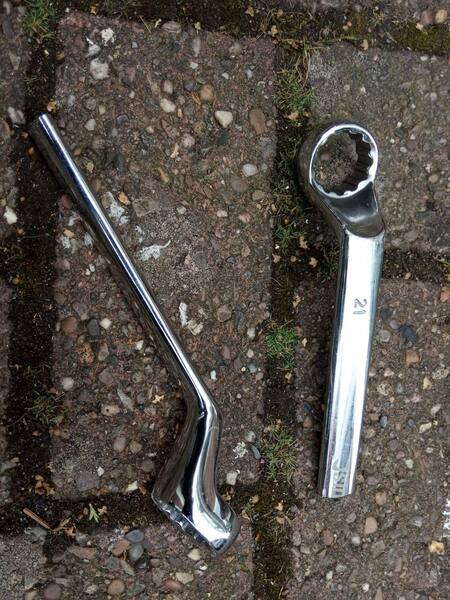

Tomorrow's first job is to bend a 21mm spanner so it can hold the lower fork nut while I turn an 8mm Allen key, which should (finally) release the forks.
Can we bend it? Can we fuck. Plan B, then.

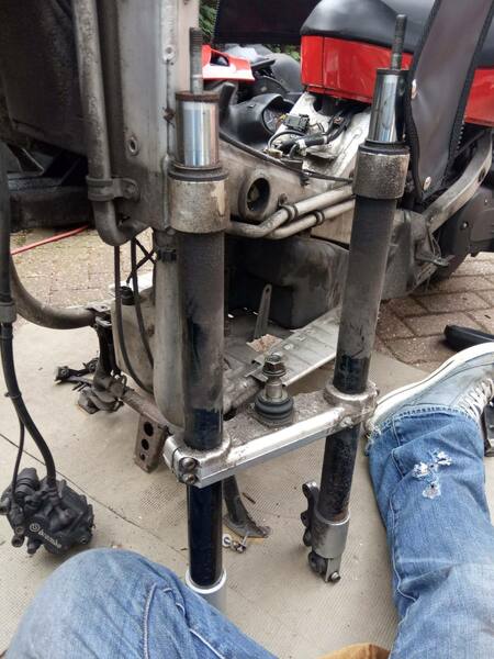

The nut's well tight, though, even after heating it to break the threadlock as the manual suggests. Plan C then - off with its nose!
That's got the bastard!
Finally! Now to strip them and see what I need to buy. Brew first, I think.
