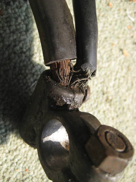

strangeangel Posted April 26, 2020 Author Posted April 26, 2020 So I had bother starting the Ami on Friday morning, the battery would barely turn the engine over and had to be given ten minutes on the charger to get it going. It hadn't been run for a week, but being the suspicious type I took a multimeter with me to check the car was charging the battery OK. About half way round a quick 10 mile hop it was stuffing 8.2V in! I asked some shiters, and they said clean everything before going any further. This defo needs a clean: There are two earths attached to the -ve battery terminal - one straight to the body of the starter, and one to the gearbox. The latter wasn't the best: Using the crimp tool I bought for the Aixam I made a separate terminal for the secondary earth. I didn't like how the live battery lead is routed; a previous owner had wrapped a bit of tape round it, but my paranoia is such that I cut a piece of scrap hose to protect it from chafing. Better. When I tried it, the starter spun over as quickly as it did when I got the car. I'll be keeping an eye on the charging, though; if it is charging at 8V+ then it would seem that I need a new voltage regulator. Incidentally, I checked the electrolyte in the battery, and it was only slightly lower than the top of the plates. All topped up now and back in business! UltraWomble, chodweaver, Coprolalia and 1 other 4

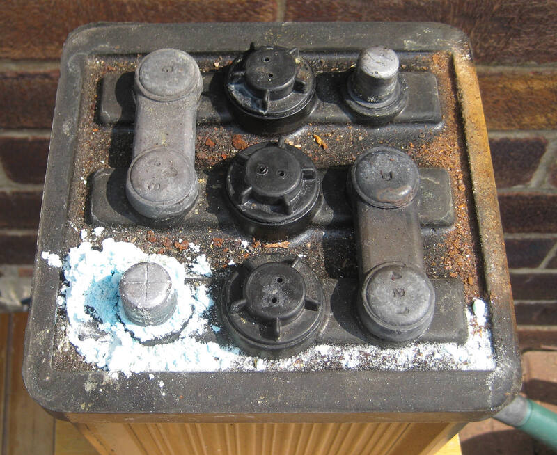

strangeangel Posted May 1, 2020 Author Posted May 1, 2020 Sadly the Ami's starting problems have continued, to the point where it now doesn't. Poking around with a multimeter has revealed that the the voltage regulator has allowed overcharging of the battery, which has killed it. I've been umm-ing and ah-ing over the possibility of converting the car to 12V, but I think I'm going to bottle out and buy a new battery and a solid state regulator instead. Tamworthbay 1
