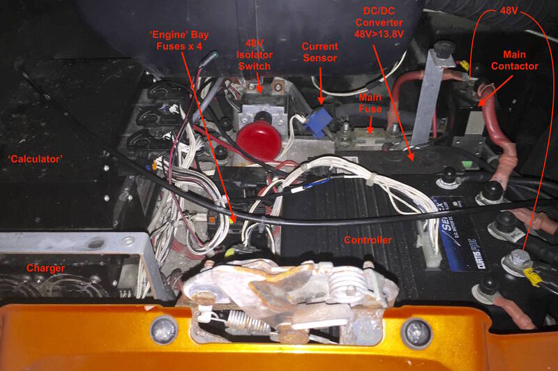

Today's efforts to try and work out why my Aixam won't go weren't particularly successful, in that I couldn't see any obviously burned components under the bonnet. I thought it'd be a good time to take the battery charger off and see if that can be repaired:
Someone's already been in it by the looks. Meanwhile, this:
is what's been charging the traction batteries in its stead. Excitingly* this was full of water, as was Aixam's tragic bellypan fashioned from soundproofing mat. This has worked about as well as you might expect; it's excellent water retention properties meant that the bolts holdng it to the frame were extensively rotted - with most having to be cut off - and lots of rust on the frame itself.
I think the next step is going to be the removal of the motor and getting it tested somewhere. With that in mind I've taken the front bumper and the soundproofing mat inner wings off... don't think it should be too bad a job now.

Small progress on a couple of other fronts was made today... I've always fought shy of doing any jobs where the instructions begin 'remove the dash', but today I solved the issue of the Ami's non-stop wipers by doing just that. Six self-tappers and thirty seconds later and it was off! Park wire yanked from motor, reassembly is the reverse process of removal and job done. I even remedied the Autocruise's latest electrical faux pas, but I'll probably write about that in the caravan thread once the switch I need has arrived.
  • Like 6
Electric motors... especially big ones...are usually pretty reliable.
First thing I'd suggest doing would be to take that terminal off, clean up the mating surfaces of the ring, and reassemble it.
If the motor was pulling excess current, you'd expect both terminals to be showing the same distress.  If only one has got toasty it suggests to me that there's a high impedance connection there.

If there are any more terminals like that it would be well worth undoing, cleaning and resecuring all of them.
Given the currents involved here *anything* that's presenting resistance electrically is bad news.  Will only show itself when under load too...which may well explain why she's so lacking in grunt.
Yeah, after what you said I was starting to think that it would be a good idea to clean all the 48V connections. Happily it's pretty basic stuff that even a mechanical primate like me can follow, and there aren't that many connections to worry about. After the isolator switch there's a mahoosive relay and then the speed controller and wires to the motor itself. Here's an annotated diagram provided by a kindly soul on an EV forum (he has two electric Aixams!) that shows how these things hang together:
