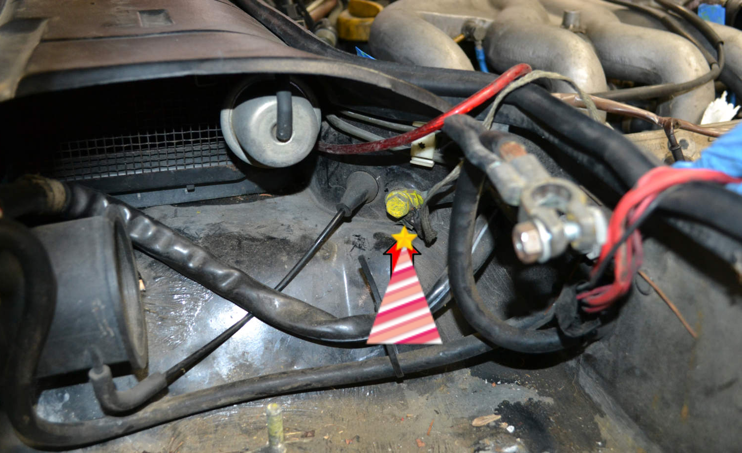

It will almost certainly be the braided earth lead pictured here. It may well be so badas to need replacing, they tend to get very ddamp and corrode.
So then..... What did you do with the clown, after stealing his hat?
TS
Battery terminals are secure & I don't have the lead with the clown's hat, my battery is in the boot.
I'll go back & have another look at where the braided earth lead does actually earth.

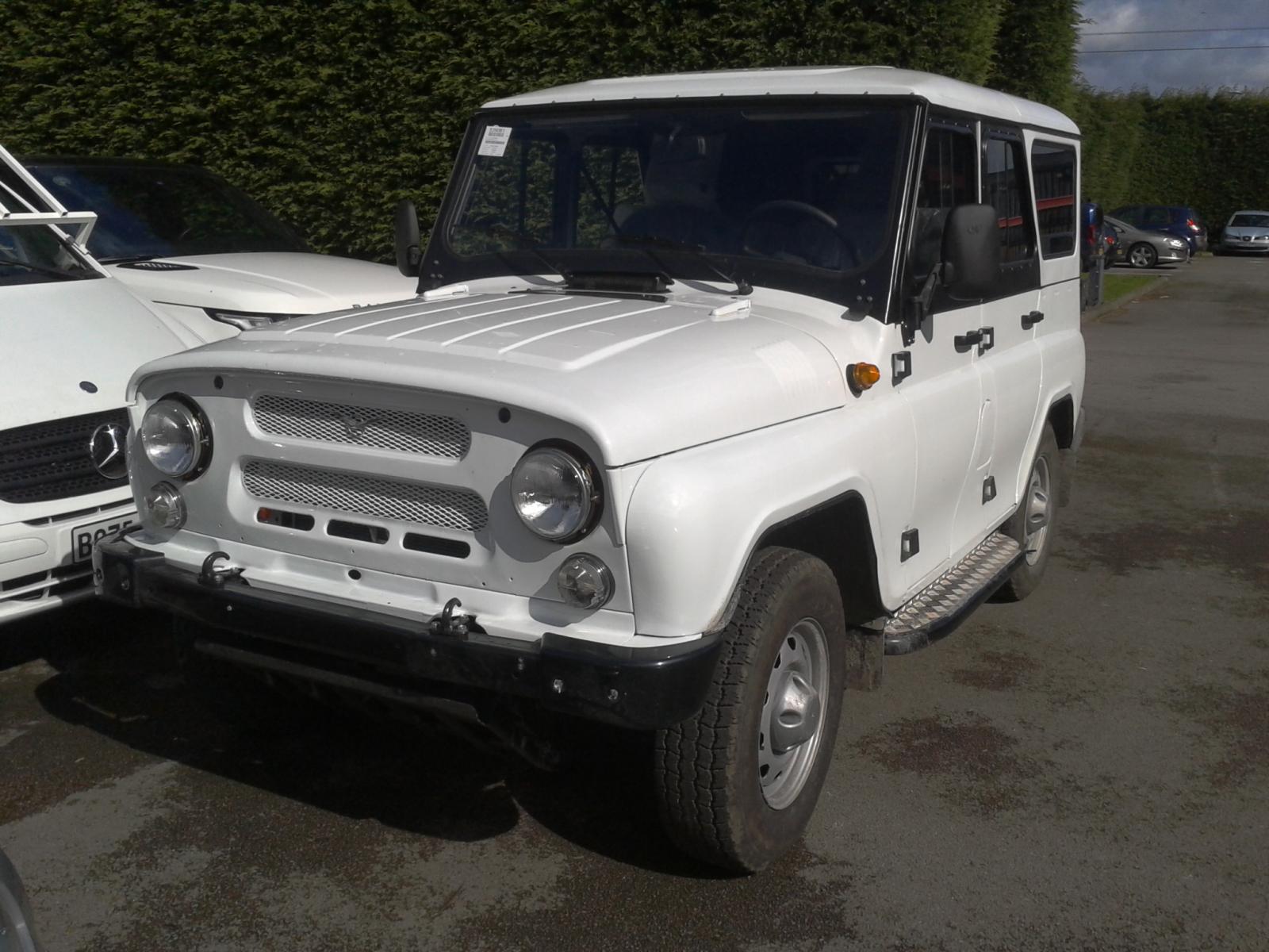

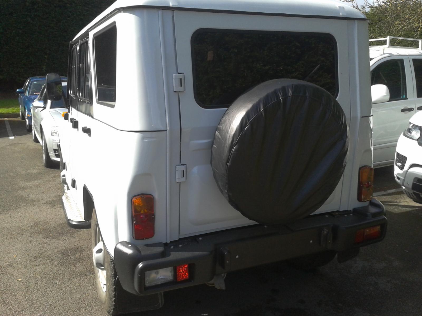

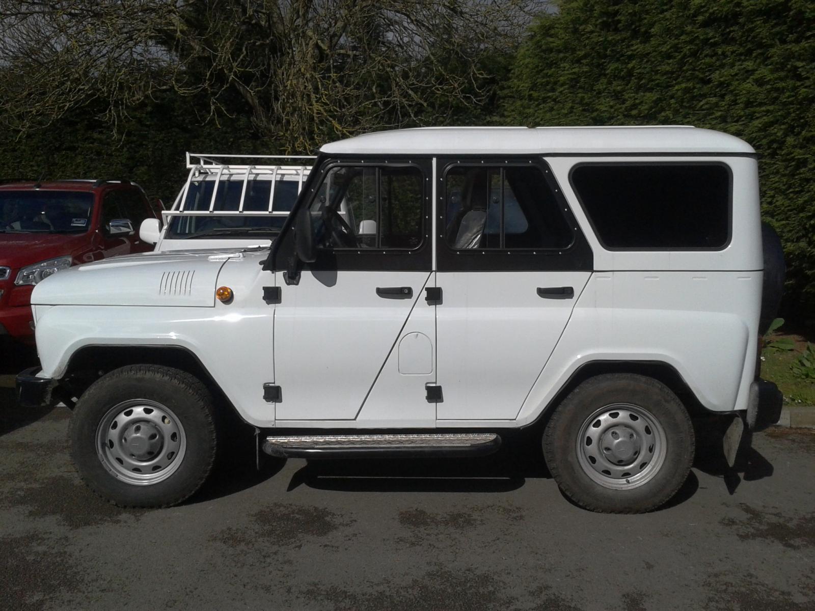

In other exciting news, what the actual fuck is this?
I have not a single clue.
Chinese?
