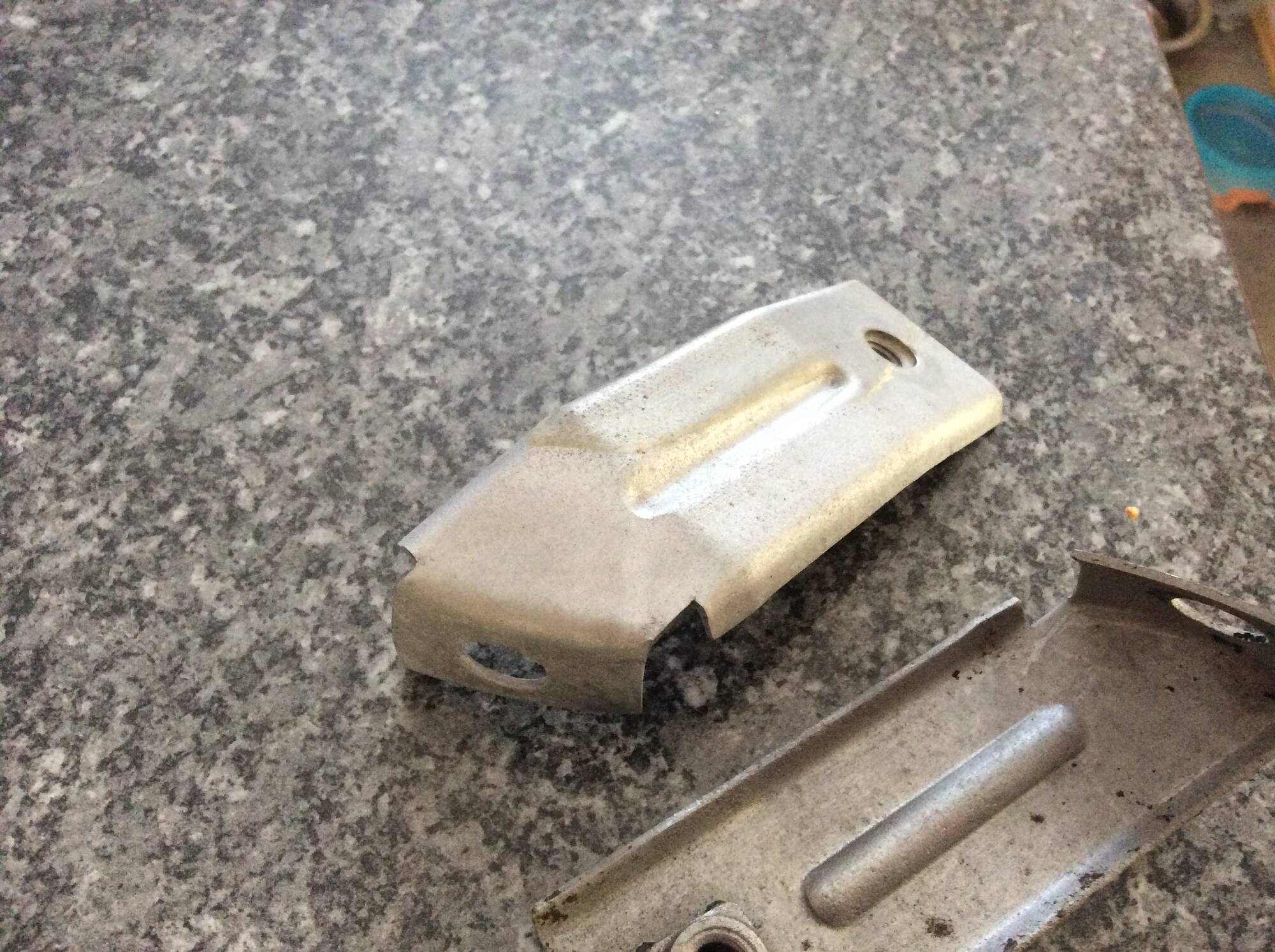

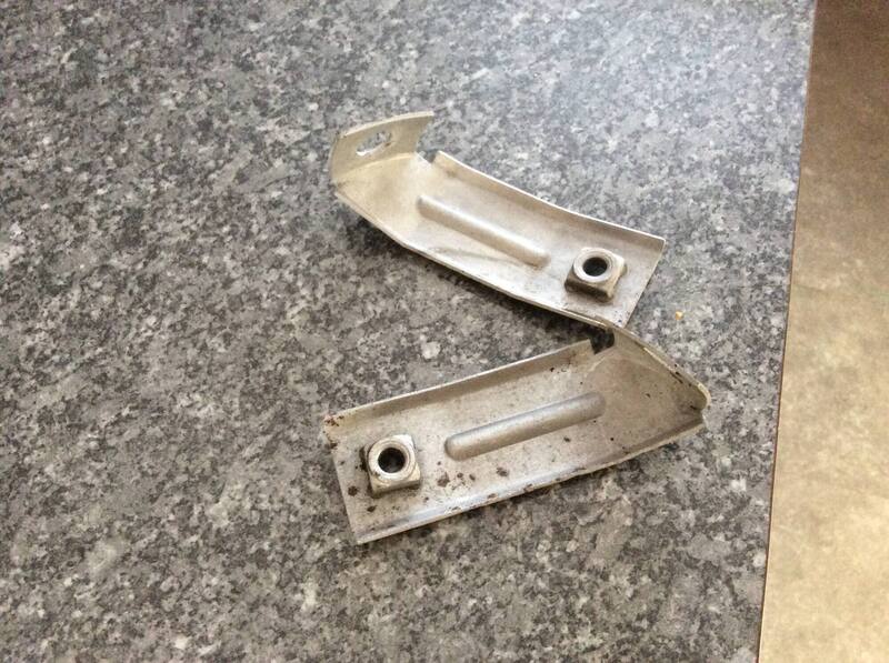

Im chemically stripping the rust and grime off the bumper irons, corner brackets and front number plate brackets at the moment. I’ve chosen the best ones off my other two sets of bumpers so they’re a bit of a mix! I know you won’t see much of these parts but I want everything to be in the best condition it can be regardless. The bumper irons were a bit of a tough choice as one of the left hand ones was very rusty and the other left one was slightly bent! I’ve opted to straighten the bent one and use that so hopefully it’ll let the bumper sit right still!
Oddly, I’ve found that there’s actually two different types of front number plate brackets. The two I’ve chosen to use (from my original bumpers) let the plate itself hang down almost beneath the bumper. The other type (on the scrap yard bumpers) let the plate sit fully up directly in front of the bumper. No idea why they made two types! I prefer my original type tbh, as you can see more of the chrome bumper!
They should all be painted by today so hopefully tomorrow I’ll be able to fit the bumpers to the car.
Got more done today.

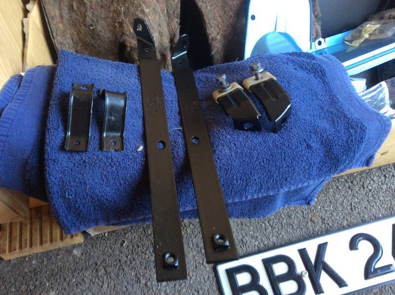

Firstly though, the front bumper irons, corner brackets and number plate brackets are all clean and freshly painted now but (I forgot to take a before pic!) when first removed from the old bumpers they were all filthy, and very crusty rusty horrible looking things. I wire brushed them down and cleaned them up by hand then dumped them into a tub full of POR15 rust remover solution. I’ve used stuff like this before, and while they all work to some degree, I’ve never had a result like this!
This is how they came out of the tub after being left in it overnight.
Almost every trace of rust gone! And it even managed to lift off some of the stubborn remaining old paint too! Good stuff.
Heres all the brackets etc finished and painted ready to go back on.
And the old number plate salvaged from the original bumper.

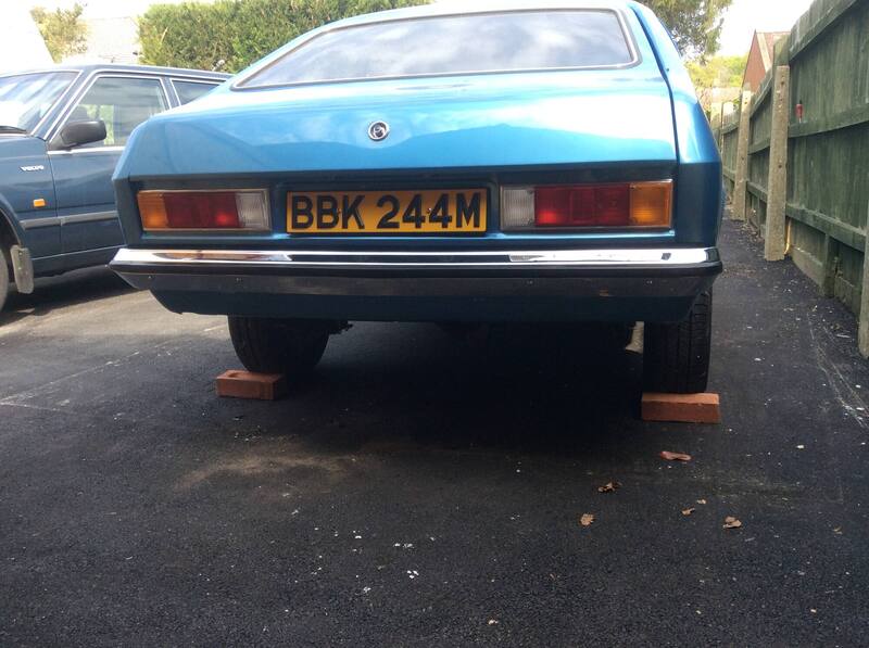

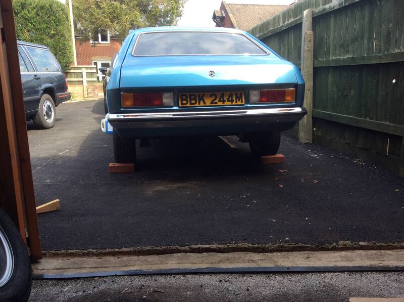

Rear bumper first. Dead easy this one, four nuts with a big penny washer and spring washer on each. I’ve greased all the threads too. Just in case!
Next I was waiting for the last few bolts to finish soaking in the rust remover so while I was waiting I decided to fill the cooling system with ready mixed blue antifreeze. Obviously I can’t bleed it all properly until it’s running (not long for that now hopefully!) but I’ve filled it up, squeezed all the hoses to burp air out and left it full. First time it’s had coolant inside the engine in four years!
No leaks either so far which is always good.

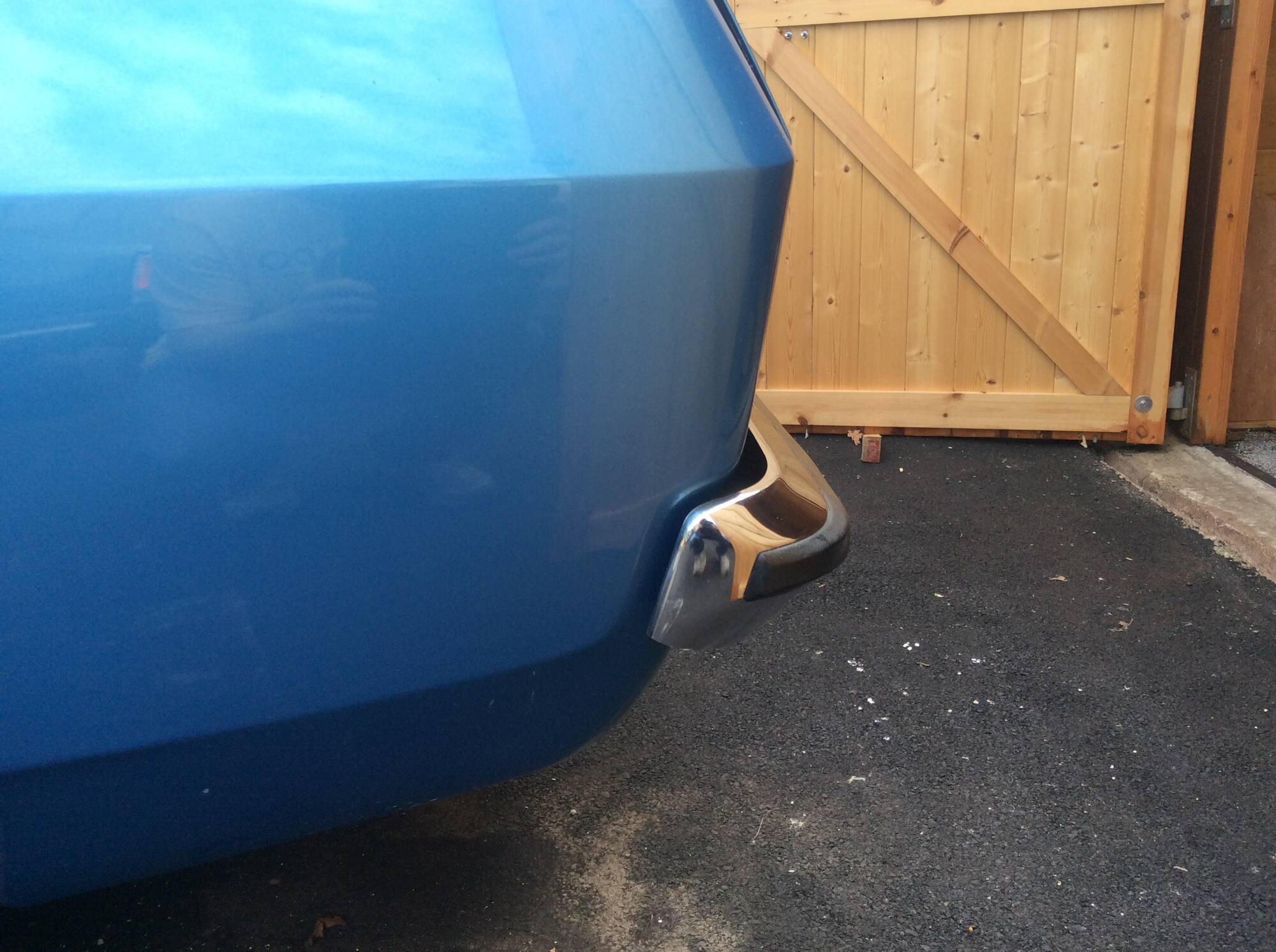

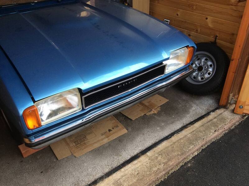

Front bumper now.
This was a pig to fit! The big bumper irons went on easy enough. They just bolt to the sides of the inner wing/chassis with two bolts each. Getting the two corner brackets on and lined up with the holes for their bolts on the wings was a nightmare. I can only assume this is down to the front end being a real mix up of new panels (all genuine Ford though) and possibly also the bumpers being from another car and the brackets and irons from about 3 different cars! I guess it just takes a bit of trial and error to get all those different bits to go together properly!
got there in the end but the nearside corner didn’t half resist my efforts!
Once again, all the bolts and threads have been greased. And I’ve painted the nut/bolt heads in black too so they don’t rust and look ugly.

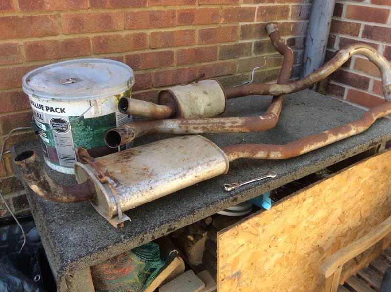

Im not sure yet what to do with the exhaust. I’ve still got the one that came off this car which is in really good condition but it’s got a fair bit of surface rust on it. I’m tempted to just clean it up and reuse it tbh. I know it won’t be up to the standard as everything else but it’s only an exhaust! It’s going to go rusty again regardless and will do even if I buy a new one. Not sure yet!?
The engine hasn’t been run for about 4 years, but has been stored dry and well. It’s had loads of work done and been cleaned up. It’s got new seals, gaskets and has had clean oil put into it. It’s been turned over by hand a couple of times too. When I go for the first start soon, should I put a few drops of oil down each bore first, then turn it by hand a few times, just so it’s not starting dry? I’ll be changing the oil immediately before trying to start it anyway so the top end will have fresh oil poured over it. Just wondering what’s the best way to go for the first start tbh!
If the exhaust is original Ford, I'd stick with it -in preference to 'pattern'.

The exhaust isn’t a Ford part unfortunately. It’s a standard mild steel non gen replacement system I got put on it about 10 years ago. It fits pretty well, has all its brackets etc still and it’s not rotten or anywhere near. It’d be good for several more years yet tbh. It’s just got quite a few patches of surface rust which I’d rather it didn’t have! I’m tempted to get a wire brush on a grinder and skim over it to get the worst of the rust off then give the whole system a blow over with some cheap heat proof paint. I’ve got some silver that I used on the exhaust manifold which would work. It’d only be a year or so before it starts rusting through the paint again though. It might just save me buying another new non gen system that might not fit too well.
Whats the thinking with stainless systems? I’ve never had one, but heard sometimes they’re not great?
You should waxoyl the exhaust to protect it ?

I'd clean the exhaust and spray with heat resistant paint, it lasts a while.
Stainless always sounds tinny and can fracture.

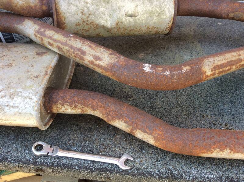

Here’s the exhaust after being exhumed from a pile of other assorted old parts.
It’s solid and nowhere near rusting through or failing any time soon, it’s just dirty and surface rust.
Ill get the grinder out tomorrow and give it a whizz over then silver heat paint. The brackets and clamps are all in good condition so I’ve stripped them apart and they’re soaking in the rust remover solution, then they can be painted the same. The big centre box hanger bracket will be replaced as I’ve got a brand new one already. The front pipe to manifold clamp is also good so that’s also being rust stripped.
I’ve had a dig through my tool chest, in the bottom is an old ammunition box full of junk I rarely use but won’t bin, and in it I’ve found a brand new front pipe to manifold gasket, and several brand new rubber Ford exhaust hangers (the little round ones with two holes through the middle). I’ve washed them and they’re as good as new so they’ll come in handy. They’ve been sat in that box about 15 years!

These two bumper brackets were in a right state when I took them off. Scaley rust and pitting from being on the front of a car over 40 years... the POR made them look like this after sitting in a tub of it overnight.
It does the job well, put it that way!
