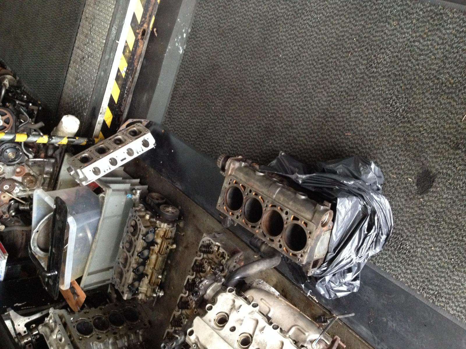

Dermist Posted October 2, 2016 Author Posted October 2, 2016 Sooooo, where to continue. Well there has been much fuckwittery on my behalf and a lot of hard work in equal measure. I left you last time with the block at the engine machinists about to be decked and the head skimmed. As you might expect when dealing with professionals this went smoothly and the hardware was returned to me in timely manor. The block was painted, cleaned up and ready to go. Machining by Lee Huggins, on Flickrmmm loverly. I thought before the grand rebuild would commence I would clean up the bores especially the one where some surface rust was on the faulty cylinder. So out with the honer and bosh. No, not cleaned up. Bosh bosh. No, still not there. Bosh bosh bosh. Bloody thing, remove the pitting! Anyway, after much boshing I gave up thought I would try the piston ring in the cylinder. Cock. The cylinder is now way over size. Cock cock, and the cylinder is still not fit for piston. Now I am looking at oversize pistons and OEM items are as rare as rocking horse poo, so I have to look at forged Pistons with an integrale scene tax (£500) double cock. Right, thinking coolly I have to get a second block and ya the original Pistons, speaking to various specialists they want big money for a block, therefore I look to the Dedra and Thema consortium and explain the situation I find my self in. Fear not! The parts guy on the end of the phone says we have plenty of blocks, and will be cheaper than other sources, woohoo says I, the only down side is I can't get it till the end of august but still, light at the end of the tunnel. (this is June)I spend the next weeks busily rubbing down brackets and rebuilding the head. Then painting brackets. Skizzer came over one day and helped remove the fuel tank and rear subframe causing even more chaos in the shed! Untitled by Lee Huggins, on FlickrUgh more work. The day of collection arrived and I travel up to Reditch to collect the replacement block. (This is now early September)Block back and initial visual inspection seems ok. Then one evening the penny sinks tragically thorough the sicky murk. This is the wrong block ! With the two side by side you can see that the original has a turbo drain pipe and the other has a virgin cast boss where a turbo drain pipe could go. Cock. Untitled by Lee Huggins, on Flickr A quick series of emails to the dedra consortium reveals the issue. This is a non turbo block but fortunately they are are all fundamentally the same, therefore drilling the boss for the oil return pipe will make put me back in the game! Let's go. With the block on the milling machine table, I wrung its neck to drill horizontally. Untitled by Lee Huggins, on Flickr M24x1.5mm (for Google txtbots) meant that I rapidly ran out of drills so I had to bore the hole out, Untitled by Lee Huggins, on Flickr Untitled by Lee Huggins, on Flickrand due to the position of the hole I couldn't get an accurate fix with a vernier so a gauge was made up with an undersize and sized boss to test in the hole. Gauge:Machining by Lee Huggins, on FlickrOnce to size the hole was tapped and the pipe screwed in. Sorted. Machining by Lee Huggins, on FlickrMachining by Lee Huggins, on Flickr Buoyed by this, I painted the block the wrong colour and mounted it proudly in the engine build stand. As a preliminary test, a mere, lets do it for interest test, I dropped a piston ring into the bore. Careful, gently squeeze, that's it. Perfect. Cock! The piston ring gaps are bigger than the other block! Cock cock cock ! Out came the bore gauge and yes, it is bored 0.4mm oversize. That means that the Pistons that came out if this block are very rare and valuable! Another quick call to the dedra consortium and yes, it would appear that it turns out it is a special block! So that block has to be returned. Why I didn't check the piston ring gaps start away I don't know. But it is too late to worry about that now, but I know now how to accurately measure a bore and drill a hole so it's not all been a worthless exercise! Replacement replacement block is being collected in two weeks time. Whilst I was waiting for the first replacement block Dermist senior and myself decided that a rotisserie should be this years must have car accessory and this would be an excellent excuse to make one for the Dedra initially (to sort out the under seal flaking off) and then for his Montecarlo. With a plan formulated and material bought, I went on holiday and left him to it. Returning, one was completed and the other to follow , he then had the poor manners to go on holiday which meant I could then paint the frame "broken Lancia block green".Machining by Lee Huggins, on Flickr Initial assembly and all is good. Untitled by Lee Huggins, on FlickrSecond frame arrived and assembled. Untitled by Lee Huggins, on Flickr Now began the tricky task of attaching it to car. So out came all the seats, boot, bonnet and carpet to reduce the weight and this is what we have. Untitled by Lee Huggins, on FlickrFrontUntitled by Lee Huggins, on FlickrRearCarefully the car was raised simultaneously (front and rear) until it could be rotated easily by hand to 90^. Voila! This photo sequence doesn't quite sum up 2days of drilling holes, cutting metal, welding, thinking and generally problem solving! So a massive thank you to my dad!The upshot of all this is that the underside of the car can now be easily seen and the verdict is.......Untitled by Lee Huggins, on Flickr Skizzer, cort1977, HMC and 15 others 18

DodgeRover Posted October 3, 2016 Posted October 3, 2016 Is it not possible to fit new liners to your original block or is it a plated bore?

Dermist Posted October 3, 2016 Author Posted October 3, 2016 Many thanks for your kind words, it really makes it worthwhile and continuing to fight the bloody car into submission! Regarding liners and cylinders, I haven't seen this mentioned anywhere on the Internet for these engines, that's not say it can't be done I just haven't come across it (yet). With the car in component form practically, if I think about the task as a whole, I do have a little panic attack. All I can do in the meantime is concentrate on one task and getting that sorted. This then leads into the next and so on. To give the project another dimension, my friend where the beta has been in long term storage has mentioned that he needs his garage back by the end of February. Therefore the dedra needs to be movable and waterproof so the beta can come back. Like I say. Small tasks. Oh cock, I've just had a mini panic attack! Thanks Dermist. billyboy406v6, Skizzer, chodweaver and 1 other 4

DodgeRover Posted October 4, 2016 Posted October 4, 2016 Last time I had a liner fitted it was about £80 including supplying it, being tight I only had the one done and never had any problems
