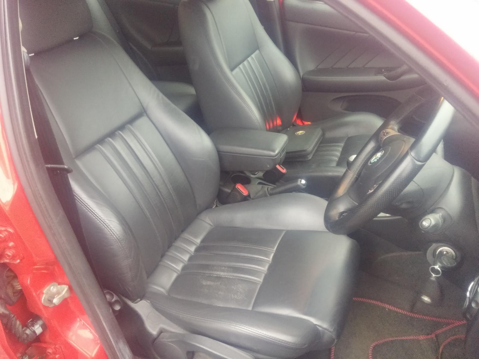

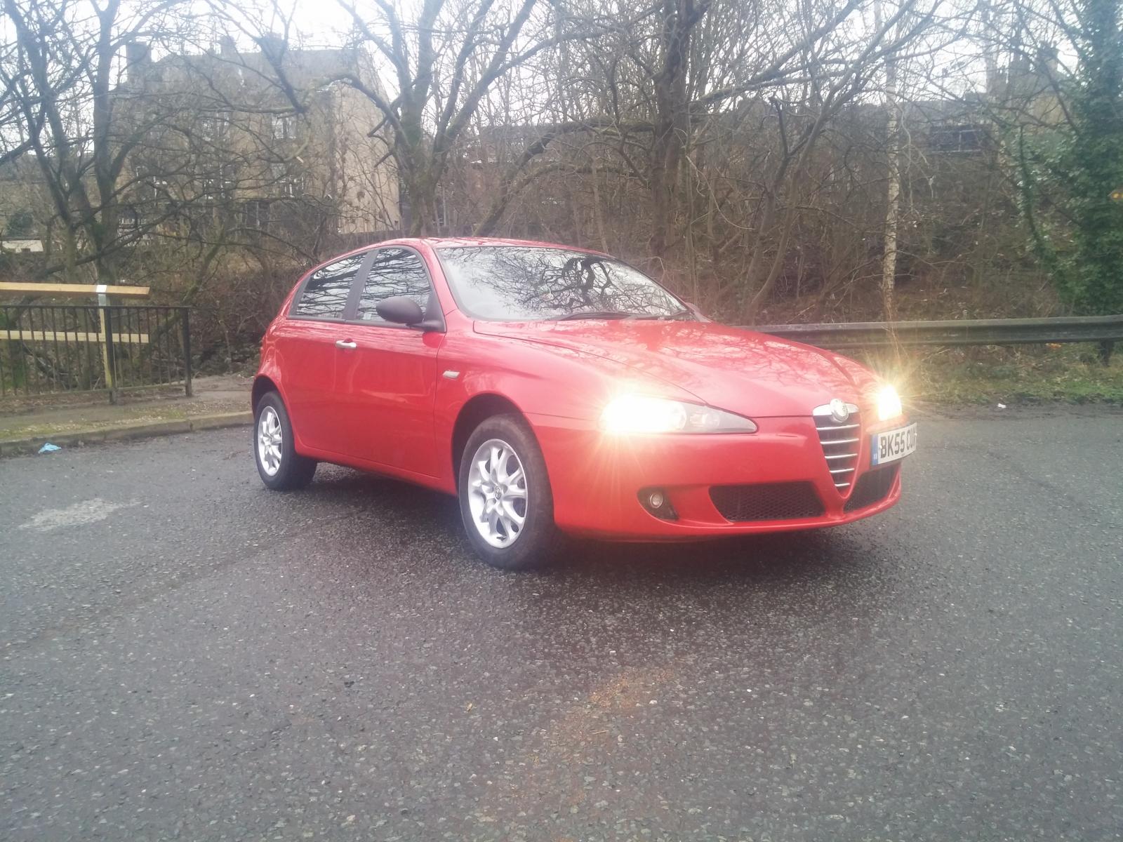

Here is our eventual prize, found on Swapz of all places. 55 plate, 103k, red paint with black cow interior. It's got nearly a full list of the mentioned 147 issues, gearchange is supa stiff and wishbones creaky, service book "lost" but it does drive well.
A 55 plater is a BRAND NEW CAR to me, so we were chuffed to get it for a grand.
I'll update if/when it starts playing up and I begin my descent into insanity/poverty.
That is a damn good looking car. Top bombing.

was about to post - dont buy a red one.........  all red alfas fade to random shades, and none of the panels eventually match lol
