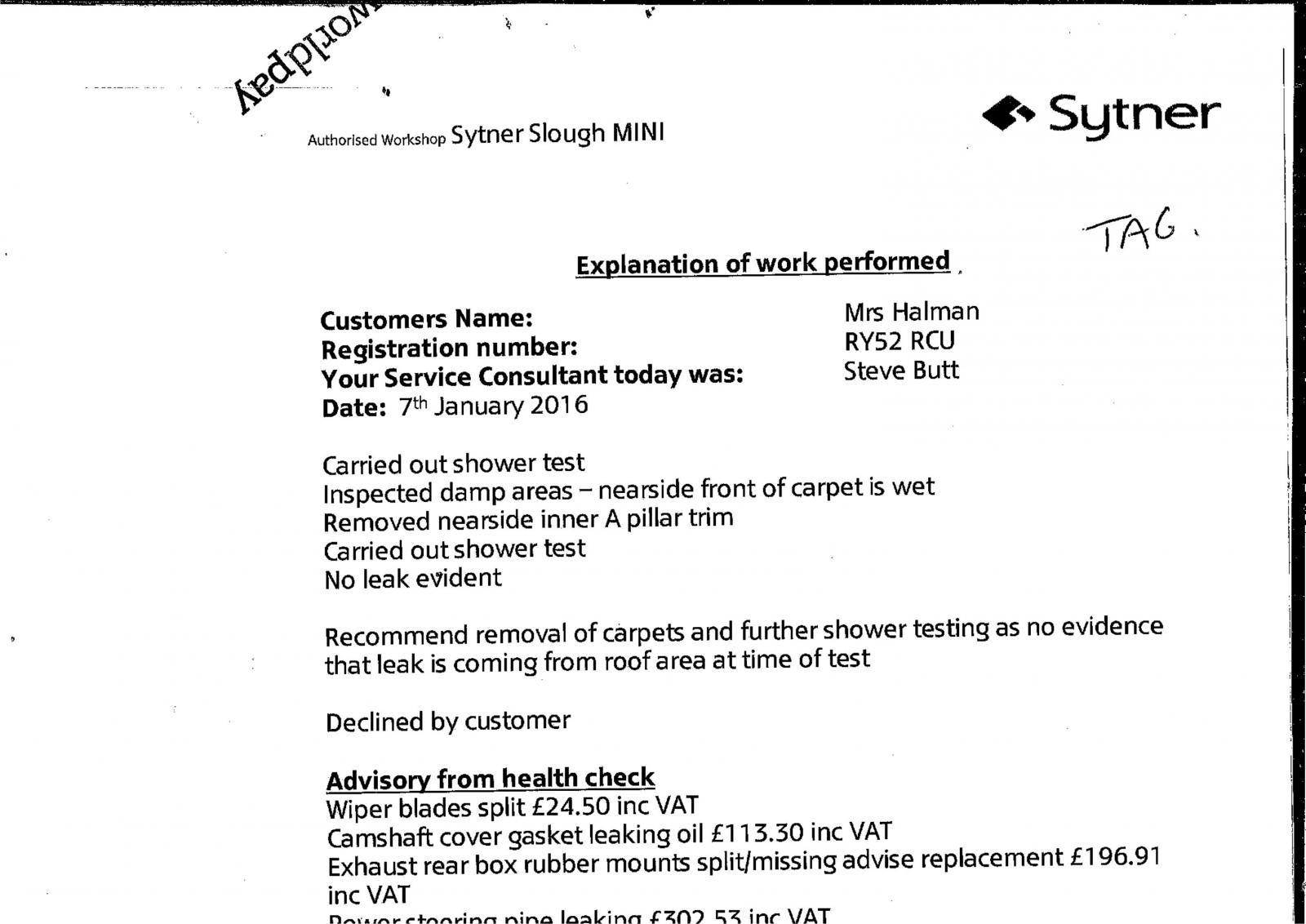

A woman in the office has been having issues with her 2002 mini of the water leak variety. It's been to BMW Sytner several times, who have sealed the aerial, but the leak came back.
She sent it in again this week after the heavy rain we had, the front footwells are wet. I decided to do some googling and work out what I think it is.
It came back yesterday, with 'unable to replicate the fault', and they had also done a healthcheck.

She then showed me this bit of paper
which I lolled at some of the prices for.
We worked out that:
Wiper blades - £9.99 for all 3 from ebay
Camshaft cover gasket - leave for now, check the oil a bit
Exhaust rubber box mountings are I think these http://www.ebay.co.uk/itm/BMW-MINI-ONE-COOPER-REAR-EXHAUST-RUBBERS-HANGER-MOUNT-SILENCER-MOUNTING-CLAMP-/271914057379?fits=Car+Make%3AMini|Cars+Type%3AOne&hash=item3f4f573ea3:g:5EQAAOSw9N1VjapQ
Power steering pipe looks weepy, but it never drips onto the floor so I advised just topping it up, I'll bring my bottle of fluid in one day
Brake fluid 'service'...how do you service brake fluid?
She paid the £50 for the time they had it, and got the car back.
I said I would book an afternoon off work when the weather was better and run it over to mums/fix it in the carpark, as I think the issues are a combination of
http://www.mini2.com/forum/first-generation-faults-fixes/133613-leaking-roof-cant-find-source.html
and
http://www.northamericanmotoring.com/forums/stock-problems-issues/188299-diy-a-pillar-cover-replacement.html
The parts arent too expensive from BMW direct, and she agree's that it's the probably cause as...
the leak is at the front (soggy headlining, water dripping onto the dashboard etc), and the aerial is at the back. The garage said the water must run across the headlining which I called bollocks to as the headlining would go all mushy inbetween the leak and the front of the car.
Still, it's the first time I've seen how main dealer work for a 14 year old car works. She said that if it does fix it she will ask them why they didnt look at that, since it seems a very common issue.
Anyone ever had to do the work in the links at all? Any top tips?
That looks like a monumental rip off there. 114 quid for exhaust rubbers?
Looking at the video of him wobbling them about, the ebay part is right. How much of a bastard getting the old ones off is yet to be seen, but it doesnt clonk apparently so my advice has been ignore for now!
they're probably charging 80 quid an hour so the cost of simple stuff soon gets expensive. Imagine getting a HG or clutch done by them?
Am I being thick or is 'camshaft cover gasket' a fancy word for the rocker cover gasket?
Correct

I do agree with you, and it's probably the labour rate that puts the price up, but this garage have tried 3 times to find the leak, and have not found it/been looking in the wrong place. Think the total paid is north of £300 so far.
I've just never seen the process before, it interested me

Why would you take a 14 year old car to a main dealer?
Should have taken a video of me doing the head gasket on the Reliant. Would have been on for about 60 hours and had plenty bleeps in it, after 9pm viewing i think.
Because she thinks (thought) it was a good idea. She's not poor tbh, and I think genuinely thought it would be the thing to do.
I've managed to show her by pointing at pictures and explaining that it's probably leaking from X and Y, running down P and fitting new seals to A and B, with some black sealent down D and E would sort it, and I'd happily take an afternoon off work and do it in the car park when the weather brightens up.
She was going to get BMW to put new tyres on too until I found her 2 Avon ZT5's for £88 fitted, then she got a quote from the tyre place over the road for £92 for 2 fitted, but without a 8 mile drive to get to the tyre place.
I'm slowly converting people to my ways! Why throw money at people guessing when 2 hours on google had it worked out, justified and costed. The parts from BMW are actually quite cheap. The A pillar external trims sit on foam pads, which every forum post I have read says replace. £8 a side. Plastic covers are £40 a side, but apparently they break, so we said we would take them off, if they go back on then great, if they break then she can just drive the car until new ones come and we will fit those.
