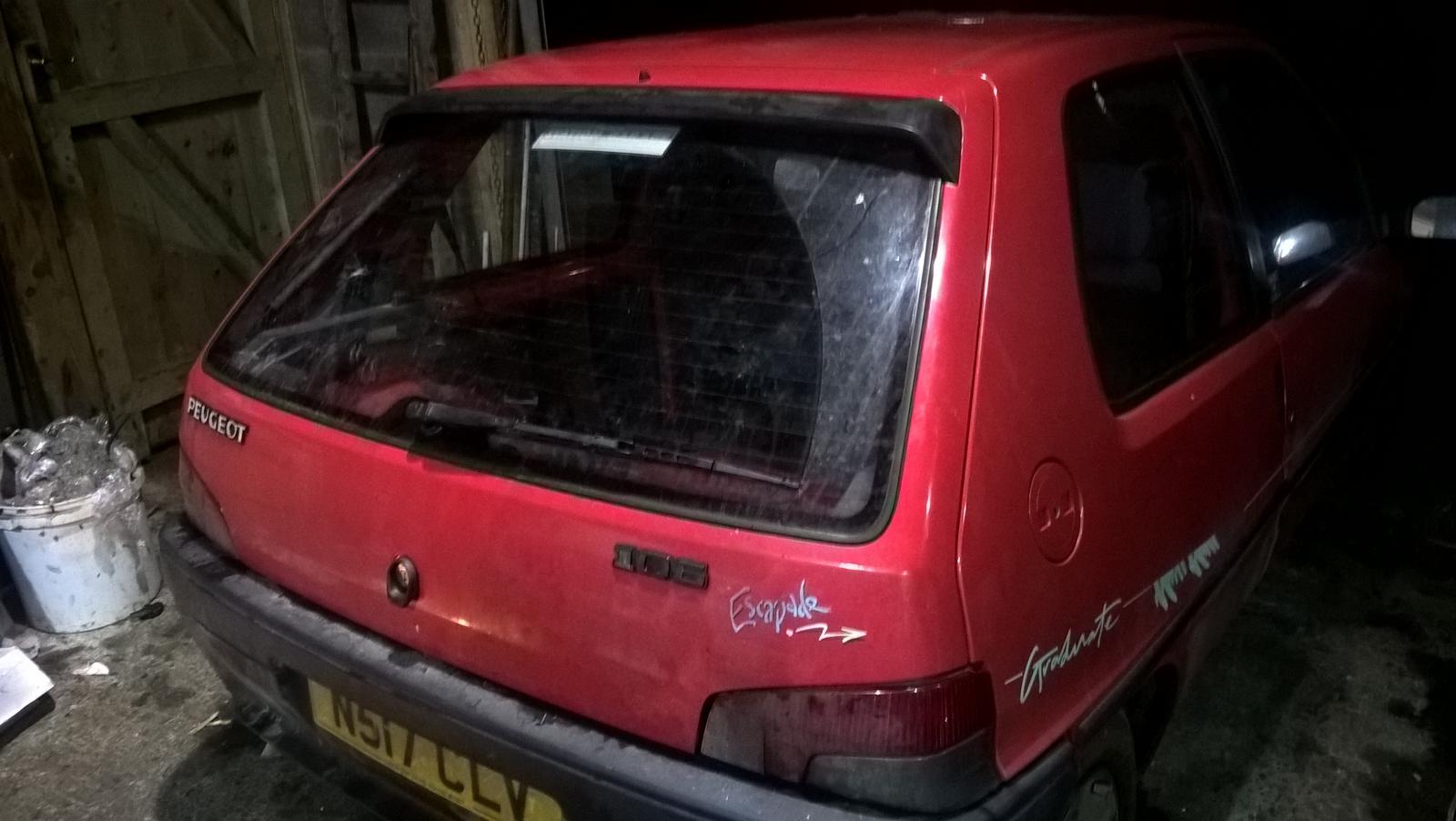

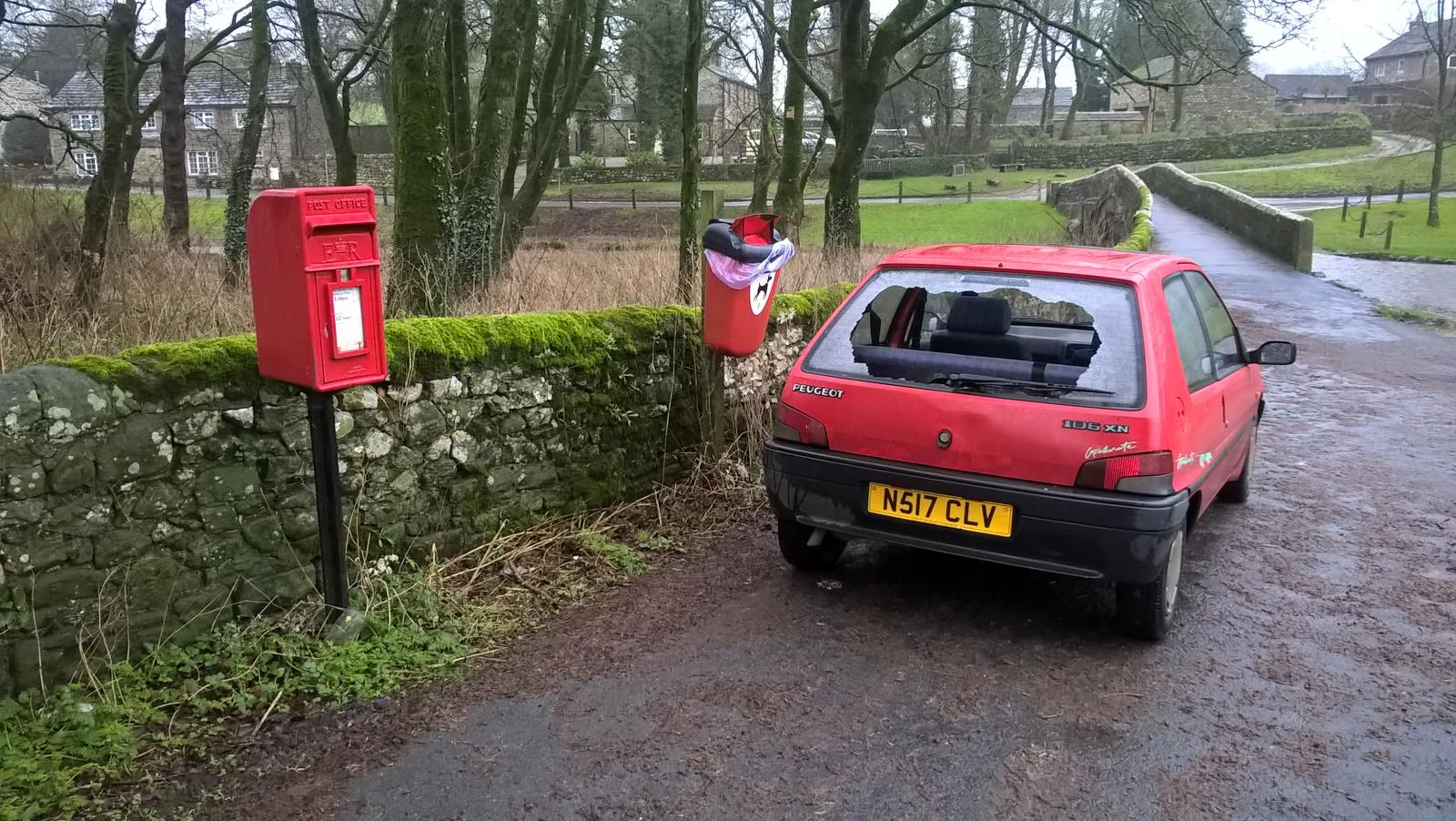

explosive-cabbage Posted January 6, 2016 Posted January 6, 2016 I'm in a bit of a pickle here and would have prefered to solve this problem away from Autoshite, as there is a story attached to it involving sex and a crazy french girl. But as it transpires early 106 Tailgates in Red are like rocking horse shit, I have tried eBay and the internet to no avail. Scrapyards are my last chance. So I need your help. I am searching for a Red 106 Mk1 / Phase 1 (known as S1) Tailgate, from a car registered between 1991 and 1996. I would like a red one specifically so it matches the bodywork colour. The car is very tidy as it is so I dont want to fuck it up by fitting a different colour tailgate. The phase 2 Tailgates are more curvy and do not fit round the phase 1 rear lights, though they can be made to fit if you swap the rear lights from a later 106, which I would prefer not to have to do as they look shit. Saxo lights and tailgate on the phase 1 106 is a no-no on the phase 1s apparently. I am sure the rear window glass alone would be difficult or impossible to replace. If you have spotted one in a Scrapyard anywhere please let me know! beko1987 and michael t 2

robinmasters Posted January 6, 2016 Posted January 6, 2016 WP_20160104_10_49_13_Pro.jpgI hope there weren't any misunderstandings while it was parked there. KruJoe and explosive-cabbage 2

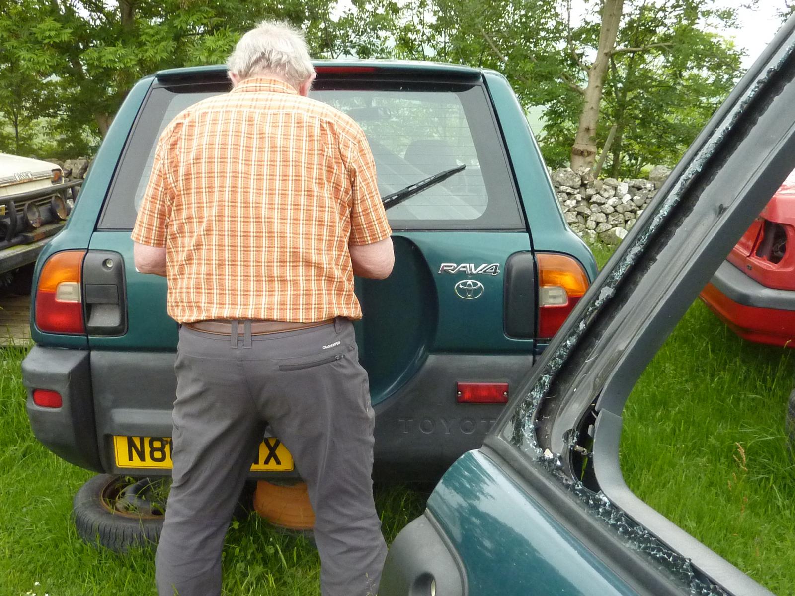

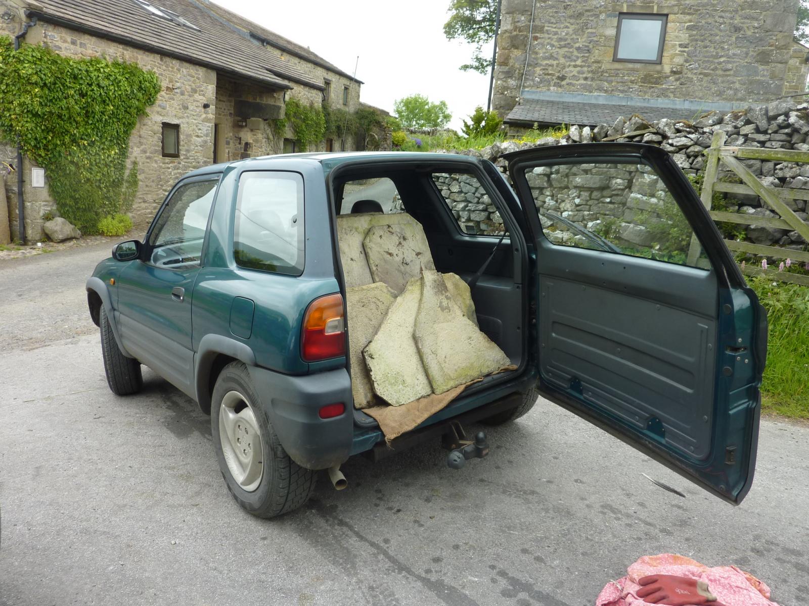

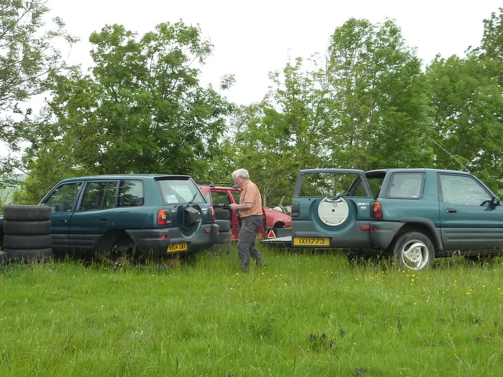

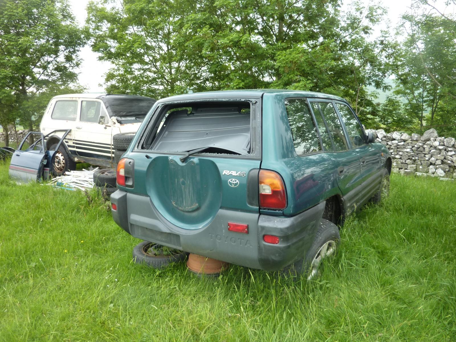

KruJoe Posted January 7, 2016 Posted January 7, 2016 Formerly at Castle_KJ_Cabbage... I did warn Pops_KJ that it wasn't a good idea, especially coming up our hill. Predictably we had to do the tailgate swap. All done: He does without the spare wheel carrier so he can fit his bike rack. Moral of the story: have a breaker with spec as close to your runner as possible. But the Bubbered Saxo was free so meh. I vote for swapping the glass from that one if it's the same shape. Lacquer Peel, Eddie Honda, Banger Kenny and 1 other 4

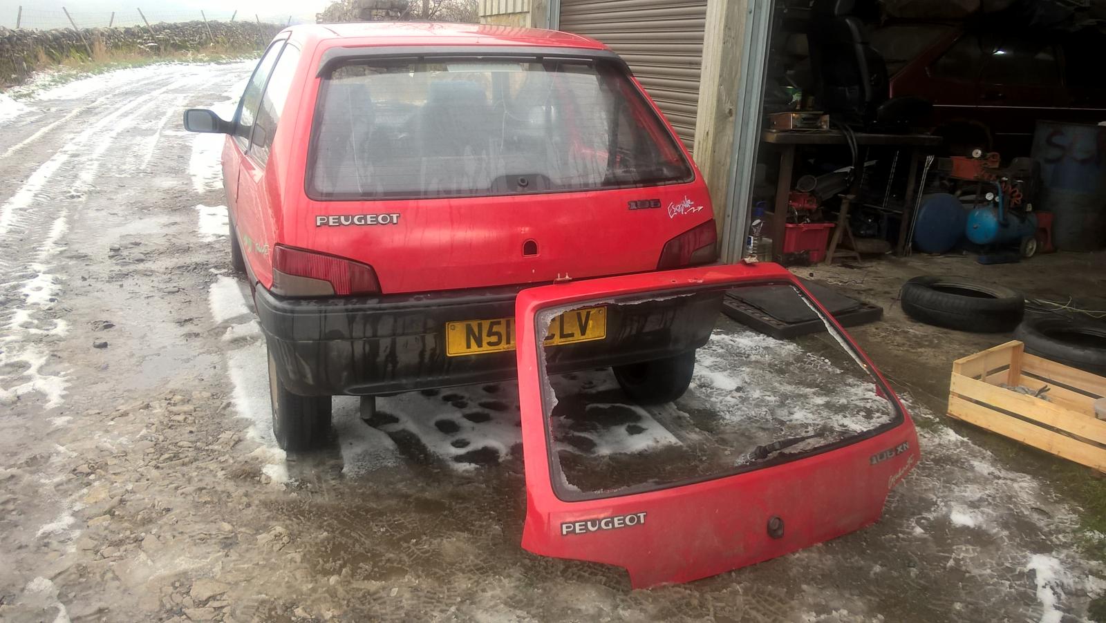

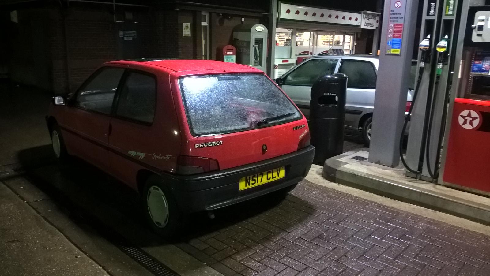

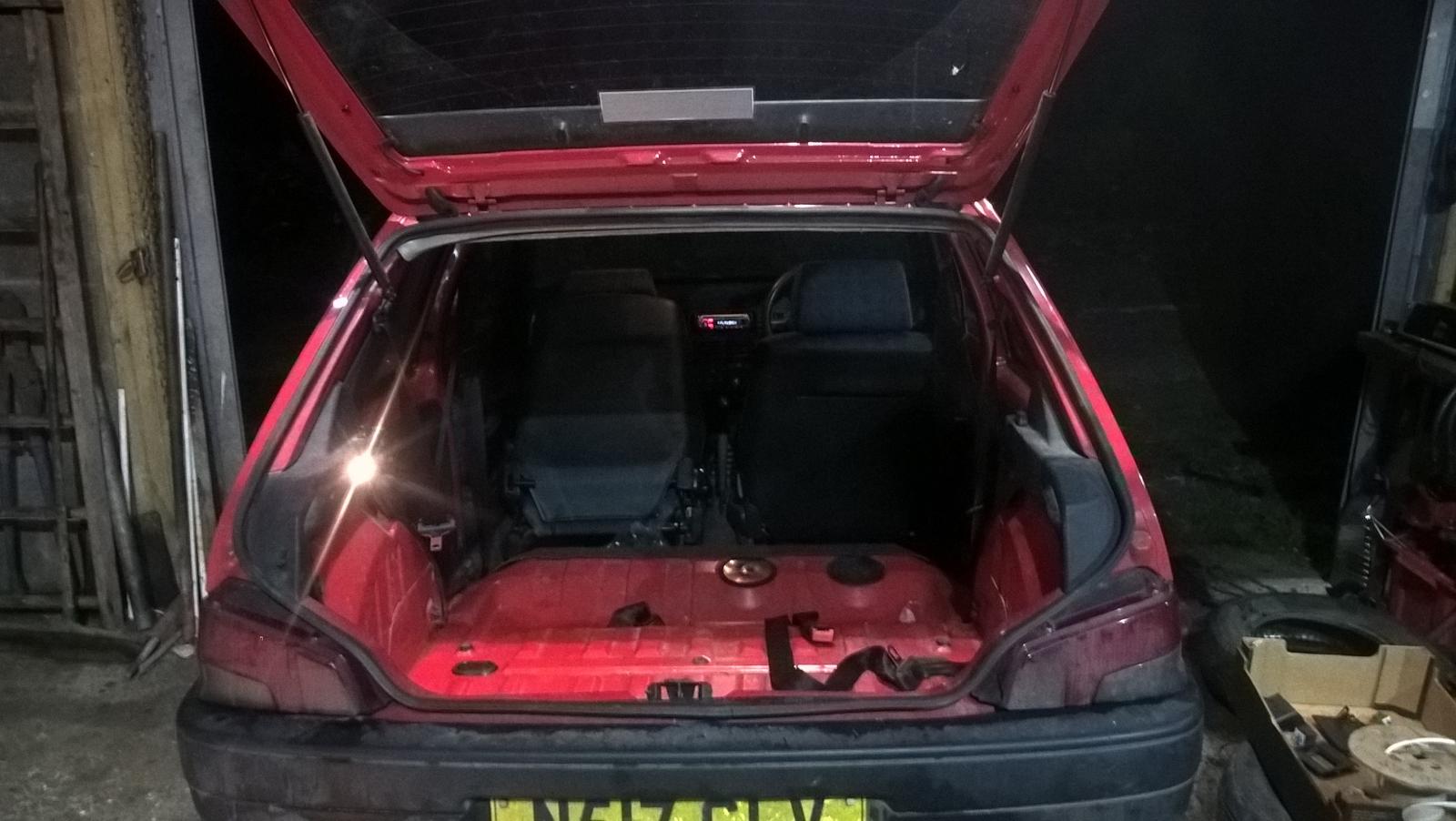

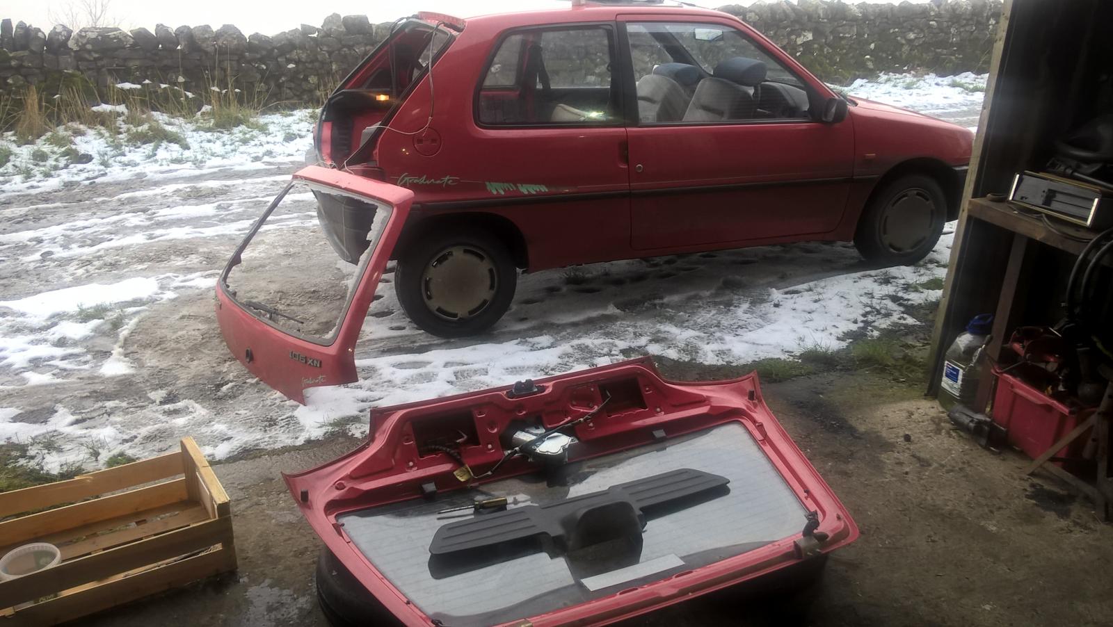

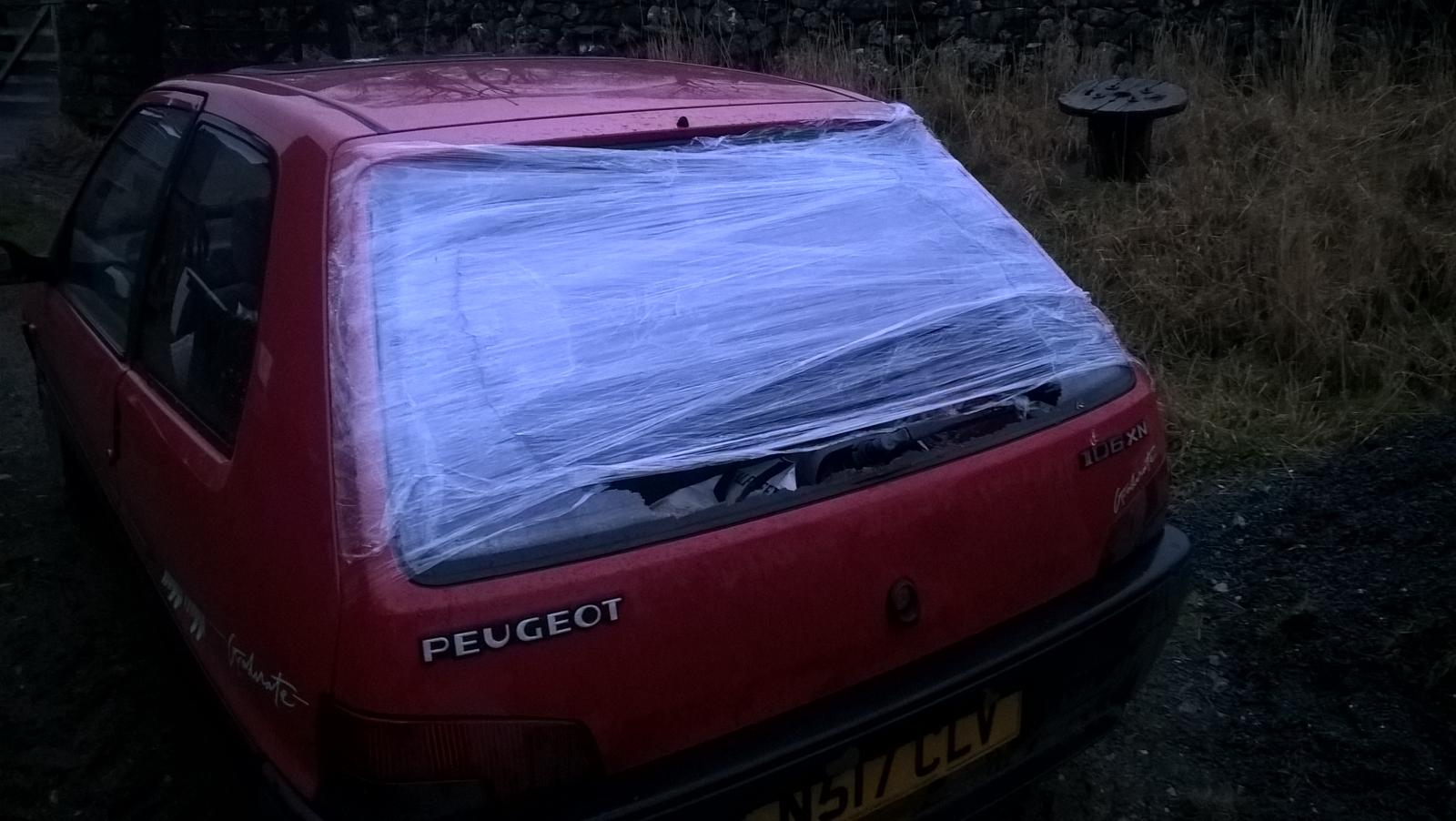

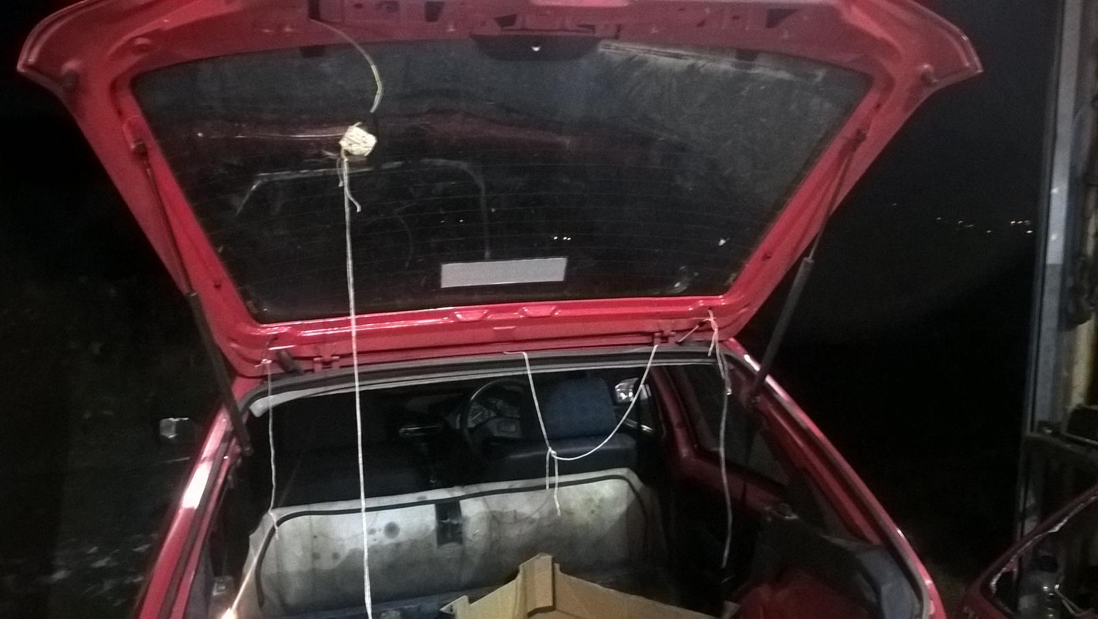

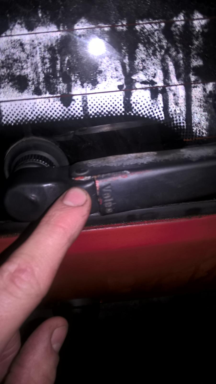

explosive-cabbage Posted January 21, 2016 Author Posted January 21, 2016 After hunting around for 2 weeks on the internet I found a red Phase 1 tailgate in Doncaster. I had wrapped the boot in cling film but that didn't last long! Me and my younger brother collected with his 106 on the way down to London last week to drop the blue 205 back with Arthur Foxhake. It fitted in his his boot fine and we got it home safe and sound. It is from an slightly higher spec 106 so it has central locking actuator and a spolier and different badgeing, but the colour is perfect. I took out the central locking and I've put that on eBay, and left the spoiler on because it looks okay. I pulled the wires out of both tailgates, with string tied to the plugs so I could pull the new wiring back through. There is nothing worse than a bodged, fucked up job because someone cannot be bothered to take 15 mins extra doing it, so I wanted to do it right. The new boot went on very easily, and the colour matches perfectly. All in all a good job! I have taken out the seats to dry and hoovered out all the glass, its as good as new now! I even swapped the wiper from the old tailgate, the red paint on it is sentimental... The reason the paint is sentimental?? We were both leathered, it was 5am, she wanted to drive me back to mine having never driven a RHD car, or driven in England. She tried turning it round in a really tight area and reversed it into the Post Box! I have kept in touch with the French female, we chat on Facebook every day, and she has asked me to come and see her near Geneva at the end of Febuary! Tickets booked! She is a bonny lass, definately out of my league! Have a picture of her laid on my floor having a cheeky fag up the chimney. All is well that ends well! alf892, John F, 00833827 and 20 others 23
