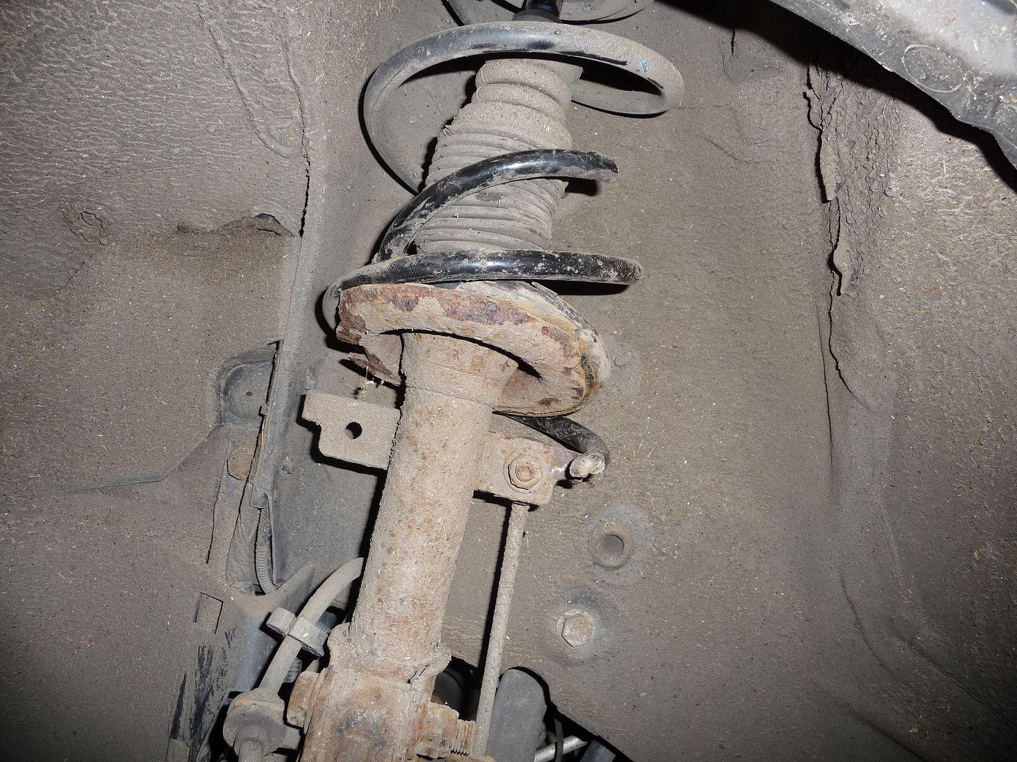

A Pal of mine heard a loud bang one night on his front window, in the morning he found his Laguna had snapped a spring while parked and the end of the spring had shot out into his bay window, it was lying on the floor next to his front door. This is the same guy who took out a loan to pay for his shiny Laguna est and lost a fortune on it when it exploded.
Same thing happens with springs to a lot of cars of this era to be honest. The Laguna takes a tyre out because its not slammed to the ground like a lot of German stuff, so the spring base is higher.
It's obviously too much strain for the car, any mechanical object can fail under arduous situations, such as being parked in the street and not moving at all.

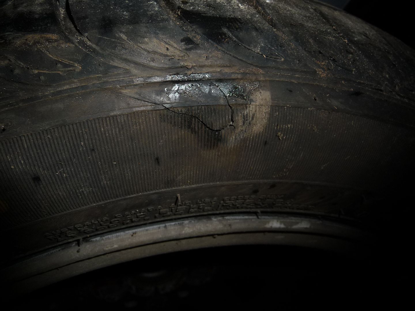

Third problem: Handbrake seems to be stuck on. Well, it has been sat for a month. Slip the clutch a bit and POP!!!! Fsssshhhhhhhh.... MOTHERFUCKER
Fucking grade A, the bastard spring has snapped and torn a hole in the tyre.
I took the wheel off, turned the spring through 90deg (so the sharp end pointed away from the tyre) and went to fit the spare.
