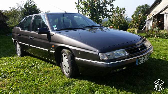

Current dilemma is over these two:post-18019-0-63349300-1449935931_thumb.jpg
http://www.leboncoin.fr/voitures/879454124.htm?ca=4_s
http://www.leboncoin.fr/voitures/891142543.htm?ca=4_s
Both manuals sadly :(
I'm put of a V6 due to the quoted 8 hours to change cam belt, plus side is LHD V6's got Diravi ( I think?)
Diesel is highish miles but these engines are supposed to be good for it if the interweb is to be believed.
Any thoughts from this bit of the interweb ?
I had a V6 auto about 12 years ago and nothing went wrong, rusted ,leaked or fell off, what should I be looking for 12 years on ?

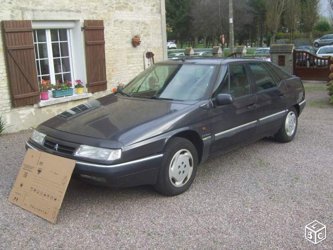

http://www.leboncoin.fr/voitures/872007757.htm?ca=2_s sounds like it's been well looked after.

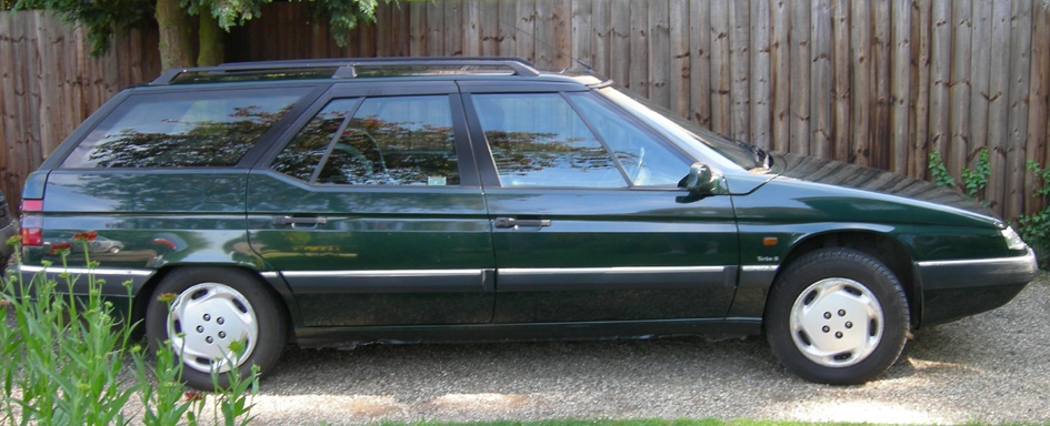

I have driven quite a few XMs in the past as I used to sell them new from a Citroen dealer. I find the straight 2.0 car a bit sluggish, the 2.0 turbo are great but no sound track. 2.1TD is a very practical car to get around in but lacks any sparkle, 2.5 Diesel needs an Autobox to make it great for me so V6 is the best choice for a low mileage user! Just my personal tastes as I am sure you will enjoy any XM variant.
The photo is the last XM 2.1 TD Auto Estate I drove regular, it was my friends car until about 3 years ago when it blew a head gasket.
