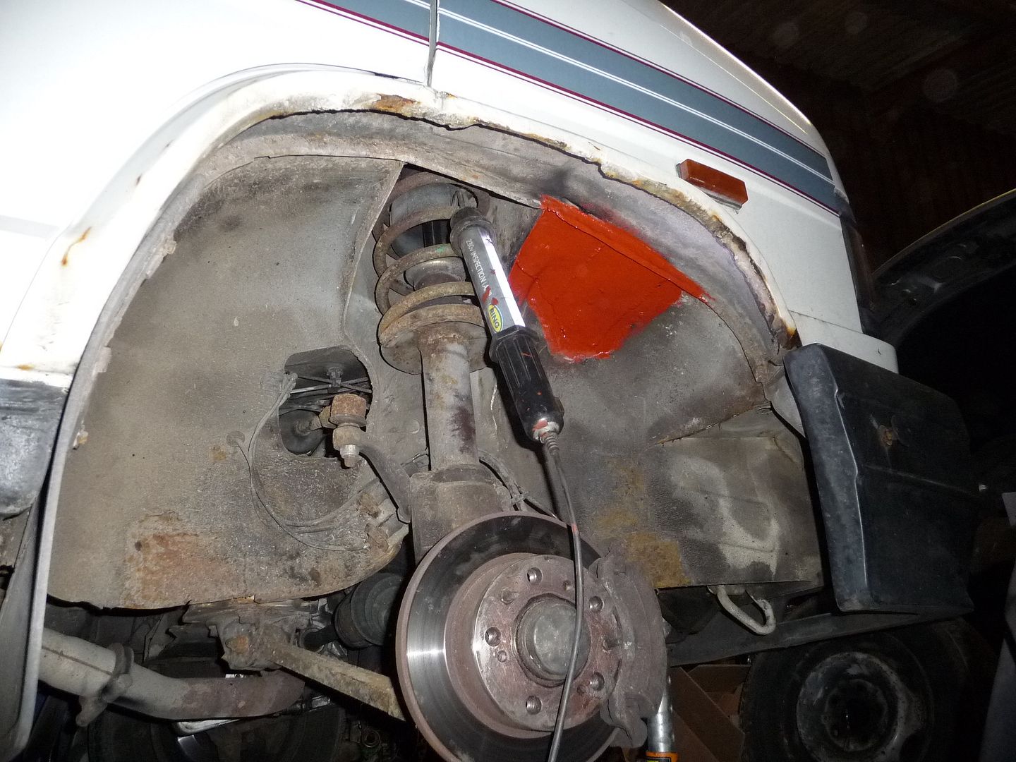

I need to get on with this camper van so I took it up the garage the othetr night to do some tinkering.
I was sure it would need some welding so i decided to have a look underneath and see what I could find.
Took off the OSF wheel first.

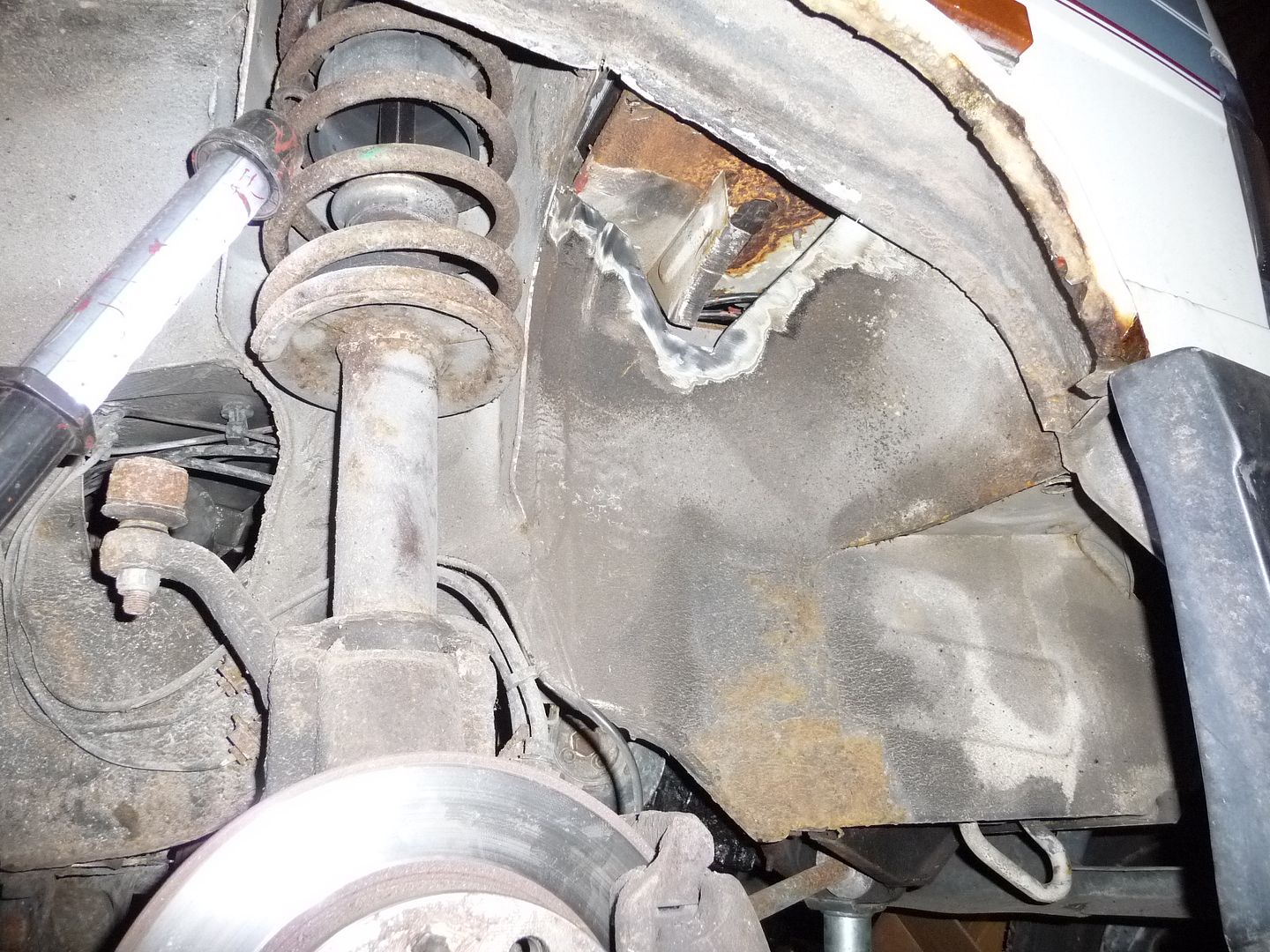

Didnt take long to find a nice big hole!!!

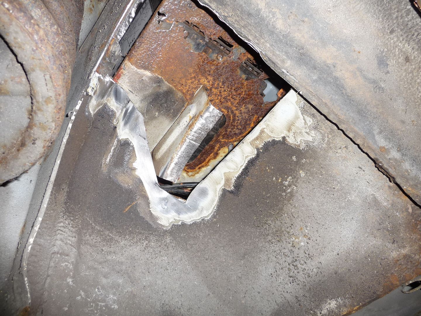

The battery tray is directly above this hole and its a bit rusty too but thats not so critical. But a rust hole beside the strut tower is no good so I spent ages chopping it all out.

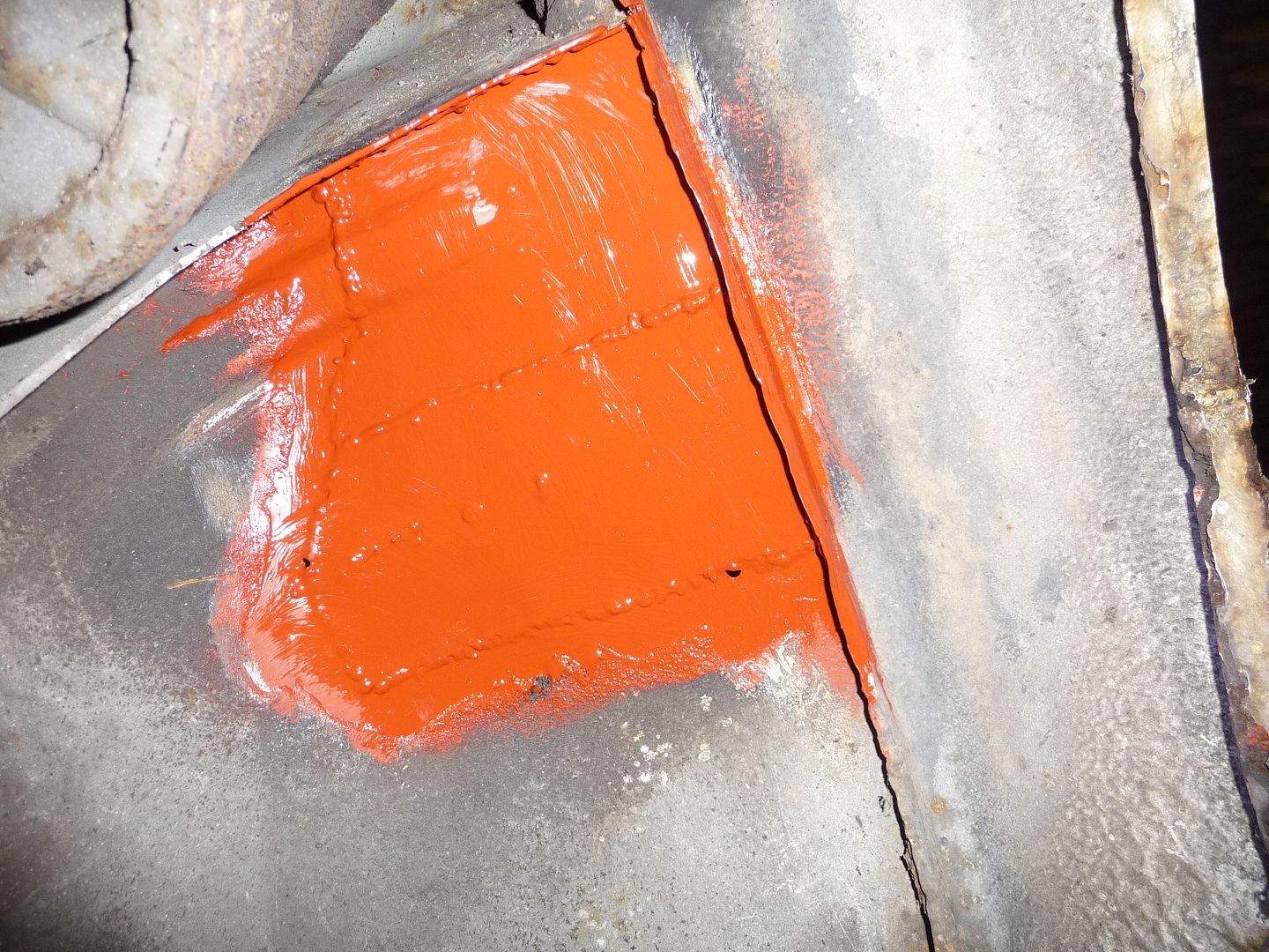

Repaired it with two big patches!!!! Basically finishing off my big sheet of Zintec, Found a leaky CV boot as well so I have bought a new one off eBay for a tenner.
I'm sure there will be some more welding to be done - more next week no doubt

You have done good work there old lad. I am impressed :) Neat welding and the rear end repair is first rate.
