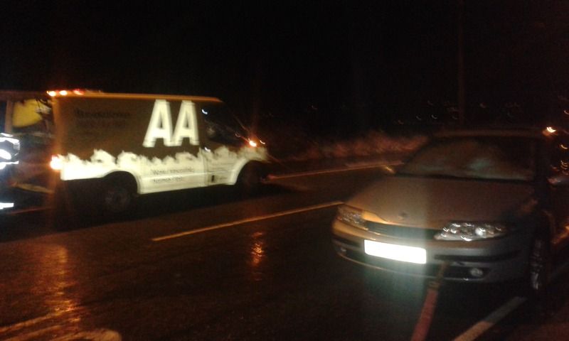

Today I changed the oil pressure switch and while I was there fresh oil and a new filter. Everything seemed fine, no more oil warnings, car behaved itself all day. This evening I went out in it to go view a house for my sister, expecting to be a couple of hours.
On the way back, I noticed a slight lack of power while going up a hill. No horrid noises, no warning lights. The only red light in sight was the traffic light at the top of the hill. As soon as I dipped the clutch, it stopped. Pressing the start button made it click, all the lights went out then nothing. Of course, I assumed it was electrical and was carrying tools and a spare battery. Pushed it round and parked up facing downhill. Tried a bumpstart but it did nothing...
With the car in gear and the handbrake off, I rocked the car while watching the bottom pulley with a torch - the whole engine rocks but the pulley doesn't budge so GAME_OVER.
Wet and pissed off, in a rapidly cooling car I waited 2 hours for the AA. I explained to the girl on the phone that it wasn't fixable and explained why, she asked me about some issues with her mother's megane. Eventually the yellow van arrived. I explained, he asked me to show him so I rocked it while he looked at the pulley and said "ah."
Towpole for the 3 mile trip back to the garage. I've dumped it there and come home in the scorpio instead.
I'm pretty sure it's turned a shell on a main bearing, and that it did so because I changed the oil. I'll decide what to do about that tomorrow.
