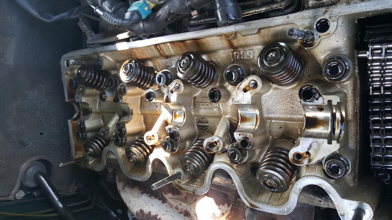

I took a whole rocker cover off myself. And an air box. And everything. It's quite liberating knowing you can't possibly fuck things anymore. Anyway, tea and medals for me tonight.
Back to the car.

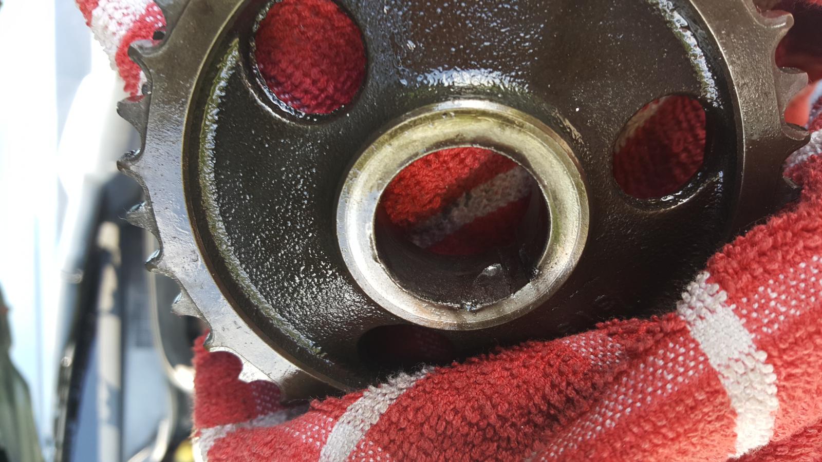

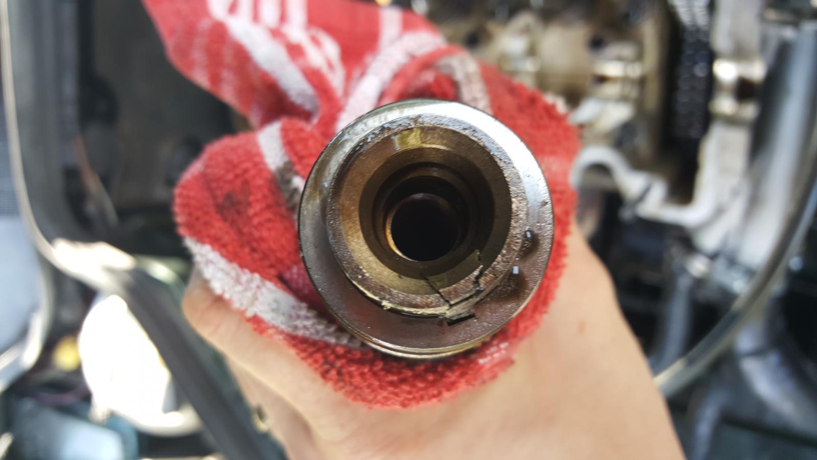

The chain had slipped completely from the sprocket. Properly off. It managed to smash the rocker cover in the process, something neither of us managed to do with a hammer and a healthy dose of anger. The chain had fallen off the front, making the removal of the cover difficult. Persistence paid off.
What's happened? In a nutshell the cam shaft is worn.
As is the sprocket.
Looks like what's happened is the chain jumped a tooth, got looser and completely came off.
The valves LOOK to be ok. It was difficult to understand by this stage, but they all looked the same height. This is good apparently.
Mechanic is semi positive. He wants to pressure test it, so I need to ask the AA to drag it to his place. If it's holding pressure then I think we're good to go. New cam shaft, sliders and tensioner will be required but he said he'd do the lot for £50 labour.

Valves the same height is good because a bent one won't normally slide fully back into the head, meaning it looks lower.

So as long as the cylinders aren't smashed it looks like, worse case, the head may need rebuilding? Has your mechanic got a borescope camera that he can stick down one of the plug holes, to check what its looking like underneath there?
