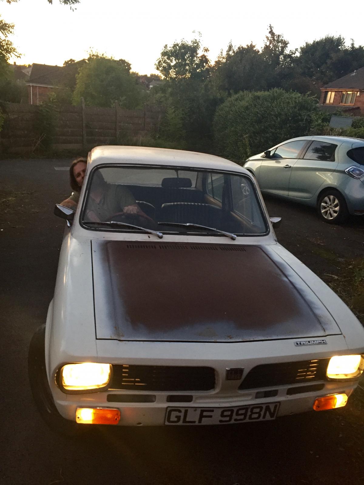

Swapped wheels to MGF ones, fitted horn and started fitting the headlights. The problem arose there straight away. I looked through a vast number of screws, bolts etc and none of them would secure the headlamp bracket/casing thingy.
Could someone with a Toledo or square eyed Dolly take one of these screws out and measure them for me? Pretty please.
As I couldn't fit them I thought I at least rewire them to see if everything works. No problems there.
A question for the silly thread: Where does it say which lamp is left or right? Does it even matter here?
Next were the little lamps and front indicators. Remaining cables didn't match colours but after few tries left indicator was left and right was right.

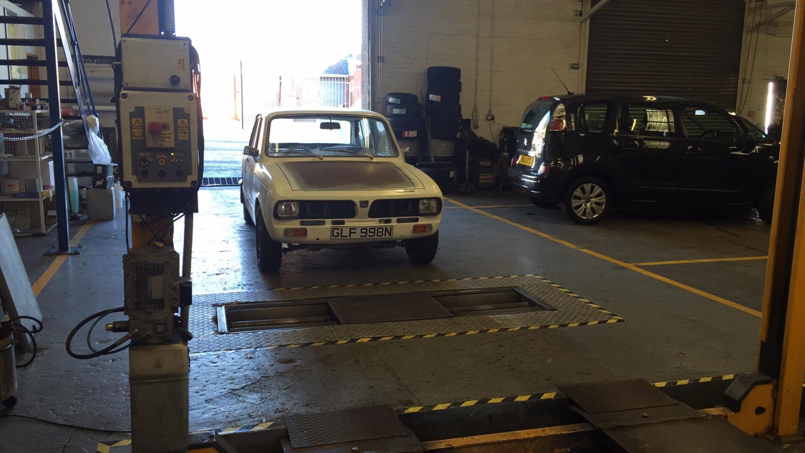

After far too many weeks, months, I'm ashamed even to admit, a year, Terry has passed the MOT with only few little advisories.
A joy to drive!
Now the bodywork needs sorting out and I can wiz around in proper shite style.

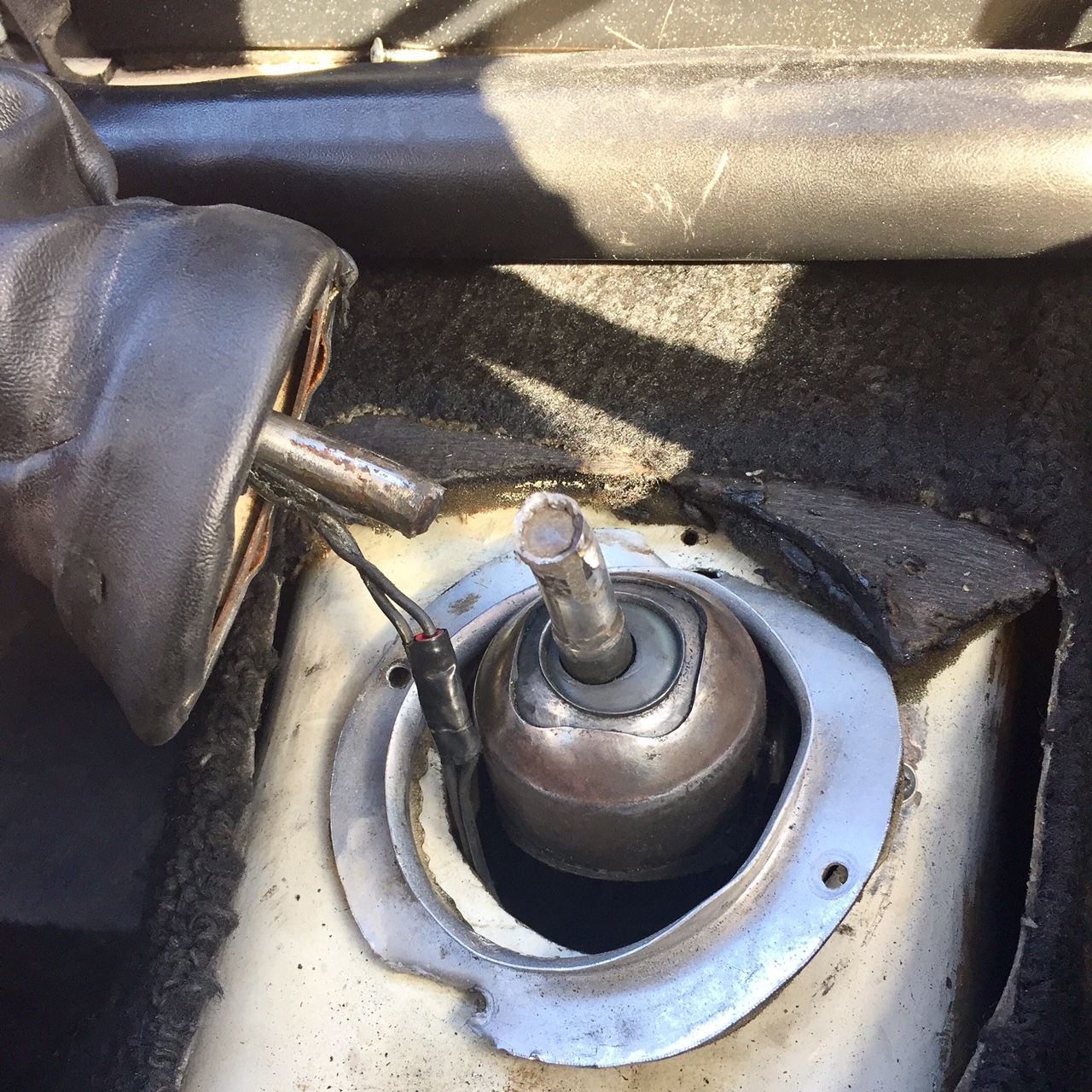

I was supposed to go to my work car club but didn't get there. The gear stick kind of broke...

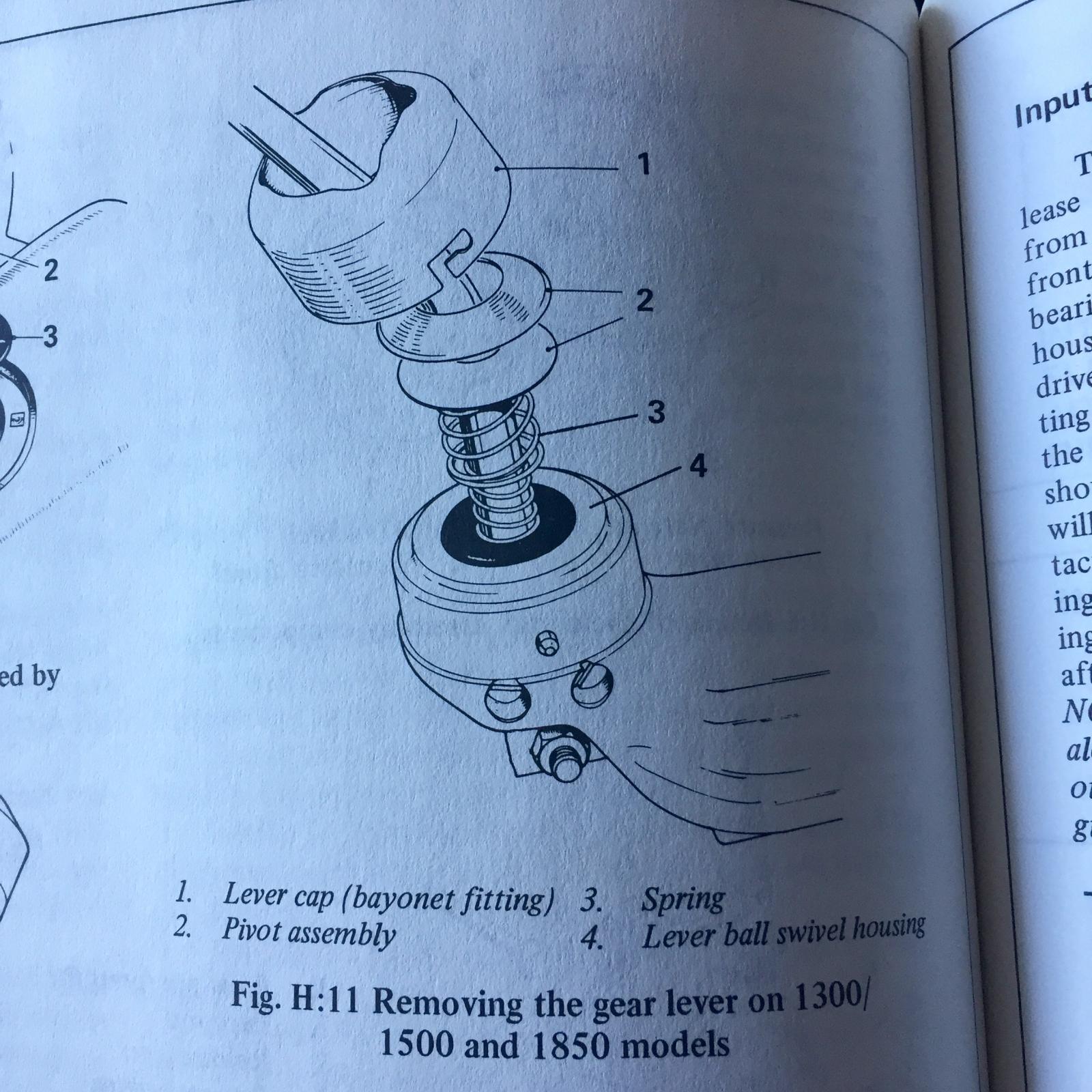

It looks like it snapped in the same place before. The short bit is about 4-5 cm.
Can I detach the lever without too much fetling?
It's a 1850HL gearbox.
The old garage manual says I will have to get underneath the car to release the lever.
I don't think I'll be able to reach it from inside the car.

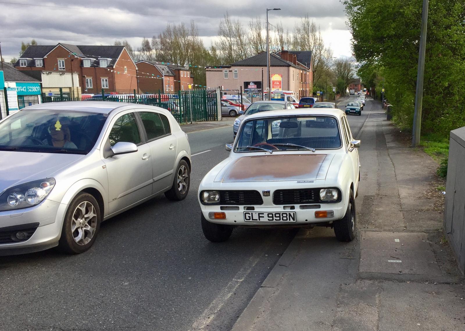

Picture of sorry looking Terry on a road side...
Where should I start looking for the issue?
Sounds like an ignition fault. I'd take the dizzy cap off and see what condition the contacts, rotor arm and points are in.
Condenser breaking down most likely, could be vapour lock as well I suppose.
I used to have similar problems with my Dolly 1300, replaced the ignition system and the problem vanished. I went for electronic ignition as the repo ones seem to be utterly dire...
Condenser or coil tbh. The way forward is to sell it back to me :)
Check the needle in the SU Carb, make sure it hasn't dropped.
I had this once, car would only run on choke.
I think the chaps are prob right on ignition, but check the carb needle to be sure
Checked the contact points and rotor arms. All nice clean and lubricated.
Went for a ride and same thing happened. Engine died at light and had to wait over 30 minutes before it started again.
Next step, order the condenser and maybe have a look at the electronic ignition.
Condenser quality nowadays is shit. TBF either could be the issue.
