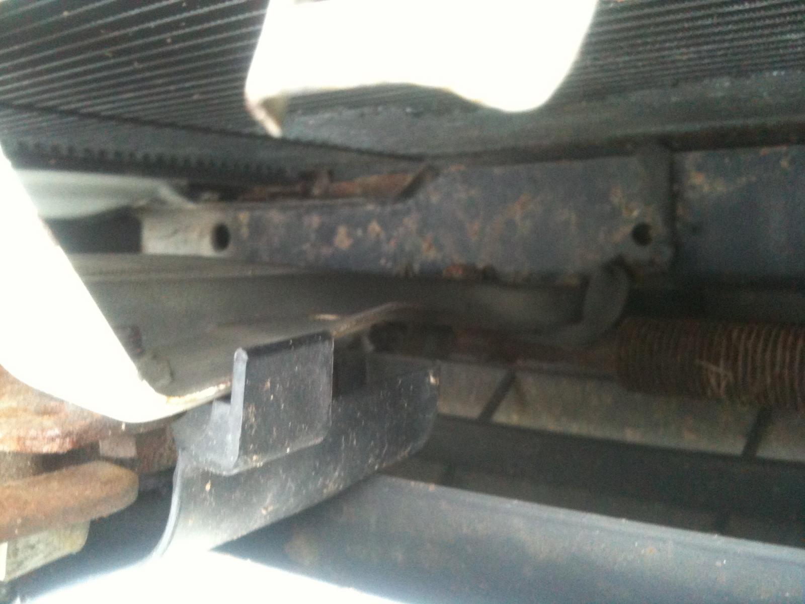

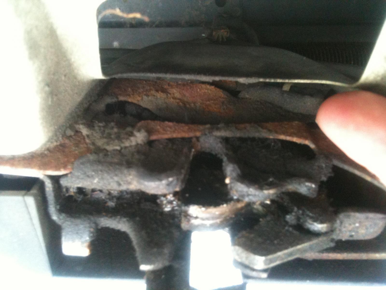

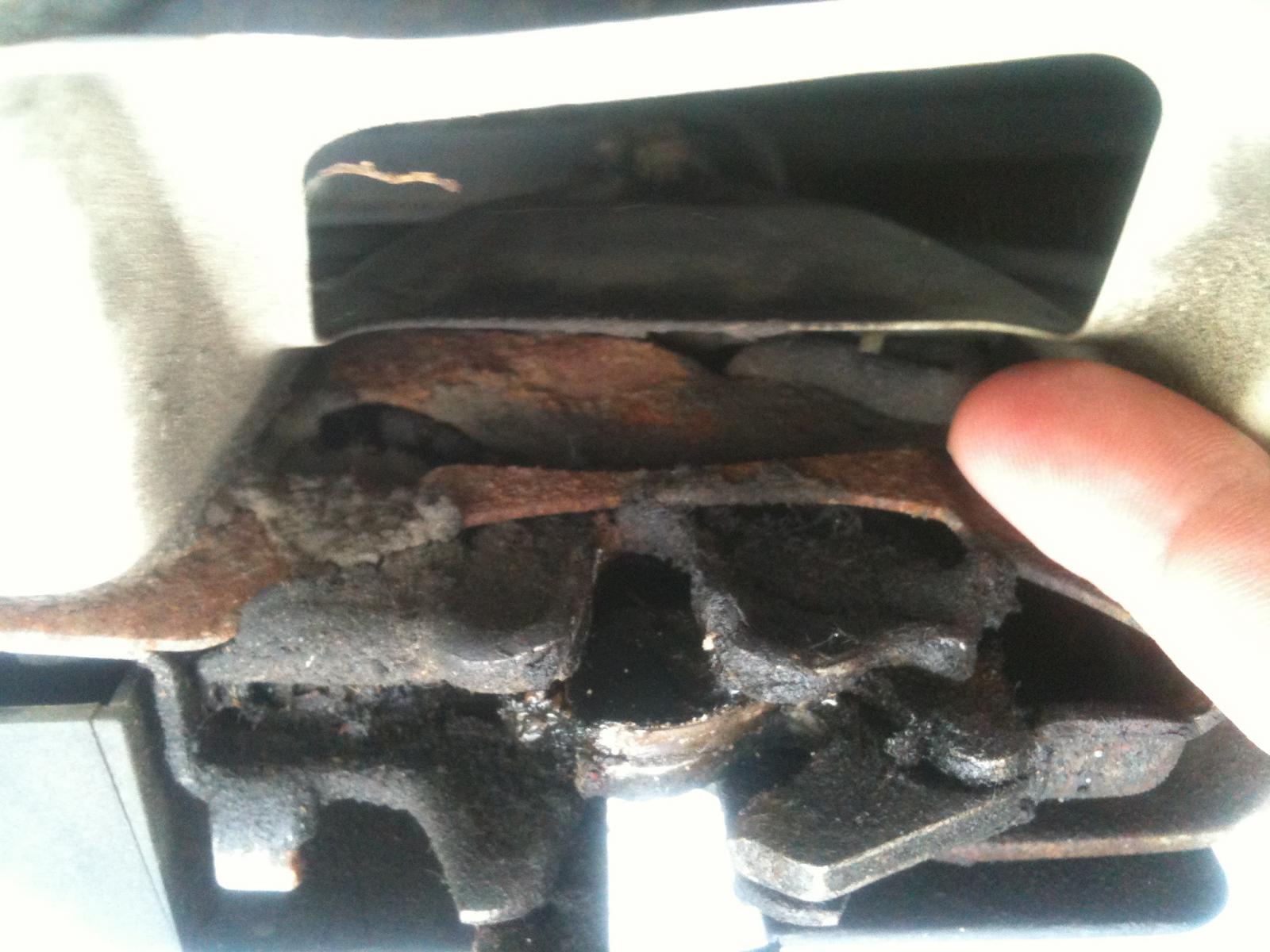

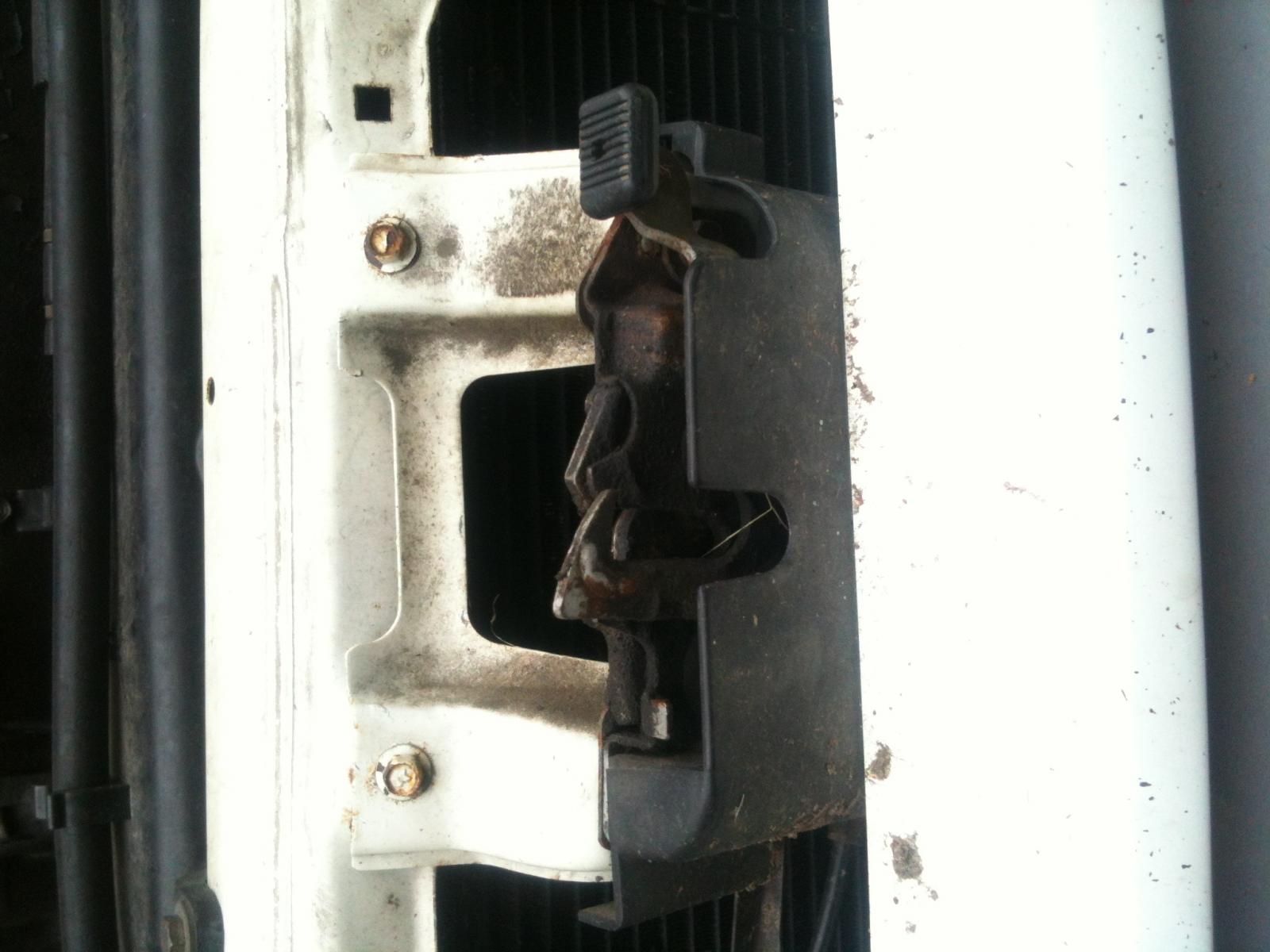

yeah, they're puny tyres, 165s I think!  Can you do me a favour, it just popped into my head.  On the squashed Rover is there an electrical connector on the bonnet release mechanism?  I think it's something to do with the alarm and the mech I got doesn't have it.  It bugs me so I'm considering modifying my original mechanism just so I can reinstall it.
From memory, I don't think so. Maybe yours had an after-market doofer installed.
Can you see anything on the pictures you took? (I'll go up and see later.)
The connector hides behind the mech, so it doesn't show up in the photos.  I'll get a snap of the one I took off so you can see what I mean.  Pretty sure it's a factory thing too because the connecter looks to be made at the same time all the bits of the mechanism are put together and looks fairly impossible to get out and swap into the new one.

Those photos show bugger-all.
What I'm pointing to there is the wire just in the mech. It's news to me that it was there. It runs down that spar to the bottom of the radiator and into the loom. I can only guess that it's something to do with the factory alarm.
It may be up for grabs when John breaks the car, to save you messing about adapting stuff.
That looks like it might have the connector on it in the second picture.  It's well hidden. Apparently it's a solenoid to tell the alarm the bonnet is open when it shouldn't be.
