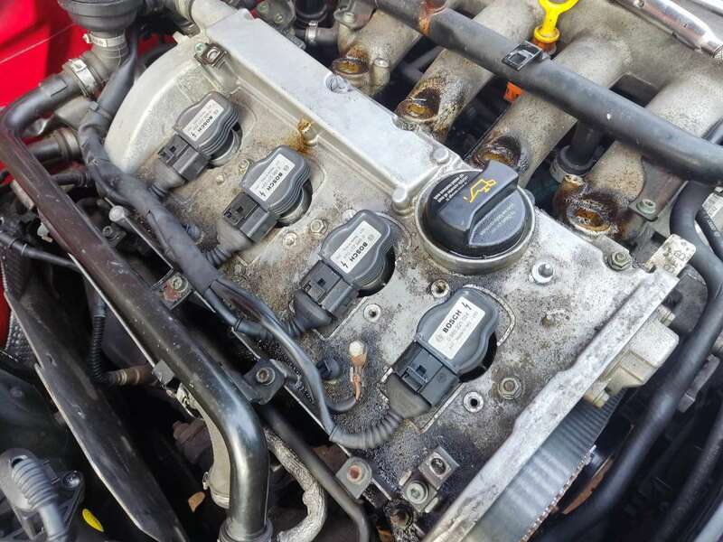

Job #1 - injectors. Deffo leaking.
Pulled, cleaned, broke one taking the O-rings off. Noice.

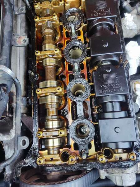

Rocker cover gasket was also leaking. The general scene (featuring free reminder to pull finger out and do cambelt):
Words can't really describe how crispy and useless the gasket was. For extra bodge points, an attempt had been made to add sealant, and all the nuts holding it down were only on just under finger tight.
How anyone with the ability to remove the rocker cover decided to apply wob instead of spending £12 on a new gasket, who knows.
Carefully scraped all the old gasket/crust/sealant off.
Pleased to see that it's all pretty clean in there with no real signs of the oil sludge they allegedly all suffer from.

Had to replace a few clips and a length of breather hose that just shattered, dunno if it was once rubber or originally plastic but it's now dead.
Small dab of sealant in the corners per the manual with the excess wiped off. 10Nm on the nuts with the torque wrench usually reserved for push irons.

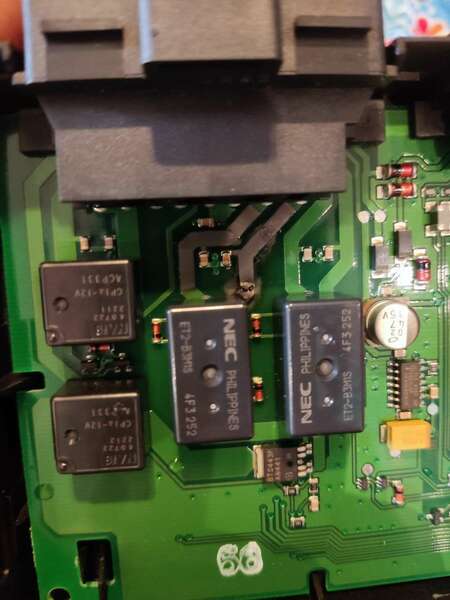

So car stuck on the drive till weather/parts/motivation align, decided to have a look at why the roof no work.
The fault code was for open circuit on the V223 which is the front hood locking motor thingy.
Step 1: remove some trim and apply multimeter direct to motor. Circuit is very much closed so that's one thing ruled out.
Step 2: find roof module and test from the connector. Circuit tests fine from there. Slight sigh of relief as I reckon the worst outcome would be a broken wire buried somewhere deep in the hood.
Open roof module, finds a bit of circuit that is open.
Slightly concerned that there could be an issue somewhere else that caused this to stand in as a fuse, but a SH module to swap in is only £20 so worth a go anyway.
I did find when I was in there that one end of the mechanism wasn't bolted in place properly so I guess maybe it was loose and not aligned and this caused the motor to draw excess current?

Still haven't touched the engine due to snow etc but have fixed the roof.
My new module turned up and it got rid of the open circuit code and there was some slight progress in that the windows went down when you pressed the button but then nothing else. I found that manually opening the front of the roof then meant the rest of it would go down, although there were codes for position not feasible on the front motor.
I lashed up a test rig with a  motorbike battery and applied some volts to the front motor and got nothing. Managed to find one listed wrong on ebay for £25, fitted today and we have a fully working roof.

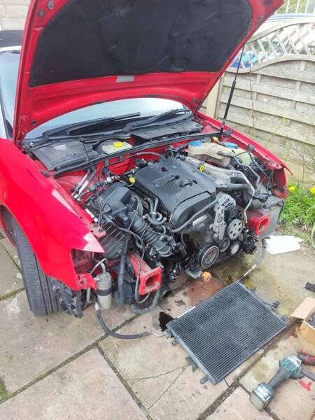

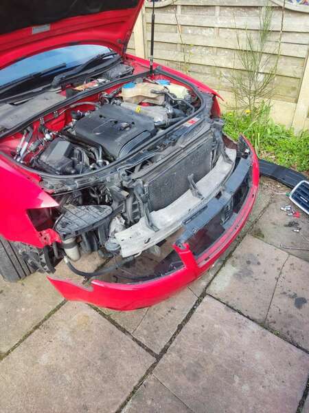

With most of our usual Saturday commitments cancelled for Easter, I make a start on the A4.
Step 1: gather every torx tool you own and assume the @Kiltox position™
Step 2: drain/disconnect some more shit and remove the front panel
More later...
Step 3: apply quality lifting gear and raise the engine a bit

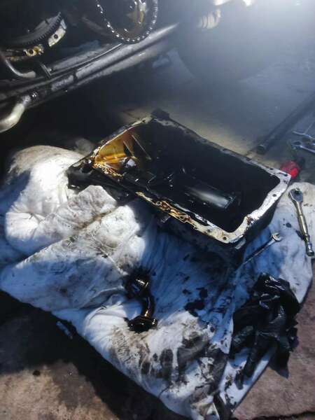

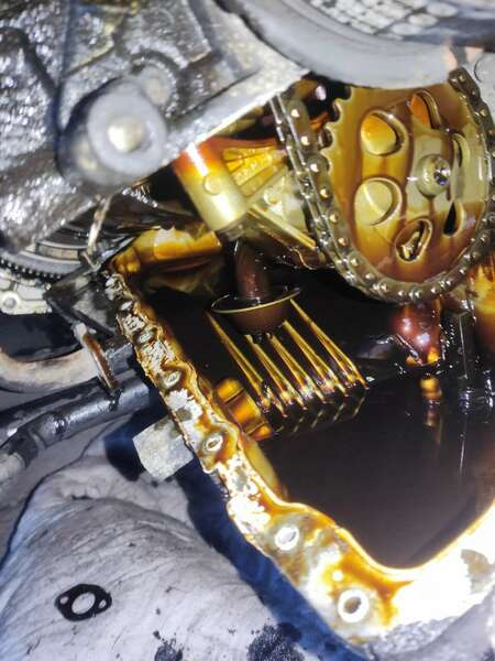

Basically the longitudinal installation is a twat for getting the sump off, there is a subframe underneath it which stops you accessing about half the bolts and certainly stops you getting the sump out.
Not gonna lie, this was a pain in the arse. Most of the 10mm bolts holding the sump on were fine but there were some 16s between the sump and gearbox that had been done up by Thor. Really thought I was gonna have to drop the subframe anyway to get access at more than one point but with a random selection of extensions and a jack handle, I got them out.
Also shout out to these 10mms hidden in the bellhousing, weren't too hard to crack off but having to rotate the engine to undo them one at a time was a nice touch.
Anyway, some time later - HAVE THAT YOU OILY BASTARD
Fairly pleased to see the pickup is blocked up with shite so I can be pretty confident I don't also need a pump.

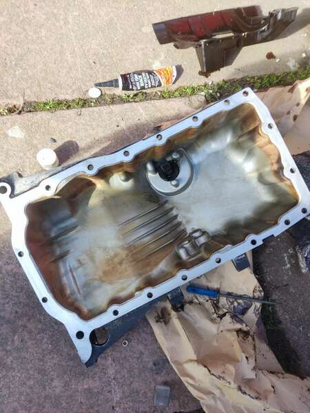

Sump is back on, managed this in a brief window of not rain Tuesday morning.
Not many pictures as was too busy swearing.
I didn't think the sump was too bad at first look but the more I cleaned it, the more little lumps of carbon and flakes of sealant came out. This was the finished job before it went back on.
Out of curiosity I dug out the old pickup before it went in the bin. Lots of crusty carbon and a few slivers of sealant. Also a semi circle piece of hard plastic I briefly considered being concerned about then filed under "ignore"
I think it's probably going to be wise to drop the sump and replace the pickup every 3-4 years, should I happen to own it that long.
Cambelt done now and car more or less back together.
If you disregard the minor preparatory steps of removing the whole front of the car, the access to the cambelt is one of the best I've done.
Gates kit gone on with a metal impeller water pump. The one that came out was a metal impeller, but it was also leaking from the look of these pink crystals.
The engine was pretty filthy, I have tried to clean up around the cambelt area and down the exhaust side. I think from the point that the oil starts that all this came from the rocker cover gasket.
The timing marks are a bit vague as the crank one is on the damper pulley thing that has a little play in it. I marked up the new belt and make sure it went on with 68 teeth between the cam mark and a locating nubbin thing on the bottom pulley.
This engine has a 2 part tensioner with an eccentric bit and a hydraulic bit. The instructions I found were to reset the hydraulic pulley in a vice and tension the eccentric bit so there is 8-12mm between the 2 bits of tensioner.
Turned over a couple of times and all seemed OK so put the front back on.

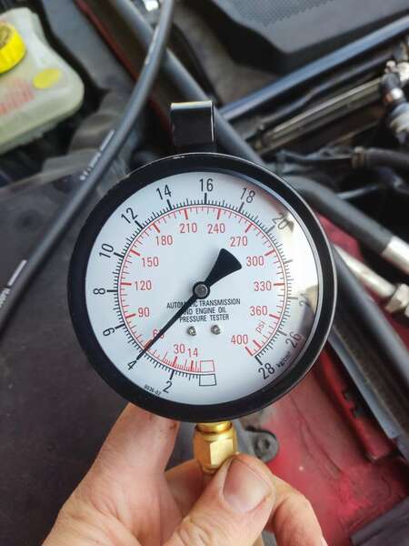

Fitted up the oil pressure gauge so I can check that everything is good when I am able to put oil in,

Parts collected, oil filled, road tested.
Oil pressure seems OK, after 5-10 seconds of alarming clattering it got to 4bar cold idle, and at hot idle 1.5 bar.
Cold 3000rpm was 6bar, hot 3000rpm was 4bar.
Some places on t'internet say I should be getting more like 5-6bar at 3000rpm hot but others say min 1bar hot idle and 3.5-4.5 bar hot 3000rpm. So I'll take that.

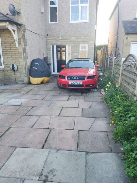

And in slightly better news, I ended the day as a 2 VAN WINNER
Got booted off the drive after that though as it's blocking the electricity hole for the Zoe.
