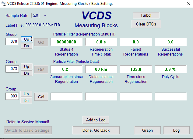

Still not sure whether it has a DPF or not, some of those codes seem to relate to one but the DPF measuring blocks don't seen right:
80km since last regen but 0 total regens and 0 failed? There is a can of a suitable size just behind the turbo but with no sensors on/around it, I'm leaning towards no DPF but maybe it was an option hence being kinda partially in the software.

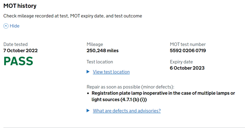

In the meantime the van finally got an MOT:
I did post another thread talking about welding, I managed to find a chap locally who quoted me for it and all seemed well.
Until I took it to fail it's first MOT on 15th Sept then he wasn't able to fit me in for "a few weeks".
Worked out for the best as I ended up getting in touch with a Vito man who has welded it up and fitted an exhaust and a track rod end for less than man 1 quoted for the welding.

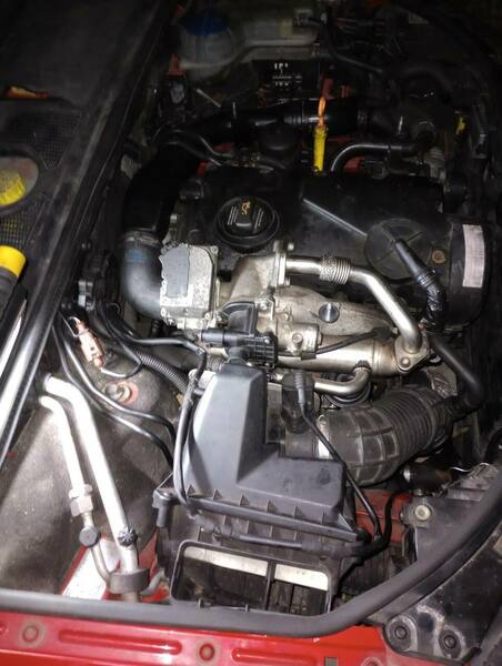

Access to the turbo is ace with the airbox out, this has to be one of the worlds most easily accessible turbos on a passenger car.
Findings:
  • All the vac things seem to be non-leaky as tested with my new knockoff mityvac thing
  • Could not detect any holes in any hoses. Replaced a few of the O-rings and reseated one clamp/hose that looked 5% questionable
  • Egr pipe where it attached to the manifold was missing a bolt. As this was the only leak detected, maybe this was the noise?

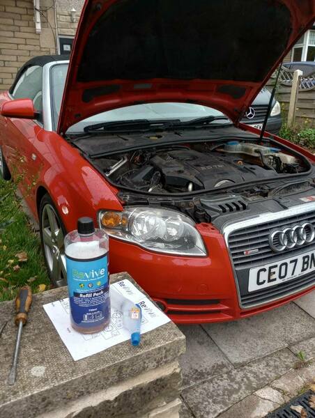

Did the Mr Muscle thing, you poke a hose down the EGR hole and try and get it in the turbo. I think it all went in but TBH it hasn't helped much with the VG mechanism in the turbo.
Here is how much movement I have in the actuator currently:
Which looks less than what you're meant to have according to this video here (about 1min20 in):
I took the car out for a drive, the noise is gone and I didn't get a limp mode (other than the one triggered by not plugging the MAP sensor back in) but it still doesn't feel right, takes a bit longer than expected to pick up below 2000rpm.
So what now? I have ordered a bottle of this snake oil which was recommended by a mate who used it with success on a similar TDI. If that doesn't work, I guess I will have to take the turbo off and clean it mechanically.
https://reviveturbocleaner.com/
So will the magic turbo cleaner work? Place bets now?

Thirty six GBP this was so I had high hopes. Seems to be mostly water based, maybe mixed with a bit of TFR and essential oils.
It has instructions, you fire it in the inlet after the MAF. 250ml at 2500rpm, then 250ml at 1800rpm, then wait 4 min, then 250ml at 2000rpm. Idle till mushroom cloud subsides then 20min test drive.
Smoke/steam was definitely madeIMG_20221012_114923767.thumb.jpg.a0d2b136dcc41f98108bd780102beb80.jpg
After the test drive, it's better but not all the way fixed. Low down it seems to pick up better, I reckon it has made the VG move easier within the travel range that it did have. But booting up a hill still get limp mode/overboost at 3000rpm.
Not been to recheck with my vac tester but I don't think I will have gained any travel on the turbo actuator.
Probably worth it for milder cases of limp mode/Old Diesel Malady but not this time.
Will drive it round for a bit in case it miraculously fixes itself but I reckon, predictably TBF, the cleaner is not powerful enough and the turbo needs to come off.

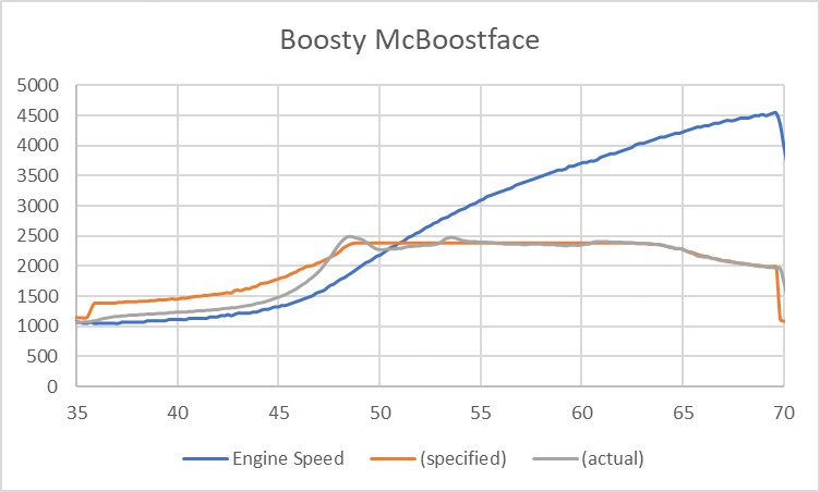

@320touring - with the vg travel limited shes boosting close to 2.6bar vs 1.7 requested when limp is triggered.
In fact I think 2590mbar must be the SVBL as it triggers limp at this pressure every time.
Did a log on the way to work:
Blue is engine speed, orange requested boost and grey is actual.
You can see the grey lags the orange until 2600rpm when it suddenly goes past and overboosts.
I am sure that I am missing some VG travel at both ends leading to this behaviour. Will get the turbo pulled off one day soon.

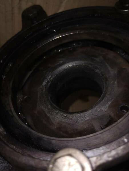

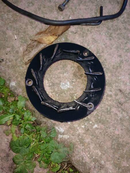

Had a quick look inside and hmm. Seemed sooty but not terrible, vanes definitely siezed.
I gave it a clean, the vanes move freely in the plate so thought I was onto a winner. But back together, and most of them still don't really move.
Looking closely I think there is some damage like some sort of hard particles have been through here?
Very strange. The wheels look ok, if there was a FOD issue you'd expect chunks out of the wheels or something but the wheels look OK.
I'll have a go at cleaning up the areas with some emery paper but tbh I might just get a new turbo, you can get a genuine Garrett reman for about £230.

The only thing that can be is some sort of unburnt hydrocarbon. Soot.  I have no idea what chemicals dissolve soot. But sitting it in a bath of something nasty like caustic soda solution. (Like what we did with 2 stroke exhausts back in the day) might be an idea.  Then clean it in an ultrasonic bath, then oil it and see if they are free.
There should be a small amount of free play where the vane touches, which is there for heat expansion.
It does look like the ring has a bit of wear, in the second to last picture. Make sure there are no high spots.
Cheers Mark. Made in Romania according to the label.  As were the other 2 or 3 Garrett/Honeywell units I've had my hands on for benchmarking in the last few years.
In those 2 pics you can see what looks like FOD damage. I've had a go at taking the high spots down with a file and some sandpaper and this has got the vanes to move but when I went to put it all back together I noticed the turbine wheel blades are all pretty chewed up at the outer edge (exducer?)
So recon unit it is. You can get will-fit cores to put in them for £80-90 but I don't think the VG cartridge will ever be right again either. The vanes move very freely when out of the turbo and seem to get caught between the plate and the housing when assembled.
I put it all back together and I do get full travel on the actuator now but the spec is 18inHg to get to the stop and it needs more like 25.
Obviously I could adjust the actuator and get it working something like but for the price of a recon it's not worth trying to bodge it.
I suspect the fact that the EGR pipe was missing a bolt means someone before me has known it was sticking, tried Mr Muscle and failed.
I don't really know what could have gone through it as the engine doesn't seem to have swirl flaps or owt. Maybe the damage to the housings was from recirculated bits of wheel?

Been for a quick brum up the road and all seems well, at least all the oil didn't fall out and there were no death noises. Will go drive up a hill and take a log to see what's what and report back.
Think we can call it fixed, this was a pull from 1000rpm in 3rd. Actual lags slightly till about 1500rpm then matches requested.
4500rpm achieved foot down with no limp mode.
Sadly, it was actually a bit faster before (in the bit between the turbo starting working and warp field collapse) we're currently getting 2400mbar/1.4 bar boost vs 2590/1.6 bar before. A remap may happen, one day.

To celebrate picturegeddon week let's have a TEDIOUS TEXTUAL UPDATE:
Audi still driving well, turbo hasn't exploded and all the oil hasn't fallen out. It's done it's first DPF regen with me, the light came on on the way back from swimming. After some effort to find a manual on t'internet I found I had to drive at over 60kmh, over 2000rpm, for 10-15 minutes.
I took it out to drive it down the motorway to save the environment, I stuck some diesel in before I went and the light went off straight away? It was on just below 1/4 before and I know they won't regen if they don't have a certain amount of fuel.
Dunno what I was expecting to happen, it could do with a light to tell you a regen is occurring as aborting can lead to problems. I did my 15min or so on the motorway in 5th gear and brought it home, VCDS says 20km since last regen and soot level 0% so we'll assume it's done the business.
Van went back in for some further work, engine mounts and track rods. My van man reckons the track rods should have failed the MOT and the mounts had lost all their magic juice. With that lot and the tracking done its driving much better, I had never realised how much vibration there was from the engine before.
I've also decided to put AT tyres on for the winter, I've ordered some Insa Turbo BFG knockoffs and I've found 2 steel rims, just need 2 more.
So a light comes on to tell you it needs a regen, but doesn't have a light to tell you when its doing a regen? Only asking as I've never owned a car with a dpf.
From what I can gather, if everything is working OK you don't get any lights or notification at all, it just does its thing. The light only comes on if it's filling up and the conditions to regen haven't happened for X amount of miles.
I reckon that putting a light or a message on the dash saying something like "DPF cleaning, do not turn off engine" would be helpful as aborting them is bad news but I guess they are trying not to shit up the average user so keep it incognito.
Yep.  There was at least one company (Vauxhall is the one I can remember from memory) who had the glow plug light used to flash while a regen was in progress - but as the average driver was incapable of taking 2 minutes to consult the handbook, dealers just got a plethora of complaints from befuddled owners - so they did away with the practice after a very short period.  Not sure if the ECU firmware was updated at service time on the vehicles which used to have this feature to disable it.
