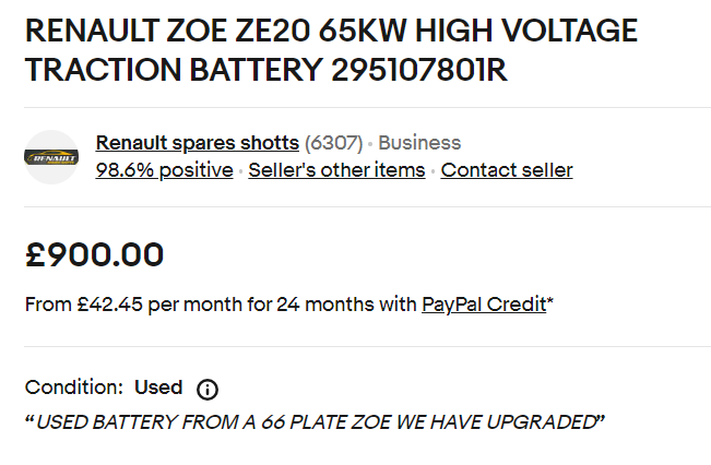

There were lots of tales of sub grand prices last year, apparently they have put all the prices up this year due to global materials prices or some such bollocks, IE they are just trying to get more money out of people.
If I had more time I would stick a second hand battery in and return it to them on a pallet.

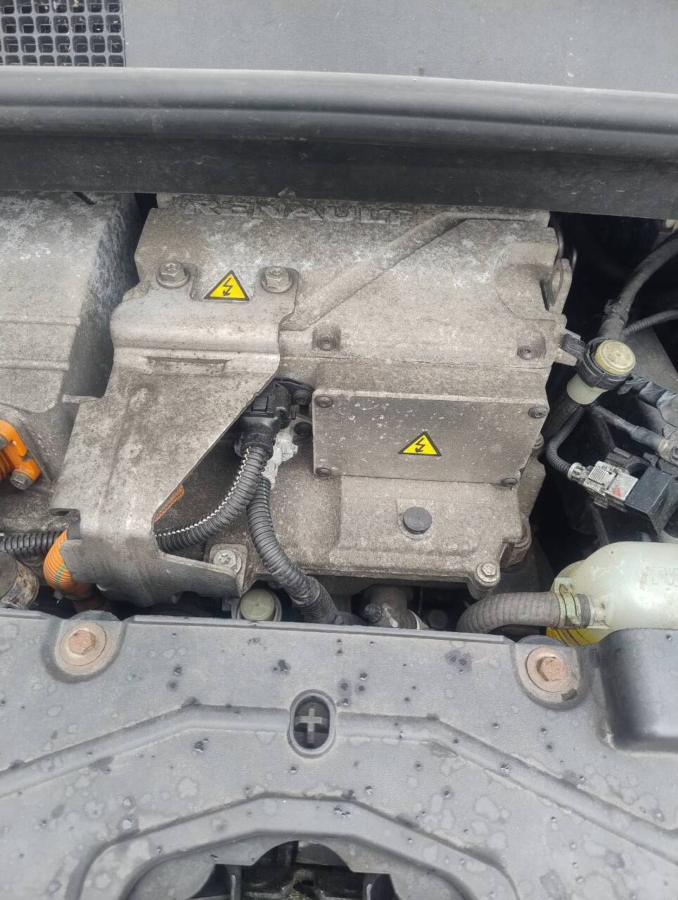

New coolant rad went on without issues, I used clamps to keep the coolant in the motor stack and only had to put about 1l in to fill it back up. The coolant is Renault type D, (Berocca piss yellow) same as used on assorted ICE cars of the same era.

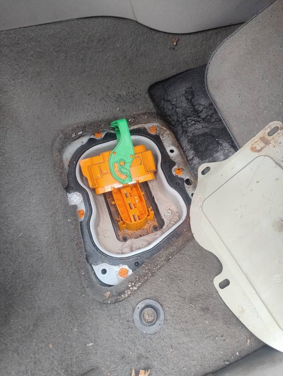

The fuse lives behind this reassuringly labelled panel:
Safety first - 12v and bigboi batteries disconnected:
Didn't have a multimeter to hand to test, but these don't look very blown.
Overall, no change. Have posted on a Zoe group which has a few handy people on it so hopefully will be able to get to the bottom of it.

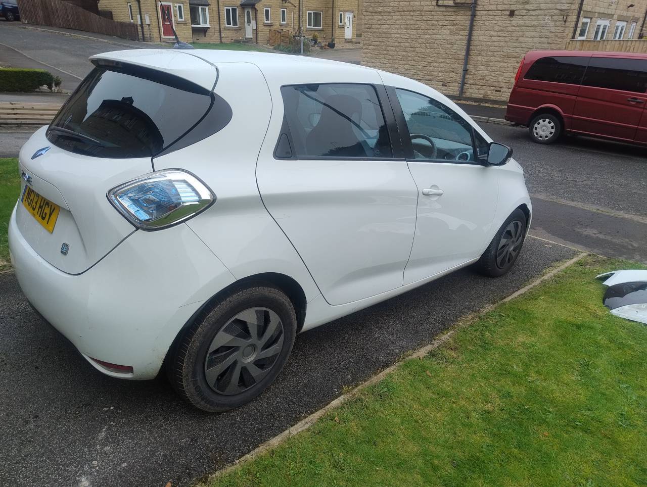

There are quite a lot of minor scrapes, some might t-cut out. But a major improvement.
Looks like a new car.  Damage repaired, AC getting sorted, what a transformation.
Thanks, there are some other minor scrapes on the sides I probably can't do anything with, but by the time I'm finished it will look better than my ex's 68 plate which she has scraped down at least 3 walls.
The front bumper still needs some attention, I reckon I can put some self tappers (I know) through the wing/bumper from the arch side which will hold it on and not be visible from the outside.
