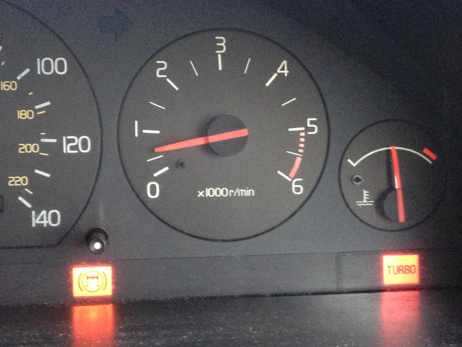

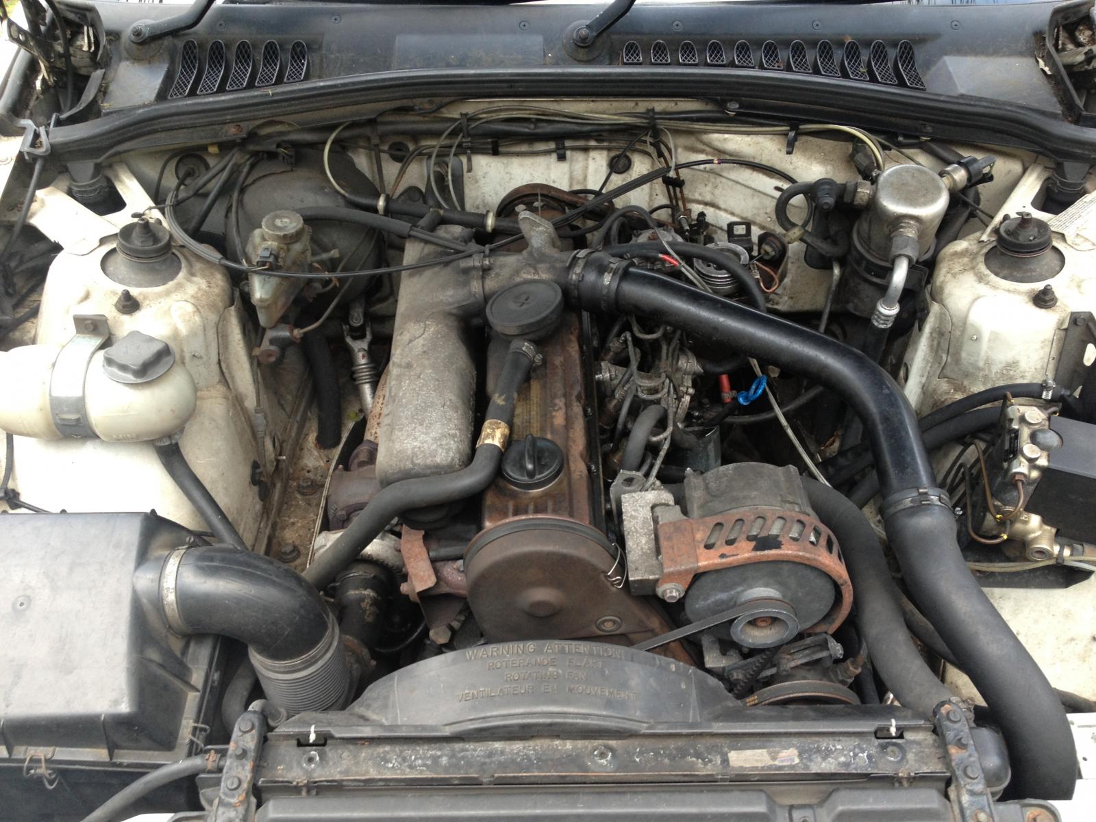

Well whats it like? Its been sat for a while, all the tyres needed lots of air, Brunel would have approved of the smoke to begin with but now its settled down, I think it just needed a good blast. The autobox and truck-like 6 cylinder diesel seem a good match. Theres sometimes quite a noticable transfer of transmission rumble/ vibration, espectially when the box changes down coming to a standstill. Ive had a look underneath and I think the rubber mount that sits on a cross member at the rear of the autobox is shot- I can move the rear of the prop and transmission casing a bit up and down with my hands, is this a common problem? Looks easy enough to sort. There's what I think is the ABS light on the dash- I'm hoping cleaning up the sensors will sort? Also the TURBO light is on permenantly. The turbo seems to be working-any ideas? Although in 700 series shock news the actual dash cluster is working perfectly. The MOT is due at the end of the month so a bit of work/ fiddling ahead, but on the whole its a sold old thing. I think It may have had a bump at the front as the bumper is a later one (I think) without the chrome bits and one front wing isnt quite the right shade, but you can't see that from the squashy black leather interior.  I think this may become my shitefest transport of choice.
I think the turbo light is to signify too high an exhaust gas temperature, so might just be a sensor.

...the TURBO light is on permenantly.

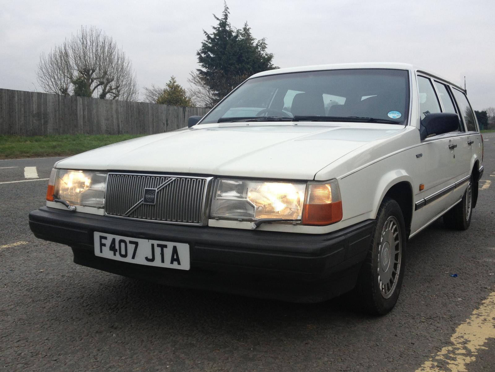

Did all 760's come with the 3 lights in the headlight like that? It looks kind of weird to me.
Integrated foglights. Gr8 for driving with your foglights all the time without looking like one of those twats who have their foglights on all the time.
^ Yes! Volvo 760/940 headlights are probably the best I've ever had on a car.

Is the ABS light on permanently or is it intermittent? Corroded brake disc back plates at the front can cause intermittent ABS problems due to rusty shite sticking to the sensor.

^ yes it's just an intermittent light, goes off once the car has started but once under way it lights up. Wondering if I have to remove the brake discs to get to the sensors to clean them properly.

Aye you'll need to take the disc off to get at it which is a bit of a pain. I had the same problem with the white 940 and found jet washing it regularly would sort it for a few weeks so just did that instead.
Model year 88 onwards facelift, which also means better dashboard, indicator/wiper stalks, alloy bonnet, obscured wipers, different windscreen and scuttle, ABS, sealed front hub bearings, and a host of other trivia.

I also agree that 760/940/960 headlights are GR9, especially if fitted with uprated bulbs. Pity that 740 ones aren't anywhere near as good.

There's what I think is the ABS light on the dash...
It is; same style as the coaches. If it's been sitting the sensors will be cruddy.

It's definitely got 940 headlights, but the bumper was the same as the 940 IIRC; that looks like it's off a 940 base as it's got no moulding whatsoever on the top of the bumper, normally on 940s it was body coloured or chrome. It's definitely got facelift 760/pre-facelift 960 wings and bonnet as they are slightly different to the 940.

I've recently been tackling various little jobs in anticipation of today's MOT. The most obvious fail was the ABS light on the dash. After much cleaning up of sensor connectiors and relays, I decided to remove the front discs so I could clean up the sensors themselves as they are magnetic and attract all sorts of crap. Still the light winked. In despiration (im not very good with electrics) I removed the bulb from the dash like a right bodger. I then had a bit of a moral dilemma and decided to fix it properly and put the bulb back in the instrument cluster. I broke out the multimeter (always had one, more because I thought I should ratzher than actually knowing how to use it) and noticed one front sensor wasnt giving a resistance reading. After a bit of messing about trying to find a sensibly priced bosch sensor it arrived in the post today on the day of the MOT! Once fitted that warning light finally went out.
I did have a bit of a worry about the timing belt and the smoke test as Ive got no idea when it was replaced, and running it up to the govenor like they do can give a tired belt a hard time. Its high up on the to do list. In the end it did fail. A few minor things but an advisory on a borked propshaft UJ which explains the rumbling through the drivetrain that I had thought was a knackered transmission mount. Recently I've tried to tackle everything myself but at the mo I'm tight for time so Ive asked the garage to sort it- should be back with me in a few days. Oh and it actually passed the smoke test!
