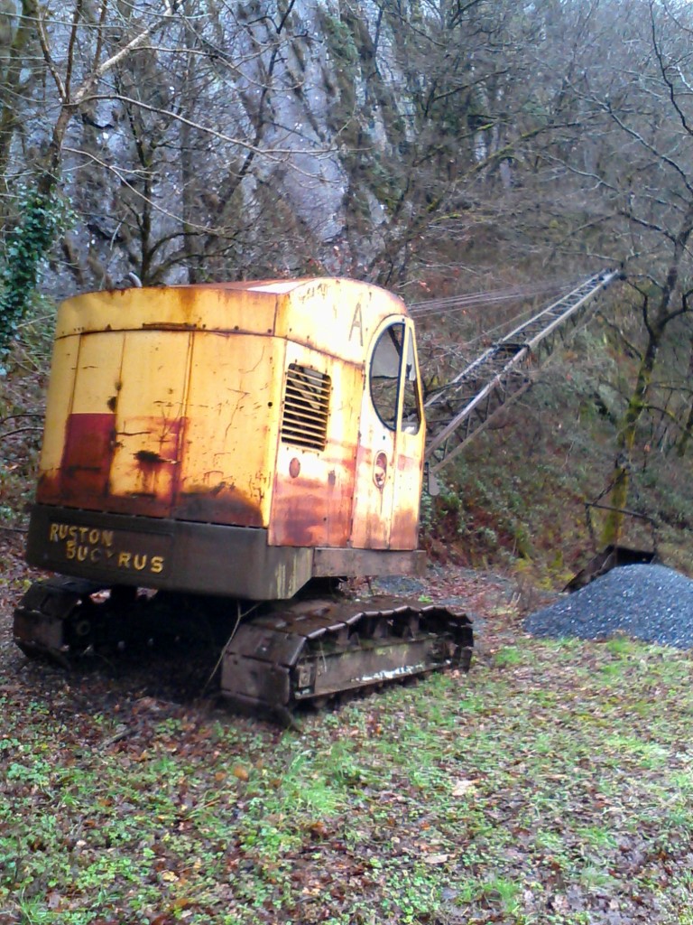

how would you move this? abandoned dragline content.
"Yah, so, Dave, could you have a look at that old digger at the bottom of the valley and see about getting rid of it?"
"err...ok?"
This thing has been sitting for decades. At a conservative estimate, I would say it weighs 5 tons or so. How the actual fuck am I supposed to move it? Access is via a narrow track so no chance of getting a heavy truck near it. I would guess when it was brought in it was dropped off at the roadside and driven down the track. Obviously its not driving anywhere in a hurry now.

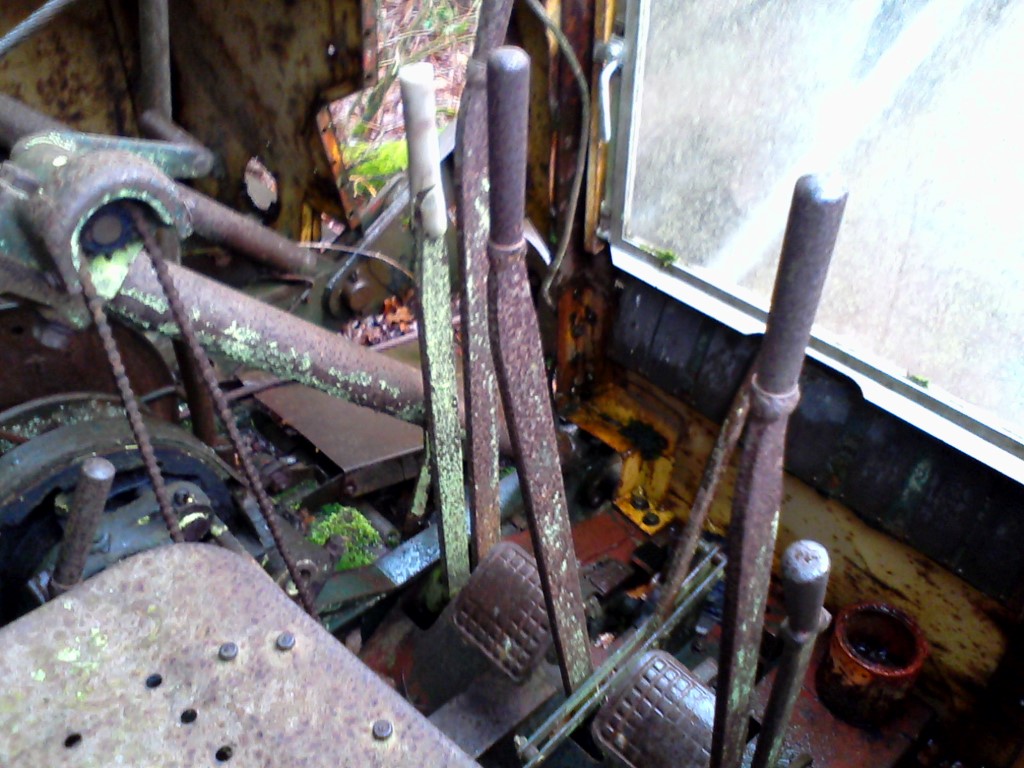

Must have been an absolute pleasure* to operate for hours each day...

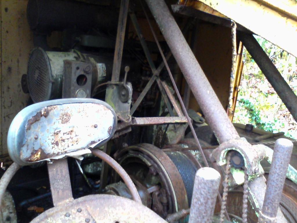

3 cylinder diesel thumping away right behind your head, spinning death inches to your left ready to suck your arm in and rip it off, plus the chance of a cable snapping and whiplashing through the cabin, cutting you in half.

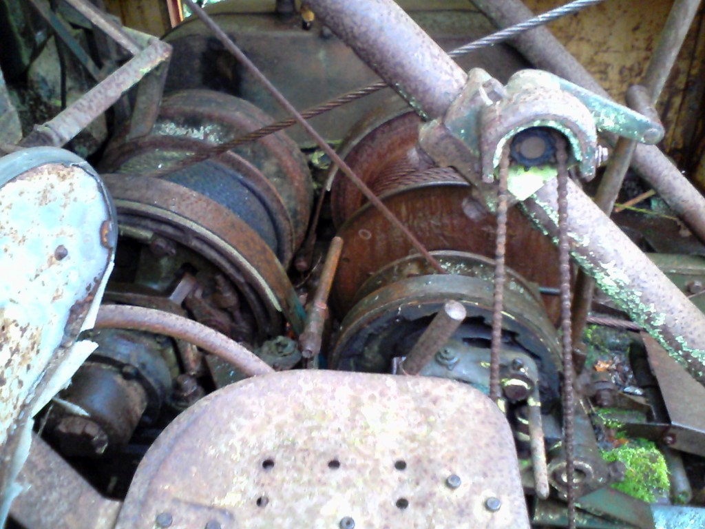

The assorted control levers seemed to operate a system of open clutches and ratchets that operated various drums and gears from the constantly turning engine output shaft.
Probably have to cut it up on site. Thats going to cost a fair bit in oxy acetylene gas and will still be a mammoth task.
The cast iron counterweight looks like it will be fun to handle.....

I say get it running well enough to drive up that narrow track and onto a trailer. Cutting it up and moving those super-heavy bits will take far longer, and will probably give you a hernia (or two !).
Also, posting a video of it running on here should be enough for you to WIN* AUTOSHITE !
(* at least until Junkman resurrects that Lanz Bulldog that's been dormant in his cellar since the autumn of 1952)
That's only a baby one. I would say you deffo need to get it running if only to drop the boom down for disassembly/scrapping.
If you can get a tractor and a flat trailer, lower the boom onto that then disconnect it. If it came to it a big 4WD tractor would drag the thing down the track and onto a wagon.  What engine is it - Dorman or a Ruston I would guess? Both flavours have a value if it is doomed, both are proper old school so you've a good chance of them cranking up unless it is full of water in the wrong place or something of course.
As  a mobile plant fitter for the last shitload of years I would think you'll be cutting it up where it lays. You can tow/push tracked vehicles if you can disconnect the drive but nothing on that is going to move. How far off the road is it? Can you get a small wagon down to it?
Got access to a modern super tractor? Thinking big Fendt or the likes.
If the thing freewheels at least, a big chain and lots of welly in low range should drag it out.

Why move it at all? I reckon it looks quite picture-skew where it is.
It cant be started - I cant find the keys.
But more seriously, I had a brief twiddle and everything is seized, including the throttle lever, primer pump etc on the injection pump. Even if by some miracle it would run, all the shafts, clutches and controls are seized.
The owner doesnt want pikeys sniffing about the area so its probably going to come down to me. If I cut the drive chains it might freewheel, but even that is doubtful. I think it will end up being done with a gas axe and a lot of time.
Personally I would leave it. Its returning to nature with a tree growing through the boom and its not an offensive colour or anything, but its not my decision.

Wrong seat, should be a Lycett I think. That one looks like it came from a B450 IH. I'll take the whole lot off your hands if you're devastated.
