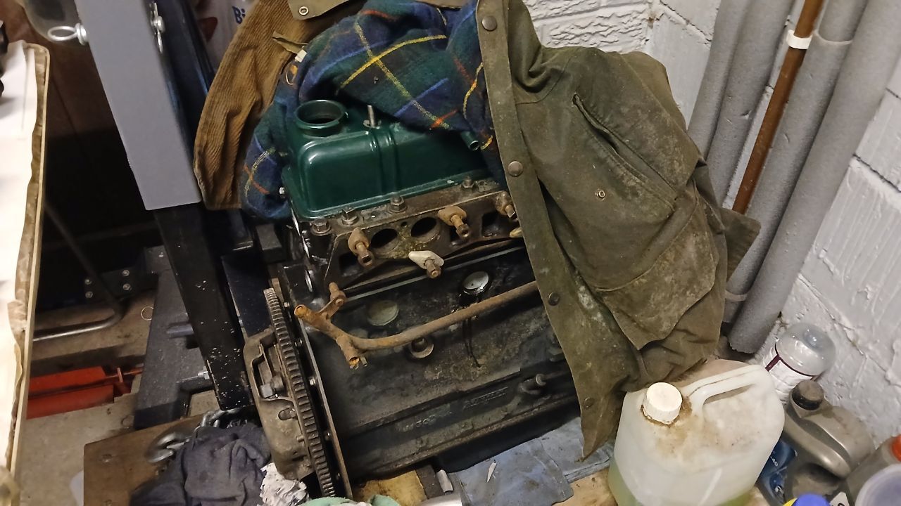

The real solution is to fix this small jounal engine with out of spec end float:
Instead of running the engine that was rusty internally when I got it...

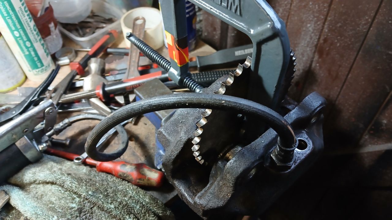

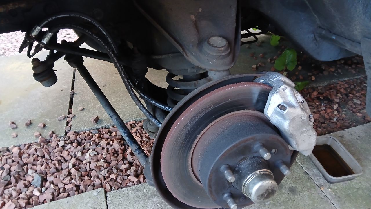

Post work I was back in the garage and found that I'd actually done the good caliper first...
I'd had success with the last caliper popping one piston out and blocking that cylinder with a bit of 1.2mm plate steel held in place with a G clamp.
This was not working here. The plate was bending and spewing grease everywhere. Tried pushing the remaining piston back in, the G clamp was going to give before the piston.
Refitted the previously removed piston and found a bit of thick steel to hold it in place in the form of a Dolomite timing gear...
This worked.
Pistons out, calipers split (no rounded Torx this time), bores honed, everything cleaned, new seals and a splash of paint.
Assembled. (Spot the obvious mistake I had to rectify...)
I feel like the calipers/flexis had to come off and back on again a million times as I kept muddling bits up.
Roped Fiancée_70s into pedal pushing and bled the brakes. 8 nipples in this system...

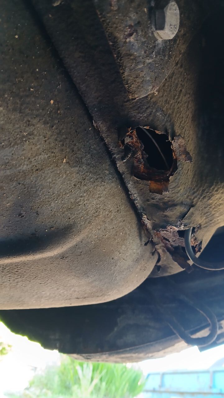

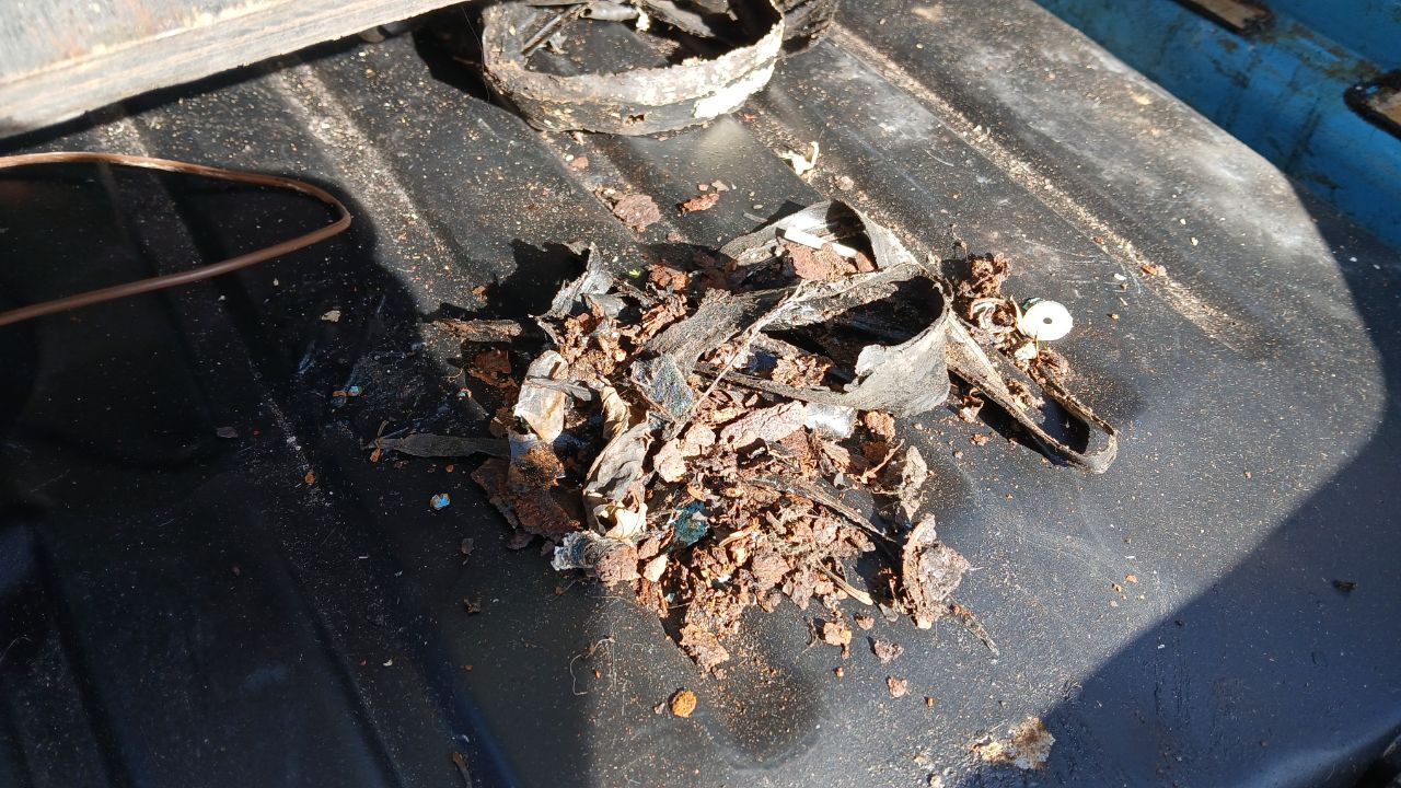

While I was dredging the boot I lifted out the fibre board fuel tank cover as the car has always smelt petrolly and I suspected a loose filler hose or missing vent hose.
Naturally nothing is ever that simple...
I wasn't the first person to have issues it seems! The fuel tank actually makes up the centre of the boot floor, half inside the car, half outside, and screwed into the boot floor along the tank flange.
Somebody had packed the seam between tank and floor with silicone sealant. This had trapped water and (say it with me) rotted the boot floor out.
The rot is actually relatively localised and should be an easy repair. IF the tank will come out, which the state of the screws suggest will be a trial.
Also, couldn't find any loose bits. Starting to think the tank may have split along the seam. Naturally new tanks of this design are NLA, in 1973 they moved them to behind the rear seat for MOAR SAEFS.
I'll need to fill it to over half a tank and see where it leaks...

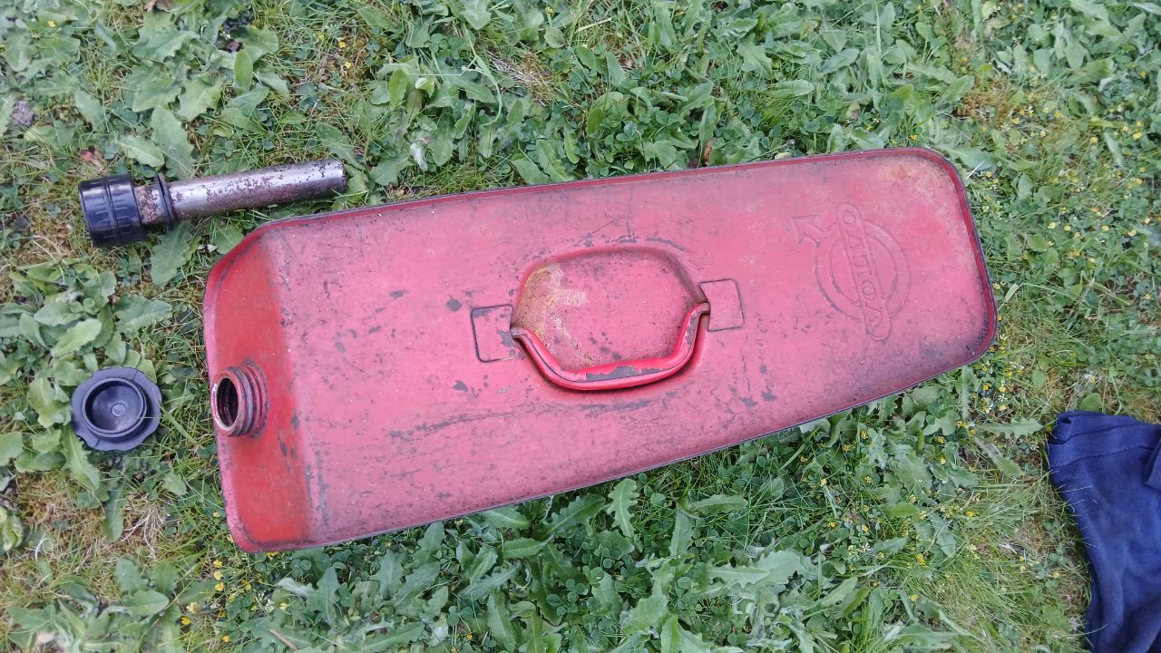

I did at least find a SECRET COMPARTMENT.
With FITTED SPARE FUEL CAN.
Probably rusty beyond use, but it is a neat feature.

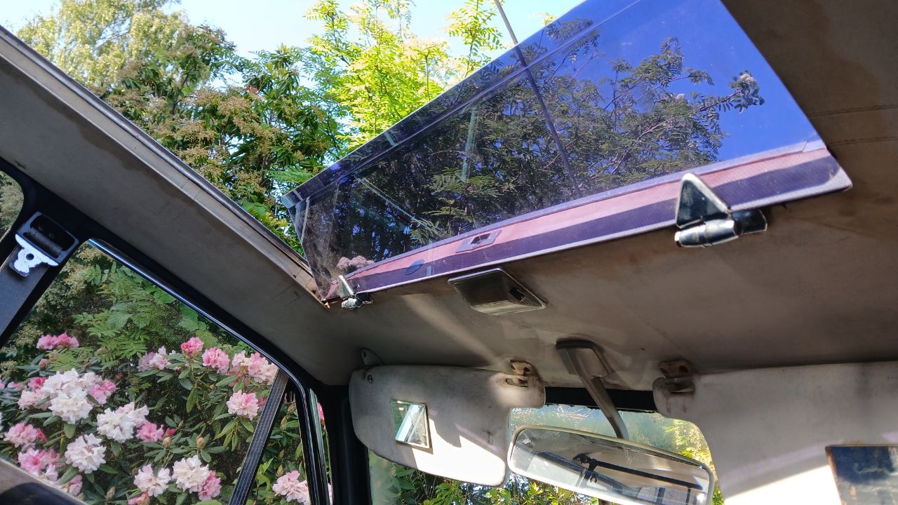

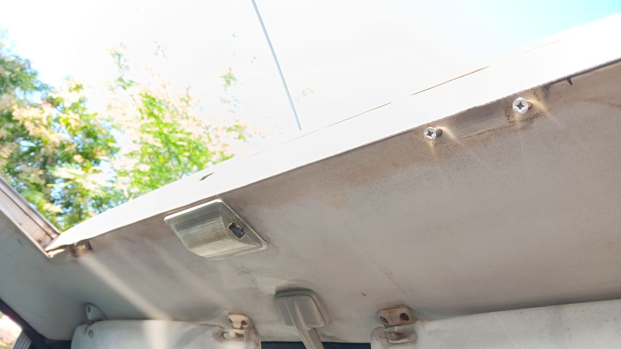

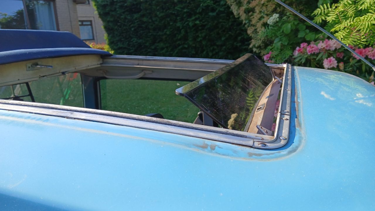

Fully extended the sunroof to vent the petrol out of the car.
I'd always wondered what the deal was with these wood screws beside the sunroof.
Well, I found a bit of blue perspex which answered that.
I suspect this was removed as the wood sunroof frame it screws in it is largely a memory. So if it falls off as soon as a pothole is encountered it can go back in the boot...
