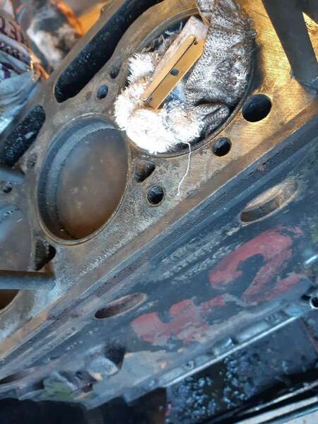

Cleaning revealed a big "M" and orange splodge on one side of the block and a "42" and green splodge on the other side. Presumably this meant something to some bloke on a factory production line in 1982 but I've no idea what any of that refers to!

"G" stamped pistons are stock, so it's never been bored out and there is no sign of piston slap or bore wear at all. No signs of burning oil (although the oil that's in it was akin to chocolate fudge cake). No immediate signs of worn out bottom end shit although I've still got to yank the sump and measure everything properly.
Plan is to throw bearings and thrusts at this if it looks like it needs them, clean the fuck out of everything and chuck it back together and dump it in the car to run this year.
The current engine that's in it will get pulled out and rebuilt properly on the bench rather than swapping bearings upside down underneath the car. To be honest I think it might be better to save up the pennies and buy another crank for it rather than risk making a cunt of it running oversize custom thrust washers. Reckon I'll also get my twin carb manifold dug out and have that ready to go on.
Hoping to get the new lump built up and dropped in over the next couple of weeks, I need it bedded in and proven for this year's grand attempt at bullshit...

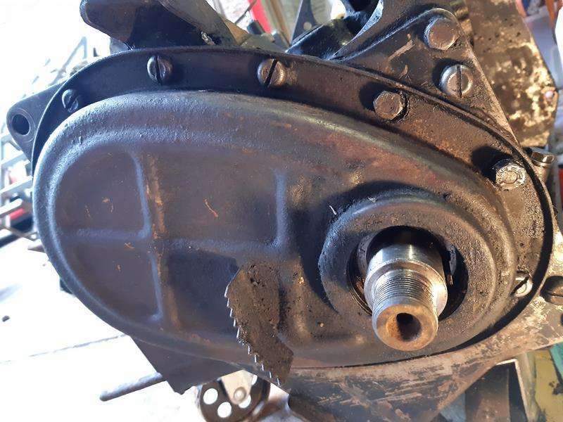

That first picture of the Triumph engine makes it look like the front oil seal was leaking. I guess you will have to put a new one in but I've had new aftermarket ones leak immediately so it's pretty much pot luck if you buy a new one. Mine leaks a bit but I don't care, it's not much and what doesn't get thrown about the front of the engine drips in to the front subframe crossmember from where it can be sporadically mopped up. But then it's more hassle to change on an FWD engine.

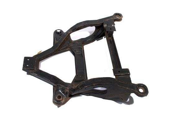

Makes sense as that was pretty filthy at the front of it.

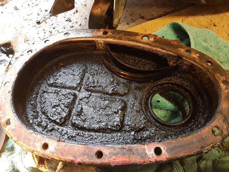

I only pulled it apart because I wanted to flush all the gunky old oil/coolant out. It'd have probably ran fine without but if I was driving down to England and it blocked a passage with bits of sludge and disintegrating sound deadening I'd have kicked myself. 🤣 A gasket set, shells and thrusts will come it at under £100 and it's a day of work even at my glacial working pace, so I might as well do the basics while it's out.
Somebody had gone wild with the silicone sealant around the timing case cover/water pump/sump but there is no sign that the cylinder head has ever been off, the cylinders and pistons look brand new. Pretty sure the 70k odd mileage is genuine

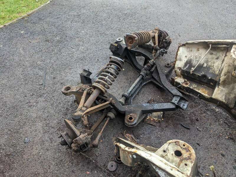

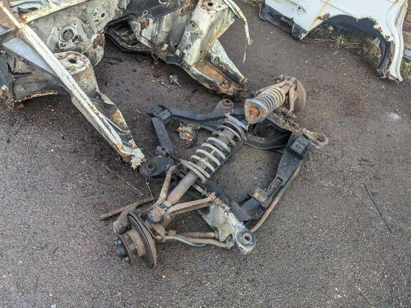

Yeah, does look pretty grotty.  On the FWD subframe the front crossmember has an almost full width channel which makes it quite easy to mop the oil out.
I think the longitudinal part and steering rack crossmember are the same on  all cars but the front and rear bits vary to take the different engine mounts for the various engine gearbox combos available. I think, but don't quote me on that, that the subframes are interchangeable between all cars so you could put an FWD lump in a Sprint if you wanted to. Not that you'd want to but just theoretically.
I was quite tempted to put the engine from my Sprint into the 2dr shell that @Six-cylinderwas selling!

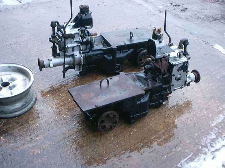

Oh yeah, that's easy. How about going 4wd. Canley Classics still have some of these gearboxes from the Triumph Pony which went in to production in Israel as the Autocars Dragoon.
No idea how it works but looking at the gear lever I can't help thinking it is going to lose some of the slick gear change of the FWD.

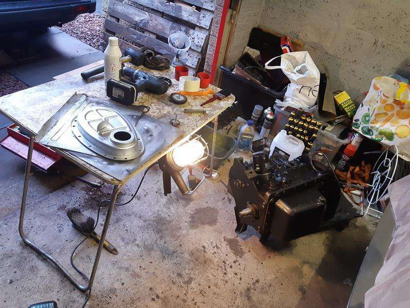

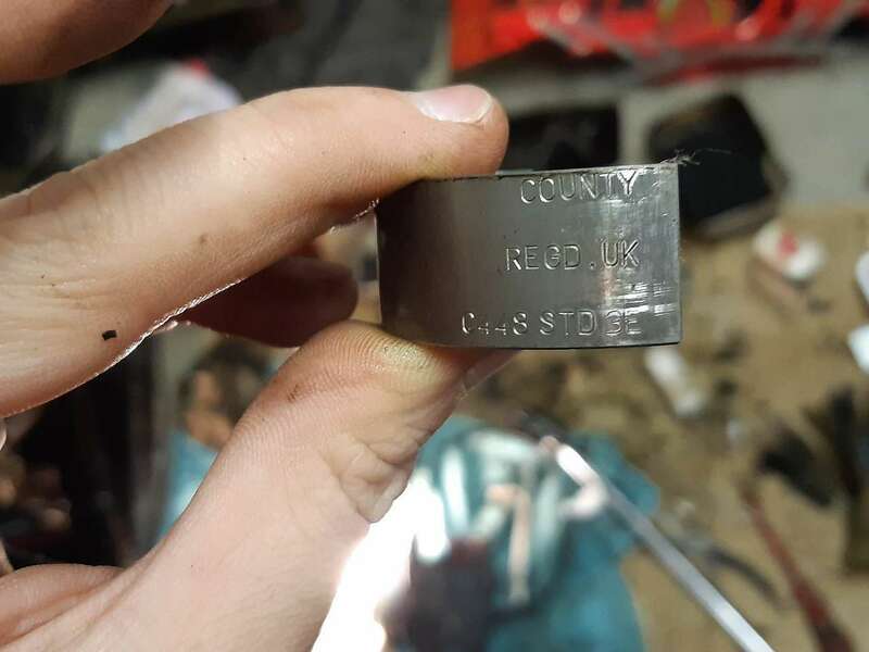

Engine dismantling continues at a snails pace post work. Mostly tediously scraping old gasket off the block/head with a blade. It's probably asbestos so I did the right thing and did it in an unventilated garage.
Eventually I got bored with that so I flipped it over and popped off the sump.
Not exactly sure how long the car has been sat, but I think the jelly like substance was once an oil of some discription, the lower lever of more solid sludge and accumulation of 40 year's worth of old oil.

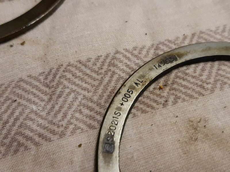

Also, let's check the crank end float! Just by eye I thought this was out of spec, but not massively...
So, thrusts out!
336409233_742238944237369_7468322773179554849_n.thumb.jpg.06d0465c67ae73c6b0b45c7475ae8068.jpg
The phrase "just in time" springs to mind...
The worn out one is actually oversize.
336363535_924575775245816_3381253857013407078_n.thumb.jpg.9398b6d68f2ac97f4aca93ed98d6dfec.jpg
So, thrusts are dead, but seemingly no damage done. Ideal. Big ends and Mains next.
336281615_1366037850901508_5746914587671079956_n.thumb.jpg.229c06290a75109a93d170ea5caa3b15.jpg
335944280_236158885471832_8661687328805306119_n.thumb.jpg.5755ac72dffab41899c457a4c2668419.jpg
333199422_187881247298237_5787969367968671090_n.thumb.jpg.124c437d87f75410a65de30c00f0d885.jpg
336165400_749721946589774_8408160394921460806_n.thumb.jpg.b1cf2e6ac1148764c9e2e42fab4b1987.jpg

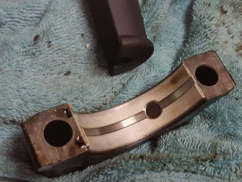

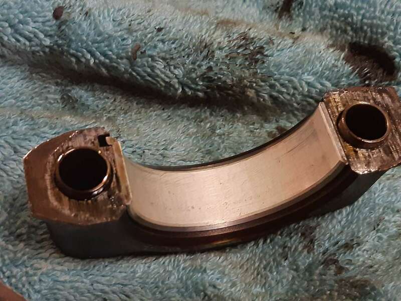

One set of replacement standard size bearings with no real wear on them at all. The only reason I know they aren't stock is the printing on the bearings. I checked the size against a brand new set of big end bearings donated by Mrs @juular and there's no difference in it.
It does beg the question, how can the bearings be so nice when the thrust is so fucked? This is assuming all the engine work was done at the same time, and also that it actually needed an oversize thrust when it was fitted... It could be the oversize thrust was too big and in constant contact with the crank face.
Either way it's all looking good, very glad I checked, reassembling to be carried out pending gaskets etc arriving.

How can those big ends be so good with such shite lube, scrape out sump, wash with petrol or brake cleaner, job done.
Good to see the end float is just about okay. Those big end bearings look very nice too. Certainly not like that purple 1100 engine I had 🤣

I wondered if it needed oversized thrust washer out of the factory? Just thinking 1982 reg, so would have been one of the very last engines built on the line and tooling knackered.

I did wonder if the thrust could be factory, but it seems odd somebody would go to the hassle of doing the big end bearings and not the thrust washers!

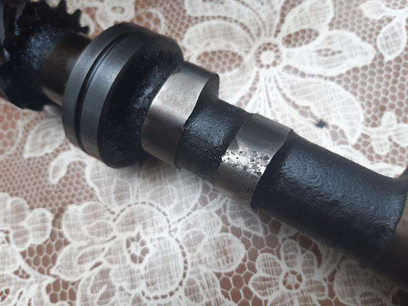

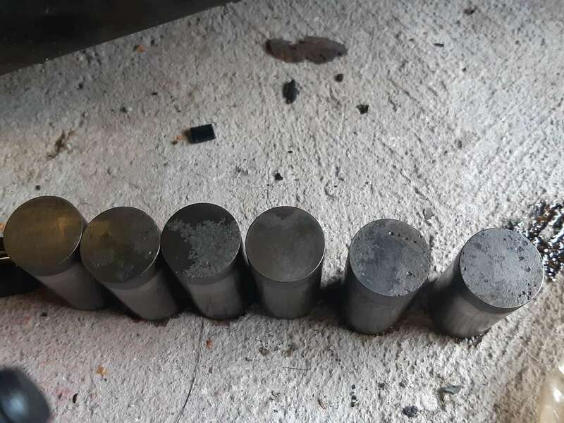

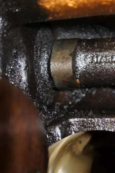

I actually forgot the worst bit of the engine entirely though! The camshaft is fucked!

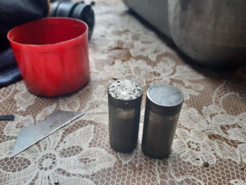

Worrying damage was seen when I started pulling the followers:
336599756_1170390053632974_769748100767150732_n.thumb.jpg.65410597a1ff98f68f459cdf4413eace.jpg
A peer down the hole...
336586072_158544176727498_2296245209135790168_n.thumb.jpg.4cf3ee829f87f2b763b453b1f08fccf8.jpg
Once the sump was off I could get a better look at the lobes from underneath.
This looks like corrosion pitting to me. It's also on both sides of the cam lobe, not limited to the leading edge where most of the force is being applied.
I've had a look at the cam on the spares Spitfire engine and that looks undamaged. Second hand ones seem to run to £30 on eBay so not exactly world ending. Does mean I need to dismantle even more engines though!

Oof. As the engine was a bit unknown (but a runner with good compression) I was worried where the catch was going to be!
Iirc the camshaft comes out the front on the timing end?
Time for a fruiter cam? ;)
Actually thinking about it, shouldn't those bearings be silver coloured, not coppered coloured?
Remember there's 2 cam types, there's a big journal one that runs in the block then a small journal one that uses cam bearings.
Cam bearings are preferable since it doesn't wear out the block.
Not for what they cost! I did briefly look...
Trick of the photos, incandescent lighting on oily bearings. Worn out bearings by comparison look dark bronze in my garage!
Seems the swap to in-block cams was around engine No. FH2500. The Spitty engine is a late one, engine No. FH33 something. So should be a big journal same as all the Dollys and the 1500 lump.
Ah yeah just looked. Starting price is what you paid for the engine with shipping to Scotland and then go to nearly three times that!
Is the original camshaft completely unusable? Just thinking that, providing the cam bearing surfaces are okay, it won't cause any harm in using it?
But then I guess your plan with it at the moment is to future proof it while it's out of the car.
So, I don't really know what the effect of such deep pitting on the cam would be in use. If it was just really light surface corrosion I could wire wool away I'd run it, but the pits are fairly significant.
Ultimately salvageable cams/followers are cheap and I don't want to risk ruining what is fundamentally a really good engine. It's unusual to find one that hasn't been bored/ground out. In theory you could just throw a set of standard bearings in this every 60k and it'd last forever*...
There's the old cam out your other engine laying in the garage btw, I won't use it for anything.

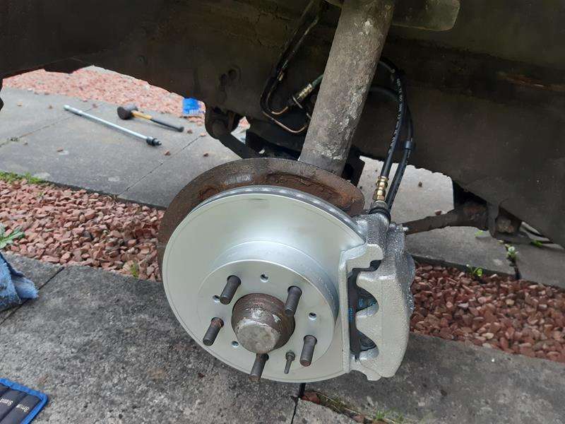

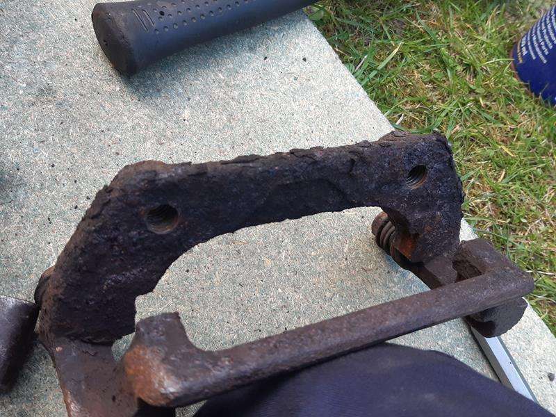

So the Acclaim ran out of MOT at the start of Feb and rather than fixing the handbrake I decided to sort the Volvo first. This ran out of MOT at the end of March.
It had a binding front left brake. Strip, clean, reassemble, sorted.

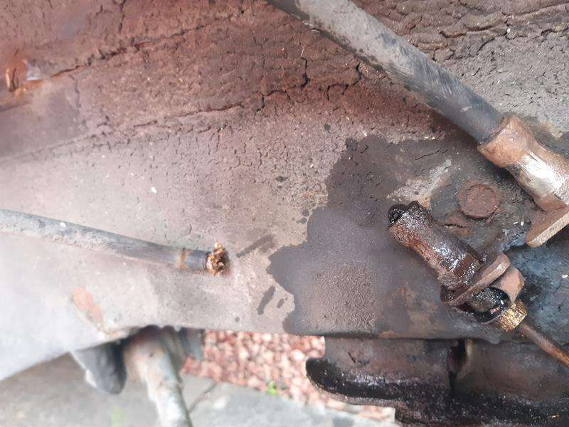

Looks quite crusty...
Oof.
Caliper bores were corroded, pistons were corroded and seized, slider pins were completely seized, massive lip on the discs, brake hoses perished. Same on both sides.

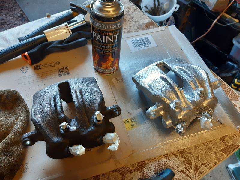

Naturally these calipers are now rare and expensive so I borrowed a drill hone from @juular and cleaned up the bores. I think a lot of the crud was actually bits of piston chrome that'd stuck to the sides as the pitting was pretty minimal.
Then I borrowed a vice from @320touring and some strength from @jaypee and with a combination these, a blow torch, a big hammer and a massive locking wrench the slider pins were freed from the carriers. The bores for these were then cleared out with a Dremel.
New seals and pistons were fitted and a blast with high temp silver paint I had lying about, because it'd be rude not to...
This brake union on the driver's side wasn't playing ball:
So I went out and bought the proper spanner for the job and then rounded the fitting anyway. Clamped it with mole grips and set at it with the blow torch having forgotten that I'd only drained the passenger side of the system... The resulting explosion took out the hose and left me slightly deaf in one ear.
Anyway, got it freed off and put a new flare on the end of the old pipe.
This disc retaining pins were also good fun.
Back together.
I probably should have replaced the backing plates, but couldn't be arsed...
Bled the system and ran it up and down the street, stops in a straight line and nothing seems to be sticking. MOT is booked for Tues...

Fitted new thrust washers, measured the end float, buttoned the bottom end back together. Nothing really much to show there.
Most of what I've been doing is cleaning ungodly amounts of sludge off/out of everything...

This meant I could get the cam out...
Ouch.
Gross.
I did the sensible thing for a budget engine build and bought a new cam...
So, back to scraping gaskets and scooping sludge...
Refitted oil pump and front plate and installed new cam. I also waved some black rattle cans around.
Restored*
Next stage is to get it flipped over, head back on, get the cam/crank/dizzy timing all locked in, then fit the new water pump, back plate, drop in the car and run in...
Mildly bricking it as this is the first engine I've built solo.
  • captain_70s changed the title to Rusty Triumphs in Scotland - Dolly engine , Volvo brakes - 30/04/23
She's pretty grubby in there!
Presumably that cam is less "emissions friendly" than the one in there? And thus more sprightly performance?
In theory. We shall see!
The crud on the inside of the timing cover is more of that spray on sound deadening stuff.

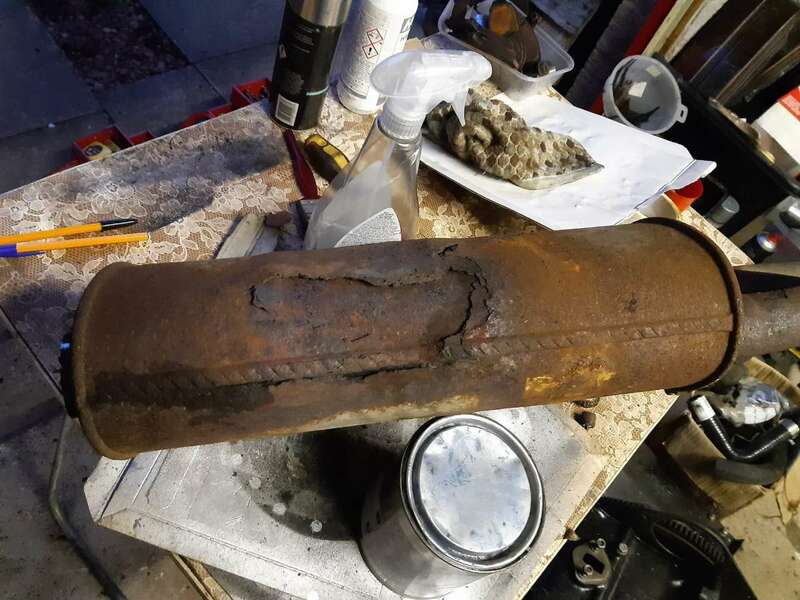

Exhaust blow.... Erm...
This was a rear silencer once. New one ordered. I'm away on holiday with Girlfirend_70s next Weds so it'd better arrive by the end of the week...

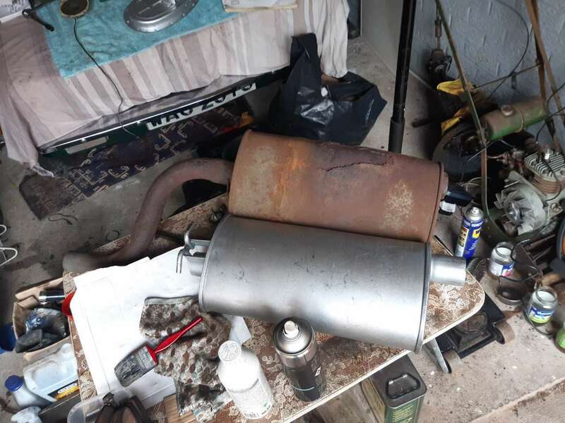

New silencer arrived:
342864634_199927019517903_451557343342741084_n.thumb.jpg.702657cd3a12b15ba8c8a5954110a5d8.jpg
And trial fitted:
342517118_969083320763394_3986132644142247772_n.thumb.jpg.f4940693a567b4d1af29c1ecf4073c48.jpg
It took some real butchery to get the old one free from the other pipes...
