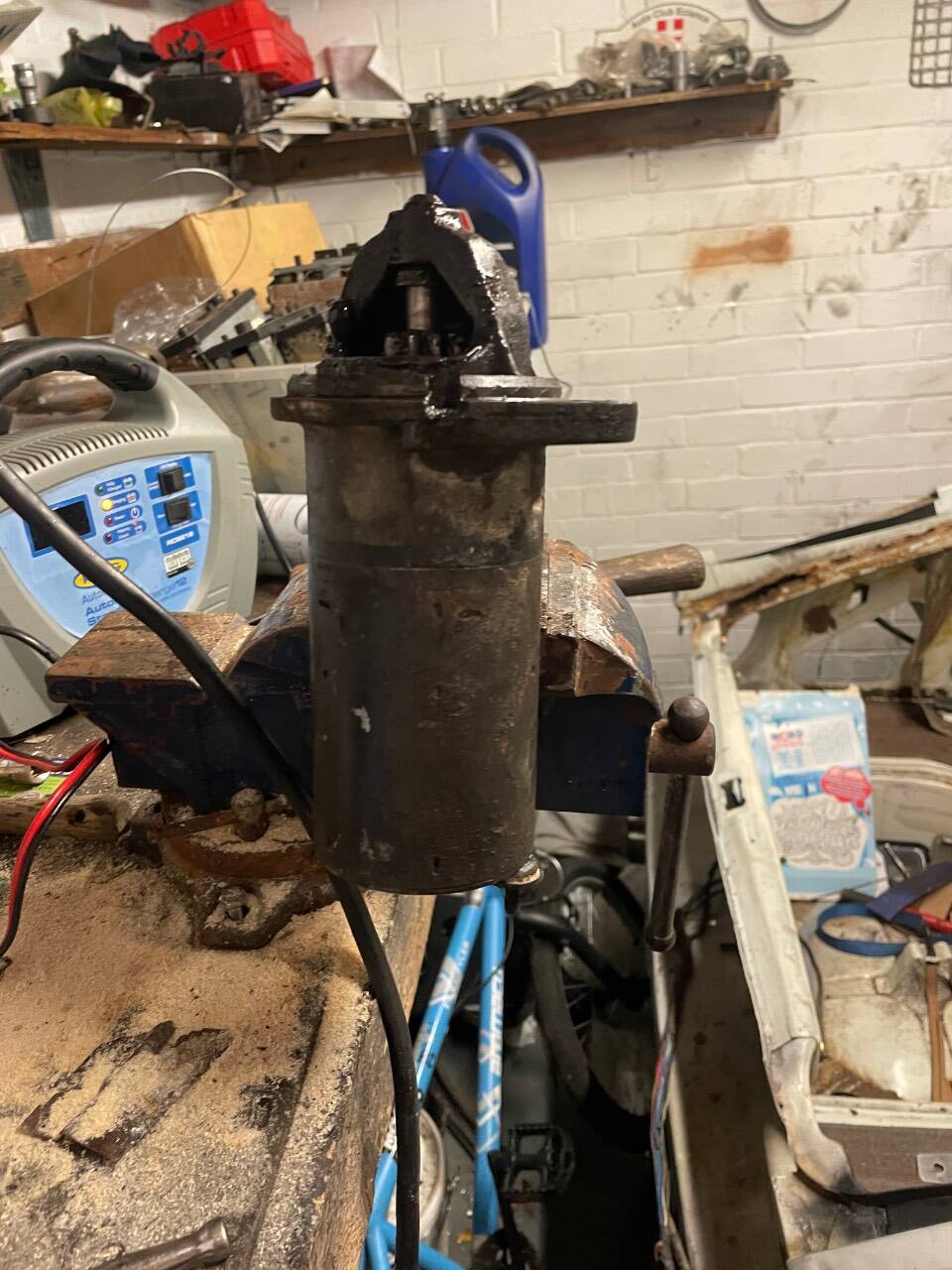

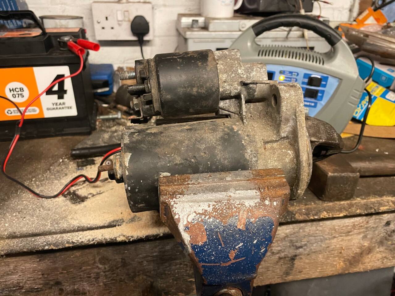

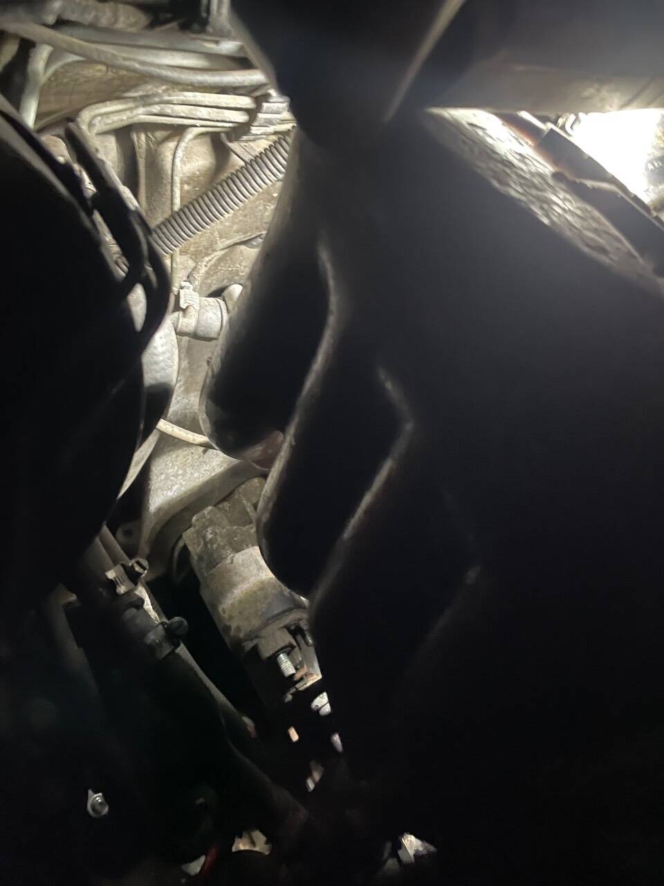

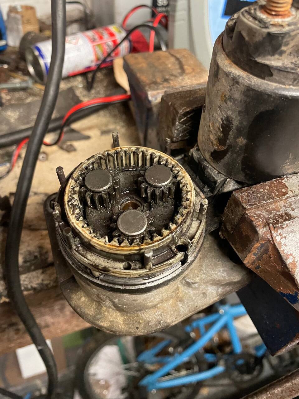

ianbmw Posted October 22, 2024 Posted October 22, 2024 Had to walk the dog, took the worlds nosiest starter motor, took some arty photos …… came home and thought, what shall I struggle with this evening, ah yes, let’s pull the starter out by torch light. negative battery terminal off,10mm nut, 13mm nut, 17mm and a 19mm bolt, then a lump with the wacky stick and start out…….7 minutes from bonnet opening to me closing! A car designed by an engineer who has worked on cars and not just on CAD in uni! Into sketchy shed HQ for sketchy work bench stuff. The start works but is loud…..grinding noises. Pulled the starter apart and re grease and cleaned what I could. However the spindle has a far bit of wiggle at the back, so I’ve greased what can be greased and cleaned what can be cleaner and reassembled. It sounds a little better, but it’s difficult to say how much better it is until it’s bolted on and the bell housing can echo the noise. Or , I’ve made a working starter motor……a non working starter motor…..something like that, sounds like a job for tomorrow.w LightBulbFun, brownnova, grogee and 10 others 12 1

ianbmw Posted October 23, 2024 Posted October 23, 2024 Stop the press! Starter motor reinstalled……. It’s quiet! In fact, it sounds like new! Of course all warranty ends when this post is read, but what a transformation and all for the price of…….zero! Need to grab 4 jubilee clips to replaced the perished fuel hose advised on the MOT and then……dare I say it, it’s ready to go back! IronStar, beko1987, grogee and 10 others 11 2
