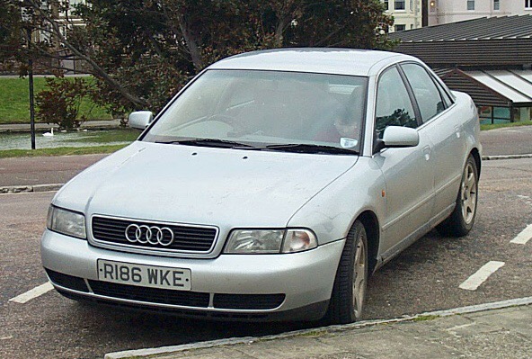

RoadworkUK Posted February 6, 2021 Author Posted February 6, 2021 As well as owning an interesting car, I also own one that isn't. Actually, that's probably not entirely fair any more. On this forum, first-generation Audi A4s were generally loathed as things that you might drive if you're desperate for a premium badge but haven't got a pot to piss in. Time has taken its course now, though, and the attrition rate has seen numbers dwindle. Thing is, because "tarted up Passat", they've never been sought-after as a driver's machine like the E36 3 Series of its age. And they do have some rather annoying design features*, such as their utterly baffling front suspension design with troublesome balljoints in strange and unsettling places. But, in my experience of owning this old shed for WAY longer than I ever expected to, it's proven ridiculously solid and dependable. Even inert. So in reactivating this previously aborted thread, I'm offcially declaring a 21 year-old Audi A4 to be a car worth having. Anyway. This weekend, I finally got around to finishing a job that I started seven years ago. I've just lifted the previous couple of instalments from my (more interesting) Rover thread, but as documented above, in 2014 I set out to rid my A4 of this: EUUUGHHH. Horrible cheesy disgustingness. Turned out that the cooling system was absolutely full of that stuff, but my initial fear of head gasket armageddon fortunately subsided. It turned out to be, almost inevitably, the OTHER possibility; the wretched coolant-to-air oil filter heater thing that VAG insist upon. Basically, it was buggered and was allowing oil and water to very gradually mix. The thing had been gradually doing its evil mixology for a number of years, until there was more Primula Cheese Spread in the system than actual coolant. Anyway. I completely rebuilt the cooling system and flushed it out sufficiently to rid the car of all that hideousness; and to prove the point, here's the same expansion tank cap as photographed today; seven years on. Very splendid indeed, I'm sure you'll agree. EXCEPT: That cap is broken. Some of you will recall that we have a Peugeot 306 in stunning Bermuda Blue in the fleet. I thought it would be a really nice idea to give the old warhorse a well-deserved spell of layup after behaving itself so beautifully, tucking it away in the garage and pressing the Audi into service. It's a bit of a lazy git these days; I'm largely working from home and invariably have company wheels to biff about in when I need to anyway. So the Pug would have a nice little rest. Or that was the plan. On a suitably drab Monday morning, my wife made it about 75 feet up the road before swiftly reversing back to tell me that the coolant warning light was on. So, in dressing gown and slippers, I grabbed some OAT and the kettle (I figure using pre-boiled water is a good thing but it probably makes no real difference), popped the bonnet and twisted the cap. And half of it came off. The other half was entirely disinterested in leaving the header tank. After rescrewing and unscrewing three times, I gave up. Nicola went to work in the 306, and the Audi went back into the garage, yawned and went back to being a lazy bastard. What it didn't realise, though, was that it had given me good reason to start fiddling with it again. You see, the one bit of the coolant system I had never got around to replacing was the header tank. I actually had a replacement knocking around, but because it hadn't arrived in time for me finishing the job when I sorted the horrible cheesy coolant emulsion episode out, it sat on my shelf for seven years. Until today. There's the new, sparkly one (which, bizarrely, comes without cap; I've had the bottle for seven years but only bought the cap last week), next to the old absolutely repulsive one. The (empty) tin of chopped tomatoes would be pressed into service as a catch tank for whatever was in the bottom of the old tank or the bottom hose when I disconnected it. As it happens, the actual amount of coolant left in it was bugger all. I suspect quite a lot has been lost out of the top of the tank, via the broken cap... as well as the coolant leak that I know the car has, and that I need to fix at some point — it's at the flange between engine and bulkhead and looks a proper git to access. As it happens, the job that I'd put off for seven years took me about half an hour. Look at my gorgeous expansion tank and the lovely clean coolant visible through its virginal, unsullied skin. So that's it, really. I fully acknowledge that I could have simply written "I changed my car's expansion tank" in the News 24 thread, but that wouldn't have wasted everybody's time, would it? jon.k, Shep Shepherd, Skizzer and 10 others 13

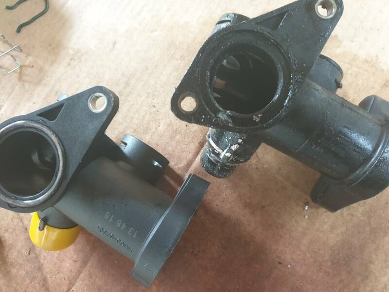

RoadworkUK Posted March 8, 2021 Author Posted March 8, 2021 A substantial factor behind my preference for old snotters is that I haven't got very much money. This accounts for one of the puns in the title of this update. Among the snotters in my fleet is an old Audi, which for quite a while has suffered a coolant leak. This accounts for the other pun in the title of this update. Last year, the tame mechanic who usually absorbs the work I frankly can't be arsed to tackle quoted a thaaasand paaands to deal with the leak, along with the weak engine mount that had been noticed previously. I took that to mean that they really don't want the work, thank you very much indeed. So I ran that through my man-maths computer, and it said "If I fix the leak myself, I can spend £500, guilt free, on all manner of other crap". I had previously stuck my head under to watch the drips and determine from whence they came, and the answer is the "coolant flange". This is a thing, possibly named by Finbar Saunders, that lives in the most inconvenient place imaginable, between cylinder head and firewall, with wires and bits of pipe going hither and thither to obstruct access. What I didn't want to do was to stick a bottle of Radweld in it, thinking that that's a mugs game and it'll only conspire to block vital passages like automotive cholesterol. So I phoned Audi to get some genuine parts, and they said that they genuinely don't stock it any more. So I phoned my local Jayar and it was on the shelf. Because of course it was. So, the bit I had to get to was the thing with the blue bit sticking out. Said blue bit is the coolant temperature sensor; to the right of that is a blanking plug that fills a hole where another sensor would go in posher, more splendid versions of the same engine. I went under the car to see if there was better access from below, but of course there wasn't. There's far too much subframe / bodywork / gearbox / turbocharger in the way. While down there, though, I also noticed signs of dried OAT coolant on the water pump housing, which was last changed during the cambelt change documented upthread. HMMM. Well, I'll just not think about that for a while. So, for the next several hours I contorted my arms into shapes I had never previously imagined possible, as well as removing much of the skin from both hands. In the same process, I used every single combination of 10mm sockets, ratchets of different sizes and extensions of different lengths to get to the most wretchedly tight spots I'd ever encountered in vehicle maintenance. Here you go. I managed to wiggle the phone in to get a view of the bastard in question. In fact, I found the phone camera invaluable for giving me even a vague idea of where things were. Otherwise I was doing things entirely by feel. Anyway. The coolant flange, as you can see, has an encrustment of old coolant buildup and that looks decidedly sub optimal, so I got properly stuck in. About thirty seconds before the police could turn up and drag me away for breach of the peace, I got the bugger off, having even managed to safely disconnect the worlds most inaccessible heater hose. Naturally I went insde and ate toast to celebrate. . Rather gratifyingly, the old one (on the right) was thoroughly fubar'd. Not only had the o-ring that runs between it and cylinder head decomposed to the consistency of three day-old Hubba Bubba, but the plastic was fractured on the inside of the ring itself. This, I thought, was superb news. Thoroughly gee'd up, I fitted a brand new coolant sensor and a brand new blanking plug ( a parts total of £24) and readied myself for reassembly being the reverse of disassembly. The only difference, of course, being that this time I'd be scrabbling around to find the holes that the bolts go into, rather than the bolts themselves. So I wriggled my way back into the gap that didn't exist, through the labyrinth of awkwardness. To my roster of injuries I then added bruised and grazed shins from kneeling on very pointy bits of engine, as well as a pronounced ache in my knees from bending them the wrong way. It was around this time that I wished I was about 4'9" and slender rather than 6'5" and 16 and a half (ahem) stone. I am NOT a nimble man. Anyway, fractions of a minute before I could be pronounced medically dead, it was done. Fitted, coolant topped refilled, all good. At this point my wife turned up from work; having had a relatively cursed day, she suggested perhaps I pop to the chippy for battered sausage and chips twice. A terrific idea to get the coolant circulating, and an opportunity that I eagerly grasped. Here is the car parked outside the chippy. All good. The temperature read spot on and when I arrived home the coolant level was as I left it. Or it certainly seemed that way. Next day I woke and, as eagerly as looking for presents on Christmas day, looked for puddle below the coolant flange. There wasn't one. There was, though, a small puddle below the water pump. Evidently, with the coolant now denied from leaving via the easy route, it had protested by finding the next easiest. So I put a bottle of Radweld in. Mugs game, but sod it. busmansholiday, Vince70, Shep Shepherd and 13 others 16

RoadworkUK Posted March 10, 2021 Author Posted March 10, 2021 Update on this: This morning, the telephone rang and it was my wife. It's always rather ominous when that happens; it usually means something has gone wrong with the car and she's marooned. "Something's gone wrong with the car", said she. My initial suspicion was that my repairs hadn't held and all the coolant had been vomited out and the head had been cooked and armageddon was taking place, but no. She'd lost drive. She put me on speakerphone so I could listen to the racket when she tried to engage a forward or reverse gear, and it was pretty agonising to listen to. SO. With me 20 miles away, and unable to do anything other than point at it while sucking air between my teeth if I did head out to "rescue" her, the RAC was called. My immediate assumption was that, after 145k and fairly frequent bouts of "making good progress", the clutch or flywheel had disintegrated, and the replacement of either / or would be a £££ situation. Shows what I know. RAC man diagnosed a stuffed nearside driveshaft, which immediately had me going "aha, of course!" Car was dragged to the tame garage that looks after all my old snotters when I CBA, and I got on with my mundane afternoon's sub-editing. At 16:30 I headed out to pick my wife up from work – it had broken down literally half a mile from her office. No sooner had she put her seatbelt on than the phone rang. It was the garage to tell me that I could collect my FRESHLY MENDED Audi. Remarkable, really. £204 for a new driveshaft fitted. Strikes me as reasonable – even if I had the right tools and the part, it would have been a weekend's work (because I'm a hopeless bungling amateur). So it's back on the drive. Look: See, I'm not making this shit up. IN OTHER NEWS: After getting the car home tonight, I thought I'd check the coolant level. It looked to have gone down a bit. But then, when I loosened the cap and depressurised the system, it returned to the full mark. I'm tentatively declaring RESULT. Fumbler, gm, loserone and 21 others 23 1

RoadworkUK Posted May 30, 2021 Author Posted May 30, 2021 Dunno if you remember me being all cock-a-hoop about the fact that this fabulous conveyance was finally watertight, in as much as the coolant was remaining within the cooling circuit, rather than cascading into the world without? Yeah. Turns out that was bollocks. So, once again I find myself in this situation: Yeah. So, when I did my annual swapover between the Audi and the Rover, after reversing the Audi into the garage I noticed a nice trail of pink fluid up the drive, and a smallish lake of the stuff on the road itself. Yes, the water pump was borked. So, being that the Audi is going into layup for the summer while I use the Rover (and any other handy automobiles that come my way via work), I figured I might replace the water pump. And, while I'm at it, I might as well do the cam belt, which is due within six months or so anyway. In for a penny, in for a pound. This time, though, I'd be all wise and professional about things, and do things the way a Qualified Audi Technician would. No removing the entire front end for me — I'd use the actual, proper Service Position. So, Laser's version of Audi's official Special Tool was procured at great expense, so I eagerly put the kit to use. To whit: That, ladies and gentlemen, is the service position. It's rubbish. From above it offers all of four inches of extra working space. For somebody as impressively cackhanded and abnormally proportioned as I, that's not a lot of room for accessing awkward, stubborn bolts and heaving off bulky components. So I decided that the service position could get in the sea where it belongs, and elected to drain the coolant (what was left of it) and pull the whole front end off again, in time-honoured tradition. So the usual teardown commenced, and after several hours (spread over two days) I got to a point where the water pump and timing belt were both off. The water pump was utterly, utterly ronnied. There's about 3mm of slack/ play in the shaft and it rotates as smoothly as a paddle in a bucket of Duplo. Slightly astonishing that it's only been on the car for five years or so. Grim. One of the most gittish parts of the water pump swapover is the fact that, when reassembling, there isn't a single bolt that fixes the pump itself to the cylinder block. Instead, it's sandwiched in place by the power steering pump bracket, with four through-bolts that pass through the pump housing, and a further four for the main bracket just for shits and giggles. And all of them are in really awkward positions, which would have been hellish with the 'service position' set. Also, the rubber o-ring doesn't defy gravity very well when you're trying to line the pump up with where it should go — so I glued the o-ring to the pump using some instant gasket. After quite a lot of swearing, the pump was in place and secured. So that's that bit sorted, hopefully. Hooray. Rather less hoorayful, though, is this: What that is, is some of the cam belt tensioner. The hydraulic damper (basically an extremely poweful spring that acts on the tensioner pulley) is held in place with two bolts, which are torqued to the block at 7lb ft. The tensioner idler pulley is attached to the same tensioner assembly by a third bolt, which The Internet seems to have pegged at 15lb ft. Note the idler pulley bolt doesn't pass into the block, just into the tensioner. So I attached it to the tensioner, and started to torque it up. But it just didn't seem to be getting any tighter. I was getting nowhere near 15lb ft — in itself not exactly a huge amount of torque. So I unscrewed it, and away came half the thread. Fucksticks. On a second attempt, I couldn't get it anything much more than finger-tight. Clearly no good whatsoever for something that's got to put up with thousands of RPM acting against it. So that's put me in something of a black mood. My choices are: Say "What the hell. If it lets go, it lets go". This approach seems tantamount to a death sentence, so I'm disinclined to follow it. Re-use the previous one, which has been on the car for five and a bit years. This is probably doable. But it involves re-compressing it, and forcing it in the reverse of its usual direction, under colossal pressure and after five years. Or, buy another tensioner. Pretty sure I can't return the one whose thread has stripped. I mean, yeah, maybe it shouldn't have stripped, but maybe it was my heavyhandedness that caused that to happen? Plus I no longer have the packaging, and it came as part of a kit anyway. So I've ordered another tensioner (£65) on the basis that lightning won't strike twice. Work will recommence in a fortnight. And I'll be reading up on how the hell people actually fit these bloody tensioners and get them torqued properly without bad things happening. Twiggy, djim, juular and 5 others 8

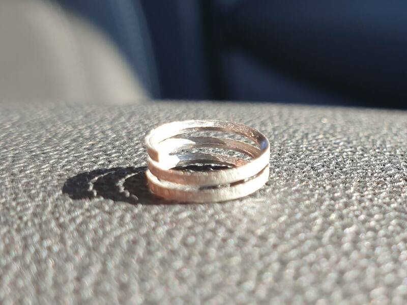

RoadworkUK Posted June 27, 2021 Author Posted June 27, 2021 Yo yo yo. MAJOR progress on this today — I'll do a proper write up soon. BUT FIRST Right. The above pic is the closest I can find to what I'm trying to describe. Basically, the Audi has six or so S-shaped clips that hold the fan wiring in place. O is about 5mm or so, enough to take two strands of thickish cable; A is about 1mm and grabs onto the thin plastic outer ridge of the fan shroud. All six clips, which were once made from steel, have now degraded to wafer-like levels of robustness, and simply crumble away when I try use them. ,Does anybody know what the hell these clips are actually called? I've put any number of combinations of AUDI VW CABLE CLIP RETAINER WIRING FAN SECURE HARNESS WIRE MOUNT AEB B5 etc but to no avail. Replacing them is pretty much all that stands between me and getting this muvva back together for good. Cheers!
Jenson Velcro Posted June 28, 2021 Posted June 28, 2021 https://www.ebay.co.uk/itm/321565035980 is the sort of thing
RoadworkUK Posted June 28, 2021 Author Posted June 28, 2021 Hmm. Cheers, could be... a bit hard to tell from the pic!
