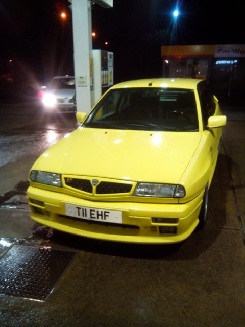

are you sure there is no jack and that it isn't in a cunning hiding place
Guest Breadvan72
Most shite cars I buy have no jacks.  WTF do people do with them?
There is a space for the jack and that space is empty.
I have got the space saver, shitty wheel brace and towing eye, nowt else.
The mini toolkit I brought, which consists of socket set, gaffer tape and cable ties is of no use today.
I think some Alfa's ,like 155's may use the same mounting, bore and offset wheels. Not ideal but may help temporarily. Is petrol shot a good sign?
Does maintaining thread silence mean he's driving? Or chucked his phone in a temper?
I've never checked the wheel nuts on a car I've just bought, but having seen this and beko's wheel loss incident I think I will from here on.
Home ... under my own power.
12 hours since I left for what should have been a straightforward collection.
Ok, the car, ignoring the loss of wheel bolts, it's got a few faults.
Currently not working:
Speedo
Thermostat, the car stayed at 70C all the way home, in traffic it got to 90C, so I'll take this to mean gauge and fan are ok, stat not.
Other trivial shit.
The car is very hesitant and doesn't seem to run properly most of the time. I'll put this down to not being used much in the last few years (last taxed 2011) stale petrol and probably running rich with the u/s thermostat. Unfortunately with a few missing wheel nuts I wasn't comfortable giving it a proper Italian tune up, also with the running temp being low I wasn't sure how much good it would do.
To Do:
Cambelt & water pump ... only 7k (plus broken speedo) since belt was done, but also 7 years
Thermostat, to be done with the above.
Filters & oil change ... check plugs & leads.
Once the above are done hopefully it'll be running better.
On the plus side, it sounds awesome, and on the odd occasion I did depress the loud pedal (and it fired properly) it went very well, fingers crossed it is just in need of a bloody good service.
Ps. Hairnet, yes I was just outside Hollingworth.

At present I can't see any damage to the car from the loss of bolts, the wheel moving on the hub occurred with just one loose bolt in, so the wheel centre (in the dark by the side of the road) appeared ok.

They're Dedra hatchbacks essentially. Check and clean earth strap on engine as they're notorious for causing running problems. Wheels should be Tipo spec. Check floor to sill joint for corrosion. Other than that, ENJOY!

Yes it is based on the Tipo platform and being this spec it should share quite a few parts with the Fiat Coupe 16VT, fingers crossed the speedo cable is one of them.
The switch gear, heater controls etc. are identical to an Alfa 155 (also Tipo platform) which I find handle very well. I do have a front upper strut brace for an Alfa 155 I never fitted to mine, which I'm hoping should fit this.
Cheers for the tip on the earth strap, I'll check it in the morning.
Wheel troubles aside I have to say that's a gorgeous looking car! What engine does it have?
The engine is the 2l 16V turbo ... same as Delta Integrale, late Themas, Alfa 155 Q4 and early Fiat Coupe.
