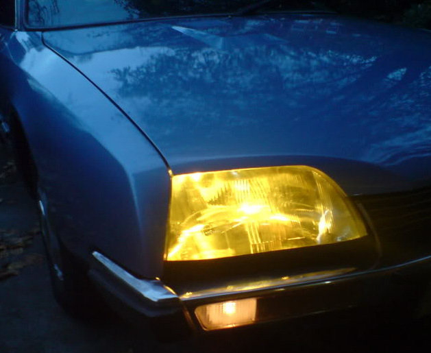

forddeliveryboy Posted November 5, 2014 Posted November 5, 2014 So now it's dark for a few months and roads seem to be damp even on drier days, which cars have the best lights? And what's the answer to making a huge difference to crap modern dipped headlamps, HID kits, Cree LEDs? Or just doing the old relay thing and grinning and bearing the slightly-less dim lighting, thinking how rap everything now is. Loads of French cars from the seventies seemed to have bloody great lights, the reflectors were often huge. I'm thinking about Citroën GS/a in particular. Old Rolls-Royce seem usually to have decently sized lights, also. Tell me how to see better, using modern light units. I'd like to graft a pair of GS lamp units onto modern stuff, but it would be difficult.

forddeliveryboy Posted November 5, 2014 Author Posted November 5, 2014 ^^ True. The CX lamp unit is so deep it almost reaches the inner wing. Later twin-optic lenses showed that the engineers couldn't give a damn, anymore. They just stuck a divider into the reflector with main beam on one side, dipped on the other.

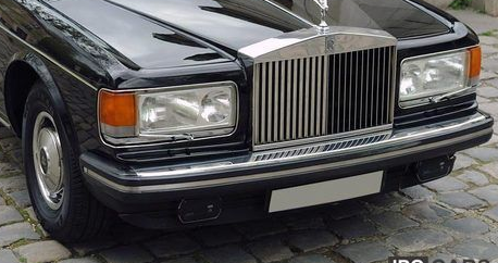

pshome Posted November 6, 2014 Posted November 6, 2014 The best of all lights ever has this car, but you all knew this, didn't you? r.welfare, Junkman, Uncle Jimmy and 1 other 4
