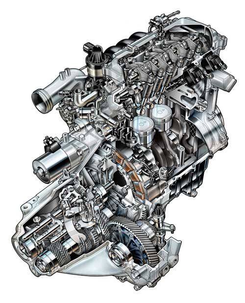

And because threads need pictures - cutaway drawing of the power unit of a Mk1 Honda Insight.
^ Yeah the batteries are very similar in spec and physically interchangeable, but the Battery Control Module expects to see cells with a capacity and discharge curve the same as the originals. As soon as you put in different cells, they only have to drift out a tiny bit and the BCM flags an error and disables the battery for safety. You can put in a BCM interceptor or fooler, but as Asimo says it’s quite a lot of work. I expect if you took the BCM off a Civic IMA as well, it would probably solve the problem, but again it’s a lot of work and expense just to find out. Not sure if anyone has tried that.
A lot of Americans are just moving to using a lithium battery from a Fit when their NiMH batteries completely give up, and bypass the BCM completely with a custom made module.
