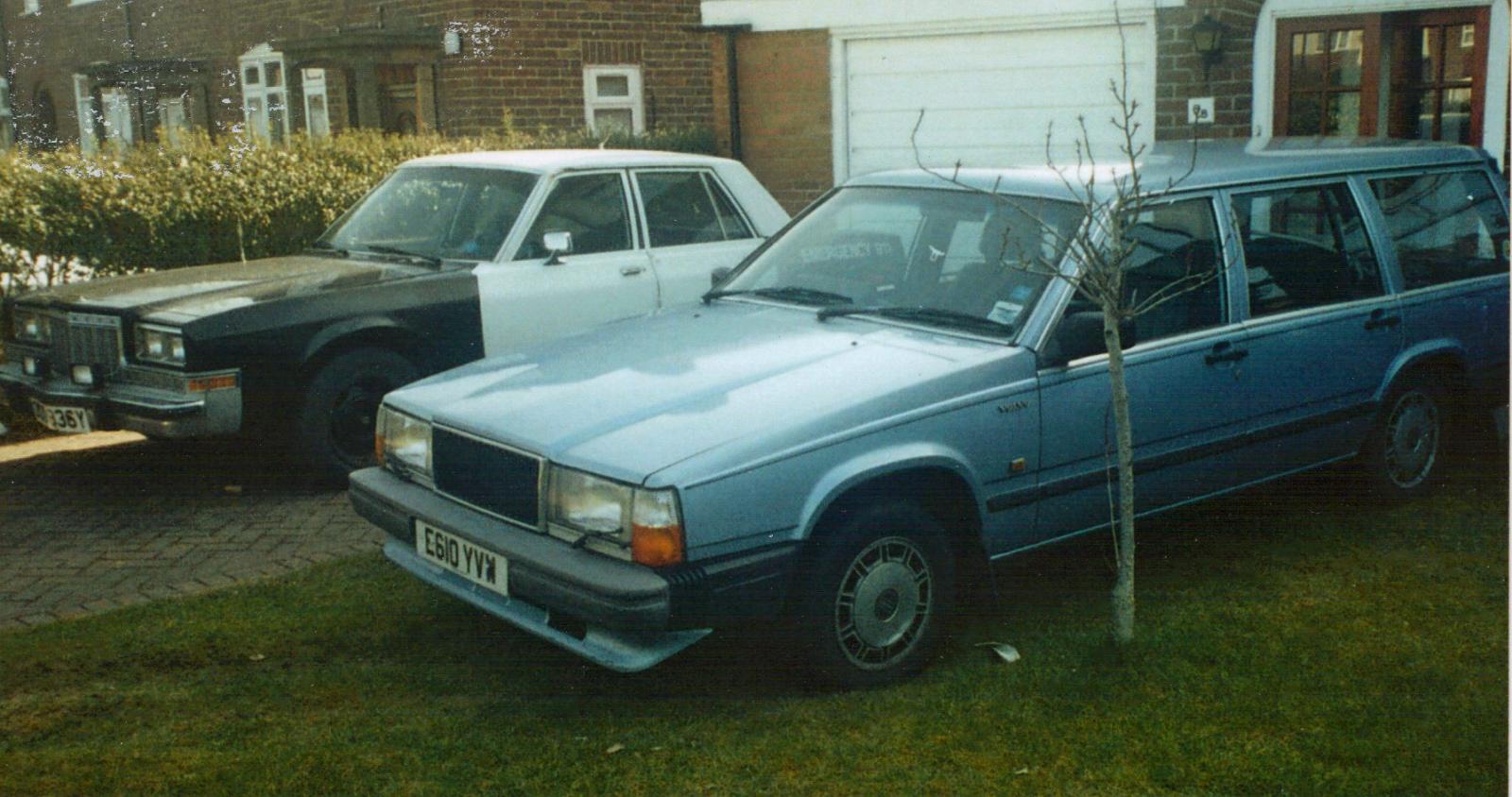

eddyramrod Posted April 10, 2015 Author Posted April 10, 2015 Save up? What language is this you speak, sir? Us poor serfs on Minimum Wage never get to experience such things, especially when your boss decides you're going to be paid monthly rather than weekly, despite overwhelming objection from his workforce. But yes, the rest of what you say is perfectly sensible. I don't want to spend any more on it, I don't even want to tax it at the end of this month. I'd rather tax another Volvo.I am in a position to make the comparison and yes, I would always prefer to be driving the Detroit product, but the fact remains, they are over budget. If I want to leave the Wheelchair Bus available for MrsR then I need to have "a" car I can rely on to get me to work at 6am. However, just "a" car, "any" car, doesn't really work for me, so I have to look for something that little bit more interesting, in budget. At the moment, the Volvo I've bid on is the top contender. If nothing else, it would allow her to have the Wheelchair Bus back. danthecapriman and Junkman 2
