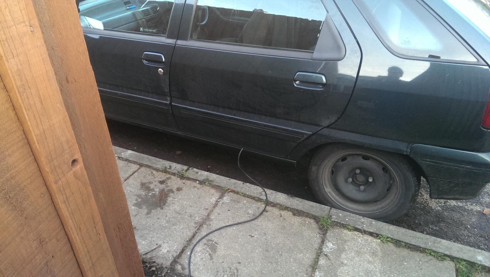

Spent 45 minutes rinsing it! Grit and shit was pouring out of the panel gaps, I also did all the door shuts and the boot surround. An unholy amount of mud washed out of the rear arches too!
I then foamed it

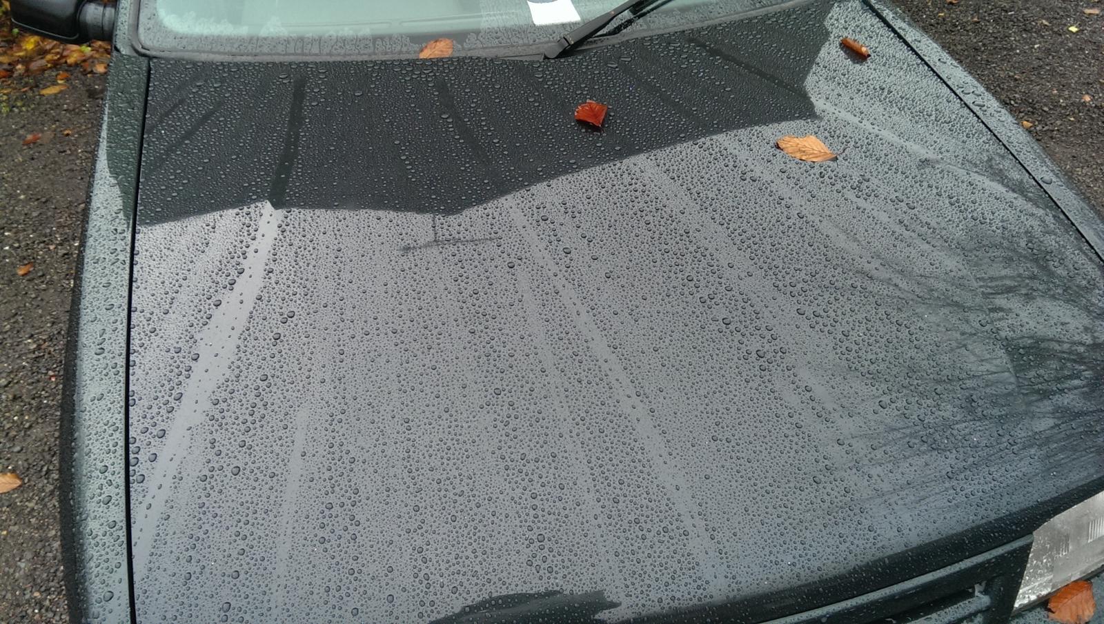

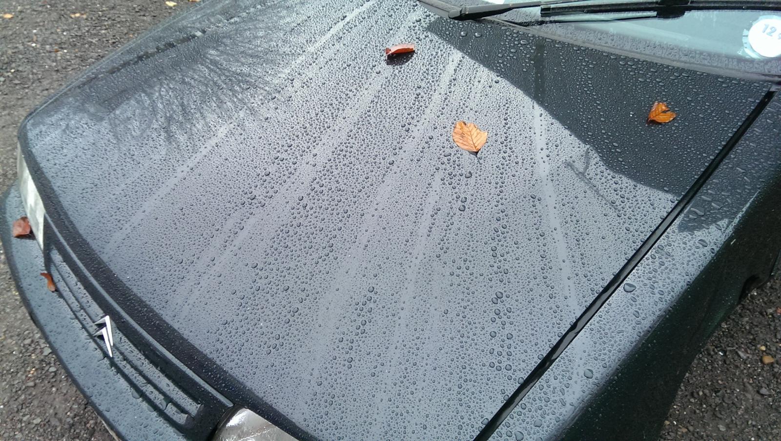

Took some beading porn shots earlier, can't wait until the whole thing is like this...
They stay still up to a gentle 40mph then gently flutter up the bonnet and away! This very pretty! Still not got used to seeing a reflection in it yet...
Beading on fresh wax is just lavley, 'specially when it's raining.

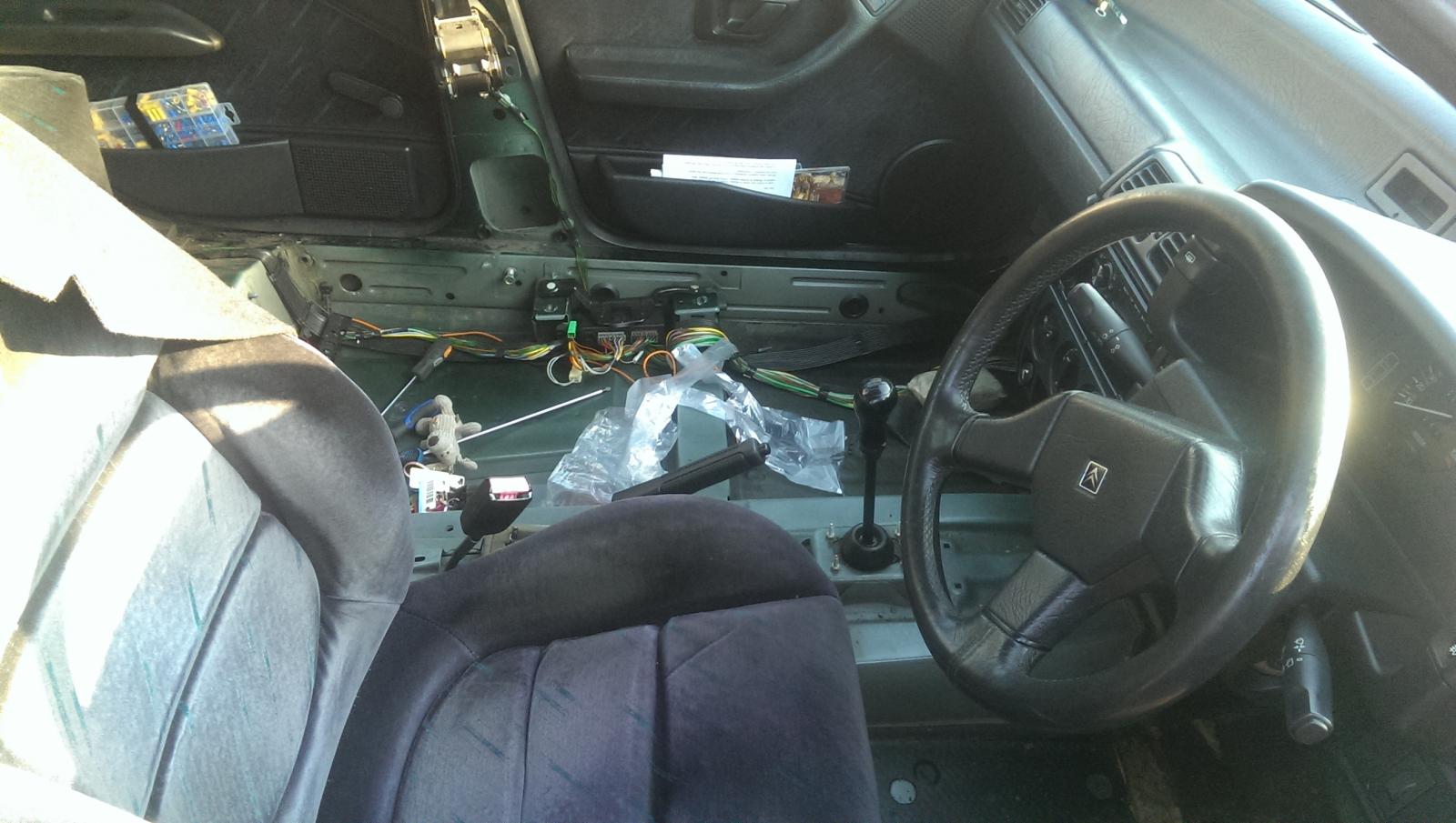

Well, I have a wet interior...
Yesterday was spent completely stripping it out, and drying it up

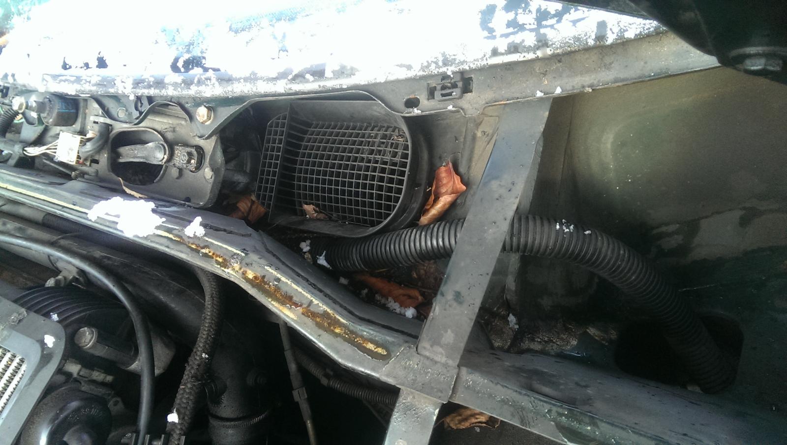

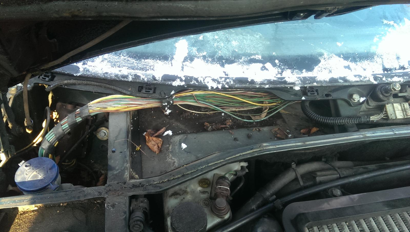

Started with the scuttle panel, in case of blockage
Nothing was blocked, so I vacced all the old leaves out and cleaned it up a bit

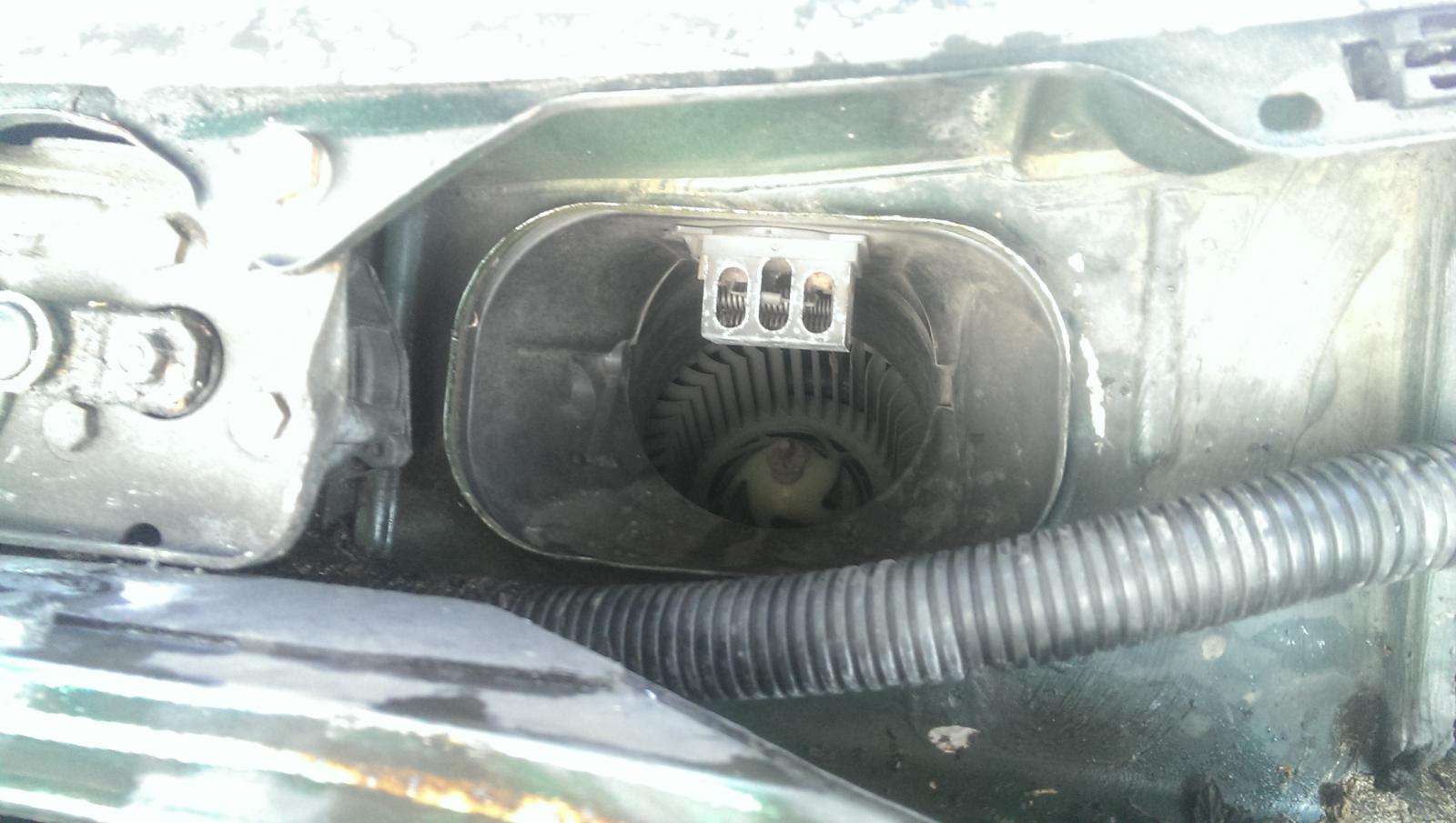

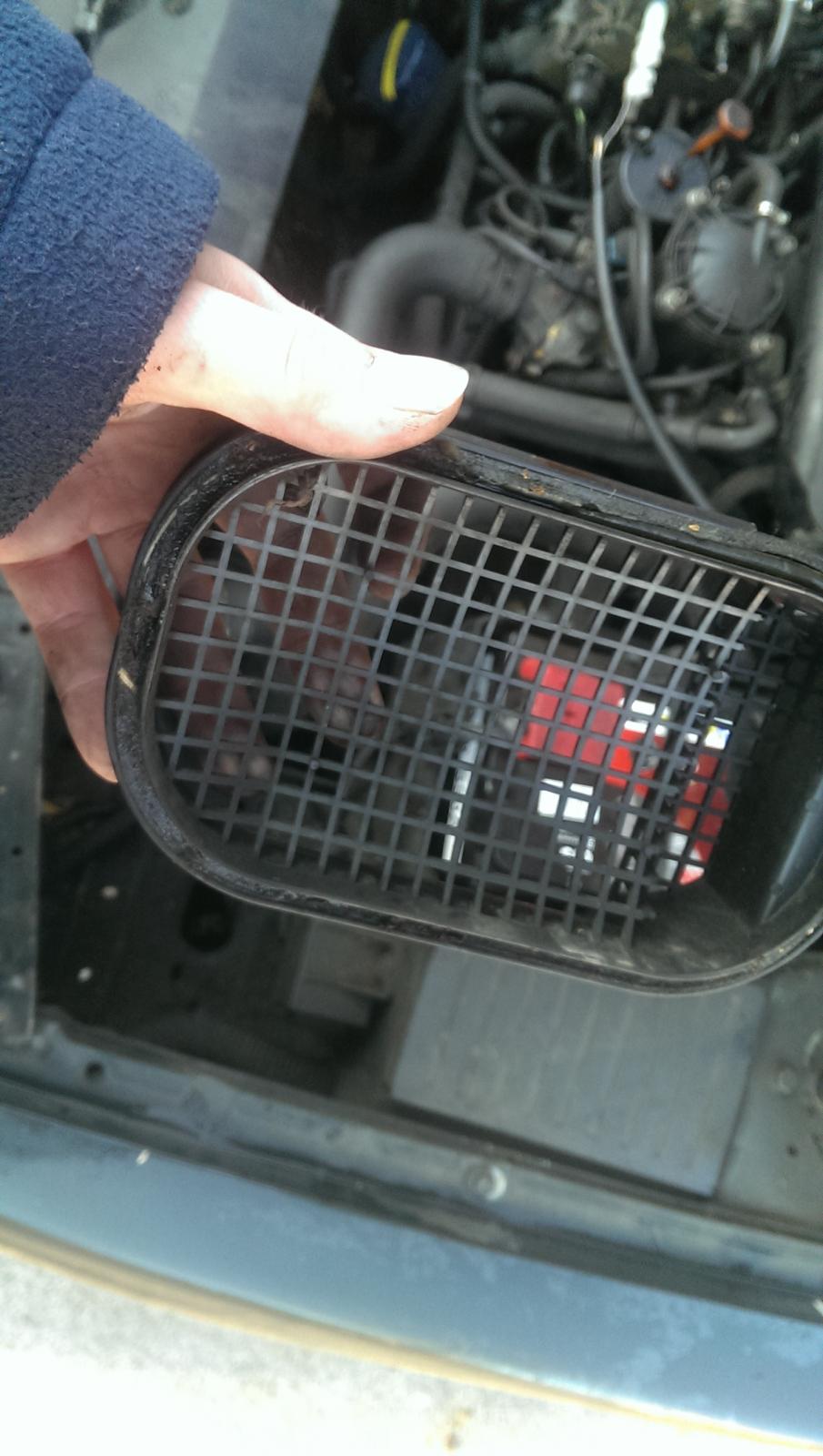

The heater air intake cover fell off, the sealent was dry and cracked
Vacced out the leaved and shit inside the fan
Found the half tube of sealent I used on the merivas sump, cleaned the old shit off and ran a nice thick beat, and squeezed it homehome

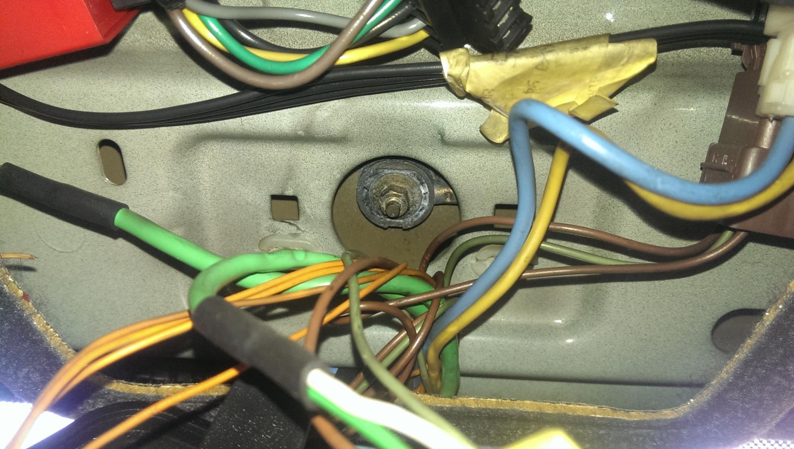

Stuffing loads of microfibres under the firewall deadening seems to have helped a bit, it's not quite as sopping wet. May go and move them around at lunchtime. One annoyance is there is a seam in the floor of the drivers footwell, which the back of my clutch foot keeps catching if I don't think about it!

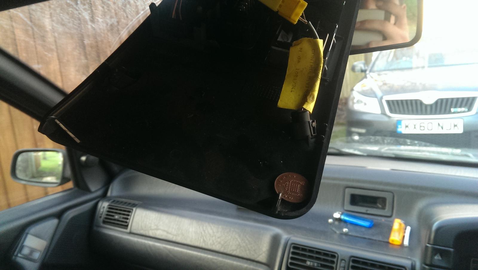

Got to go home at half 1 today because Christmas, so had a few minutes with the zx.
Upon dropping the light cluster the first thing that struck me was a penny... Handy as it must have been causing the annoying vibration, and me punching it must have moved it for a few mins before it came back.
Either way, no sign of leaking from the aerial base

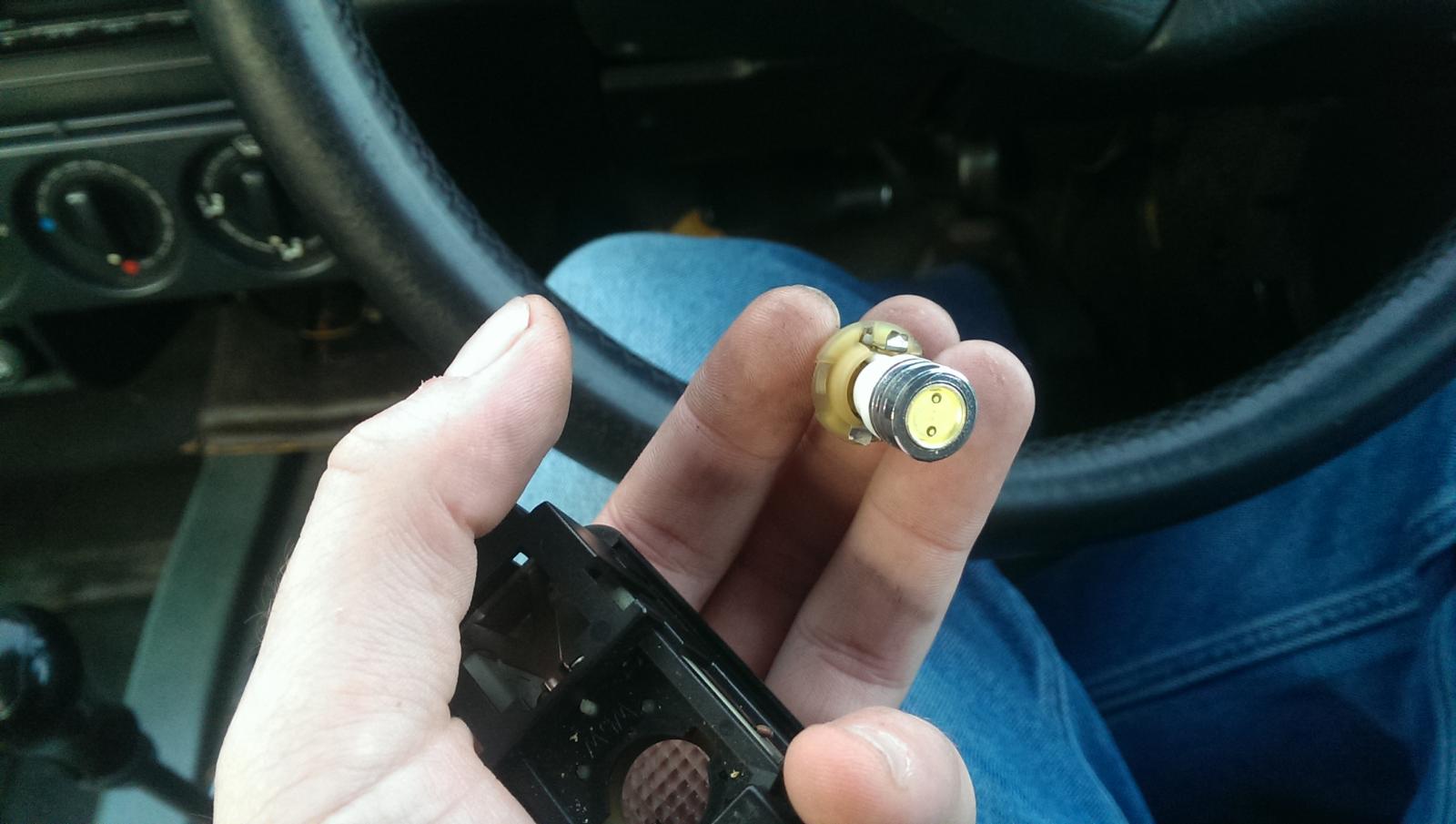

Found out why the interior light is so shite, led!

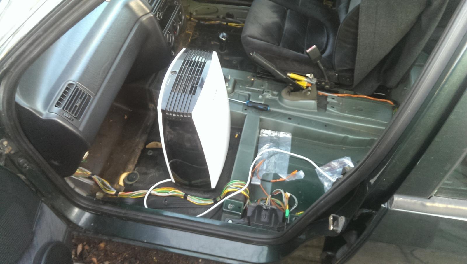

Having found nothing, I put that back together and grabbed the dehumidifier. The microfibres stuffed under the sound deadening had worked well, and were sopping wet, so removed those, and wedged the foam up with some empty beer bottles
So far after an hour..........no water removed...
May restock the microfibres tomorrow!
