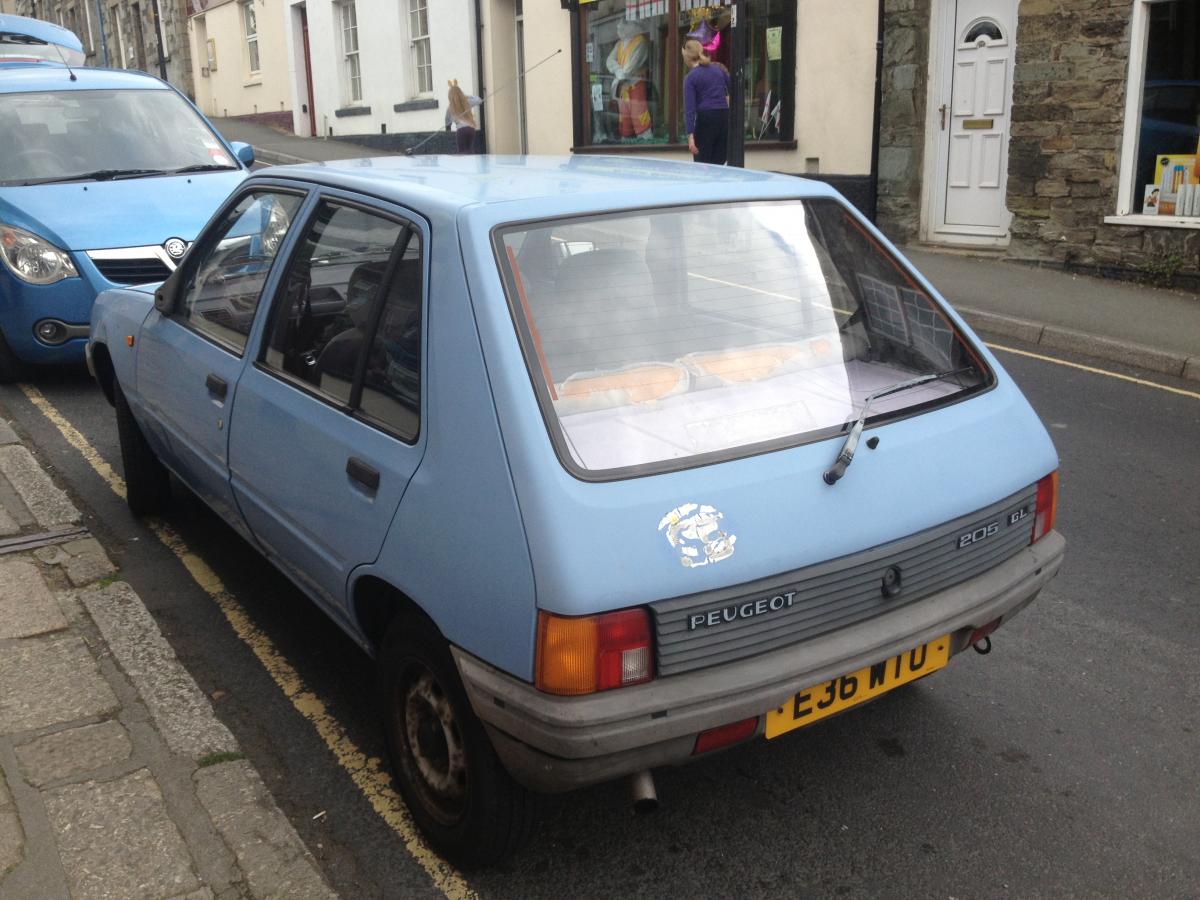

This weatherbeaten (matt) powder blue 205 first cropped up on here when corsaviour decided to do a bit of e bay bidding when bored and bagged it. Turns out it was a part ex disposal by a Peugoet dealer. In fact I think the supplying dealer. Showing no sentimentality for the old girl returning home they peeled out their disintegrating supplying dealer sticker from the back window and lobbed it on e bay. Registered august '87 its one of the last of the ealy 205s and shares its 1.1 douvrin 'suitcase' engine with a few other PSA cars like the 104, LNA, Visa etc
On the 280 mile return trip from Europcraft, I was suprised that it was so capable on the motorway, Its 4 speeds are geared up for cruising and at 80 it sounded quite happy, tracked arrow straight and is oddly far more at home there than the 504 estate. I expected it to be tapetty and smokey, with 135k on the clock but it used no noticable oil on the way back, and returned 40mpg too. The gearbox and engine share sump oil and it makes a pleasant distant whine when on the move, a bit like a metro. Its great fun to drive, the reasonably low geared steering taking some getting used to (quite a bit of wheel twirling- fun though) and its spindly budget 145 section tyres gripping well. It rolls a bit if you throw it into a bend but thats part of its charm.

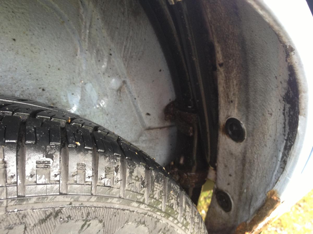

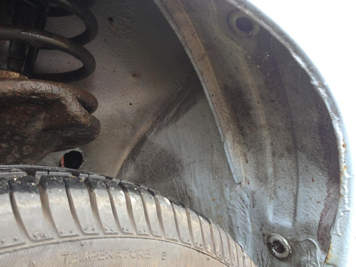

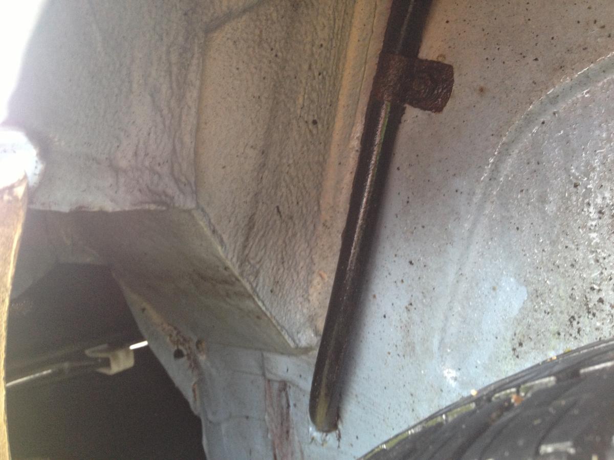

What amazes me most is that its 28 years old, by no means had a sheltered life, and yet barring a bit of grot on a rear wheelarch the shell is unbelievably solid, i've had mercs 10 years its junior with far more corrosion...

I had planned to T-Cut it but really did think it'd lose it's charm a bit really so was happy (lazy enough) to leave it as it is.

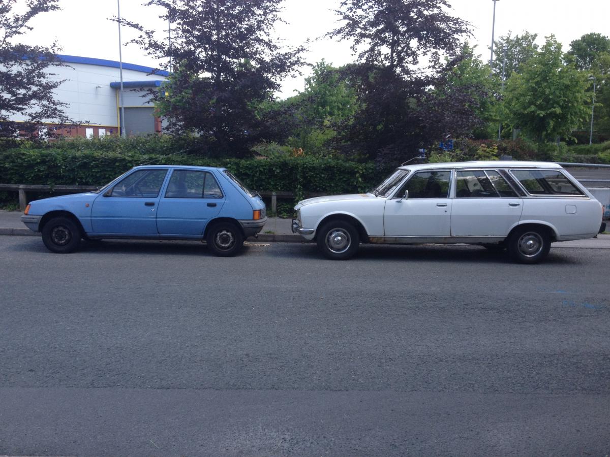

Utterly brill. Please let it be just long enough to get a pic of it and Alex's R5 together!
Please don't touch the paint. But by all means powder coat the wheels.
I would change the interior for a better one though if you can.
Looks great as is, although back seats have the 'sunshine on a nylon upholstery for many a day' rot.
I'd be tempted to remove the remnants of the GB sticker or whatever afflicted the rear hatch, and then with one bit shiny and the rest of the car still matt decide it looked a bit strange, so would probably end up going over the lot with a clay bar?
That's just how I remember 205's :D

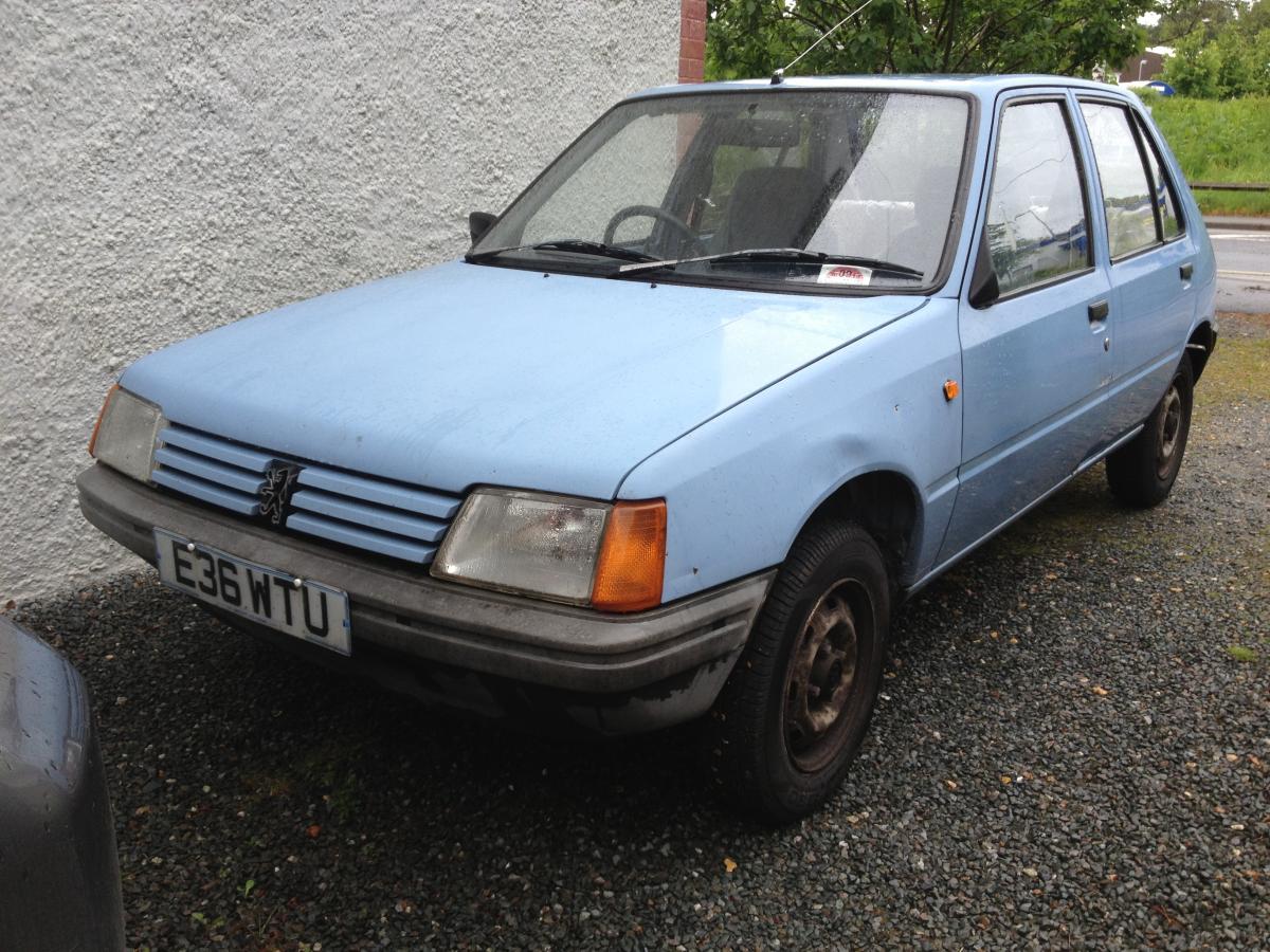

Is it missing the passenger door mirror, or is that misery spec? I nearly bought a 205 Gentry last year which drove great but the cacophony of trim rattles and mega heavy clutch put me off.
Definitely don't polish it.  It'll look all wrong if it's shiny.
205 Gentry models were all automatic.
Bugger, so it was, must have been the XS I also tried. Must have a 205 at some point though.
I'm pretty sure a passenger door mirror was required by E plate, my wife's Escort was on a C plate and it had one.
em
Our '90 Proton 1.3GLS didn't have one, and it was still only a cost option in the 1.3GL for the desirable '91 J-reg model year.
I reckon this one had one originally. It's a GL so would imagine it came with one anyhow, plus the hole where it would have come through the door was taped up I think!
All cars had to have a passenger mirror, rear seatbelts,and side indicator repeaters for the 86 year model year onwards.......Saying that the gl was positively luxurious compared to an early ge....with even skinnier wheels and tires...no headrests...even harder plastic steering wheel and definately no passenger mirror! Loved all the douvrin engined 205s we had in that period and all ran and ran with no problems at all. The only nasty rot that this era of 205 can present is rot at the back end of the roof adjacent to the tailgate hinge mounts. These early 205s have a certain old school french charm and if looked after can run on and on and on. Your example is fab!

Regards the lack of 'important' corrosion, I believe the main structural members on 205s and 309s were zinc-coated (not fully galvanised) - the surface rust on the important bits of my 309 remains "as is" even if left alone from winter to winter (it deserves better than me, it really does!!).
