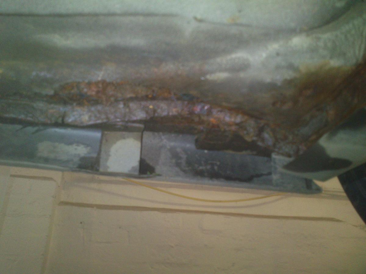

The Jaguar X-Type. These things rot like they are made out of recycled Ka's.

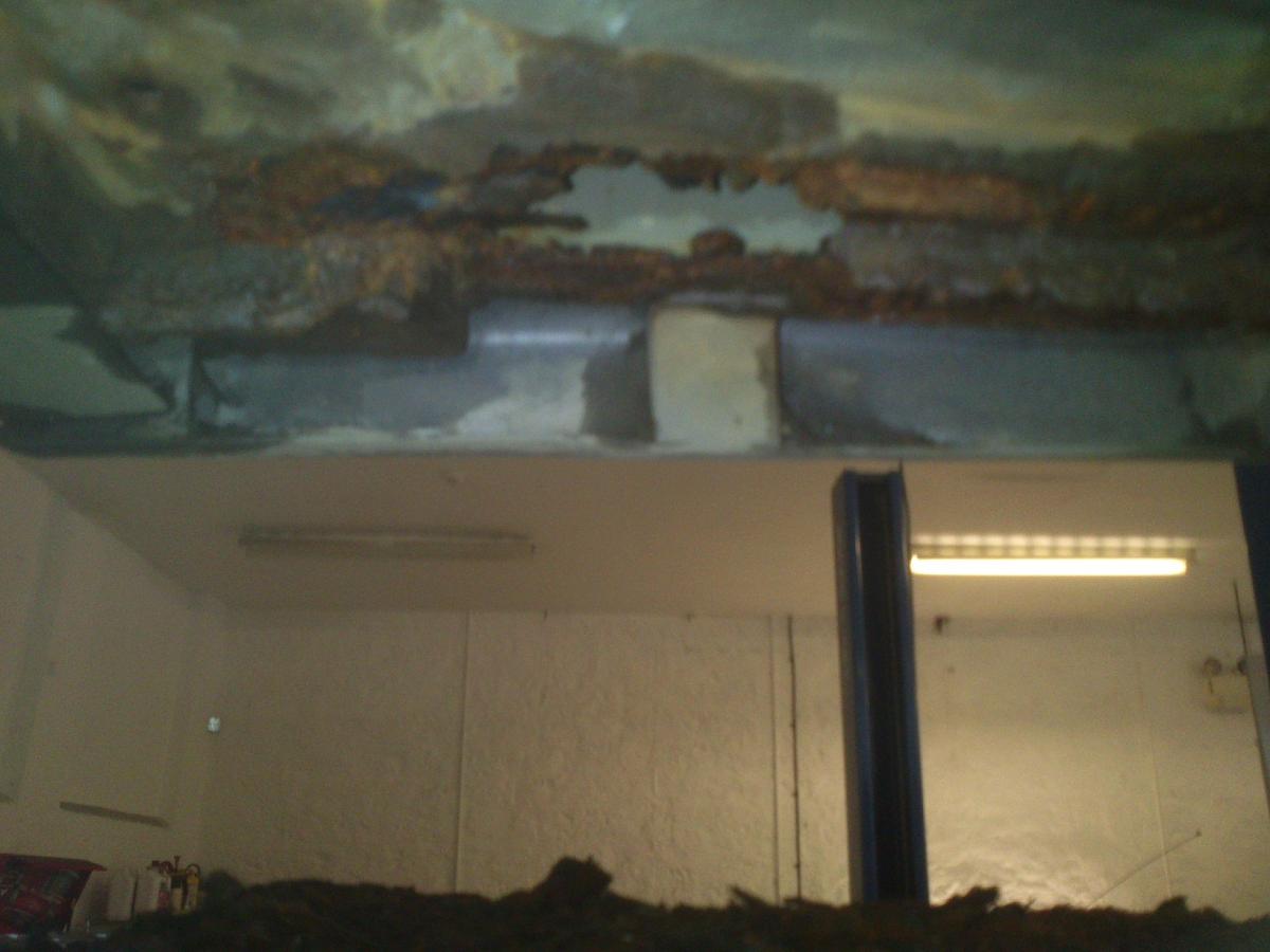

These are a few pics,of by far the worst I've seen of the 3 I've failed in the last couple of weeks for the same sort of thing, and this one had already had sills... 51 plate 3 litre 4wd, the fail sheet ran to 3 pages, and wasn't even a full test- had to be abandoned as it ran out of fuel on the ramp...

Flippin eck that Jaag is proper rotten.

We see a lot of Jaguars in for test, I've seen X type sill rot but not to the extent shown above.  The steel XJs like to rot close to the front suspension within the wheel housing, there's a lot of metal there so it's years before it becomes a fail.  I've had an S type with a cracked wheel and recently a couple of XFs where the brake hose has been fouling on something and those XKs do seem to be particular about which pipe you shove the emissions probe up, if you get the wrong one the lambda reading shows too high and thjose new shape XJs are heavy things to jack up.

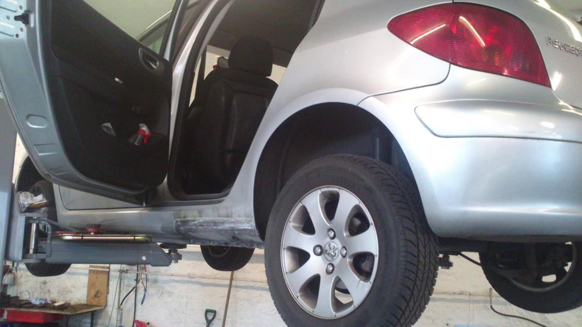

Surprised to have to have failed a 2003 307 today on sill rot- felt it weak under the thick sealer on the sills and was surprised how far it had gone once it was cleaned up. Renners are bad for this,as are Focus's . You can't see it, but a good squeeze with thumbs and it becomes clear... I much prefer gas welding to the horrible ordeal that is Mig. Use it wherever I can. The hole was the whole lenght of the patch..19.5 inches of ROT.

Your right about the focus being rotten under the sealer. Had one in last week with a small hole at the back of the sills . Ended up with a 2 ft patch and should have done the sills really
